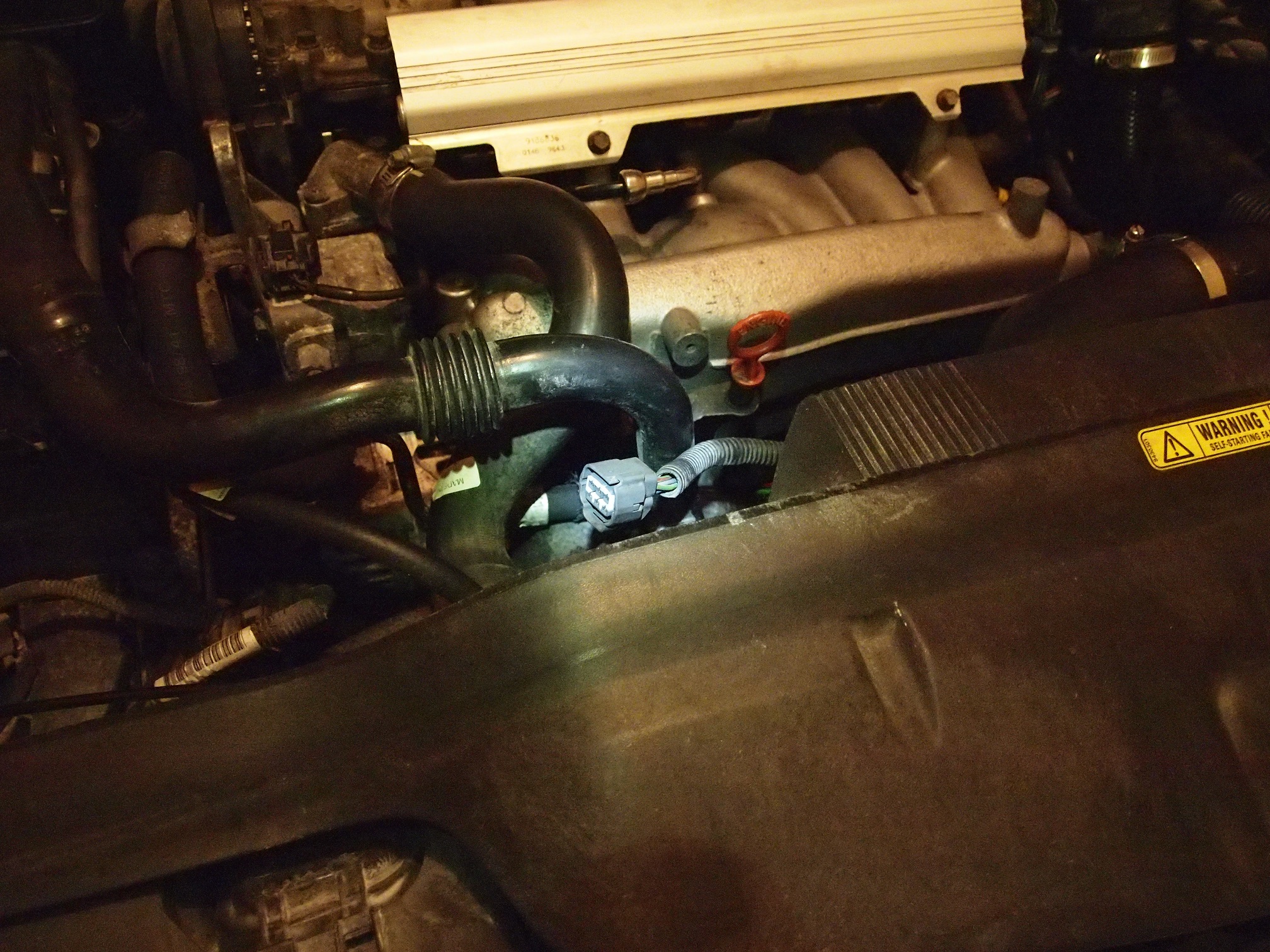

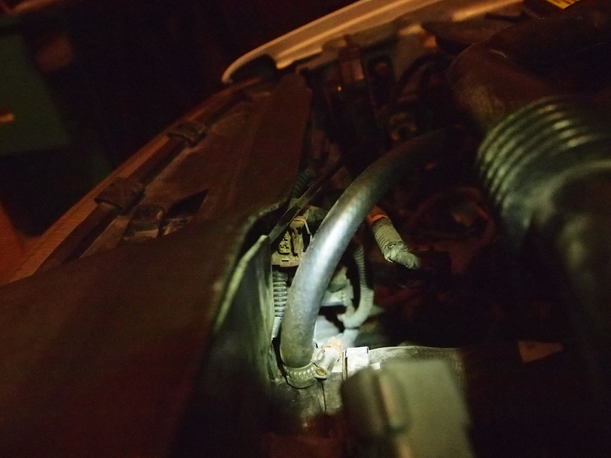

2. What are the connectors in the attached photo? Can't find the corresponding connectors so they're hanging loose. Both near the starboard headlight.
3. Popped the spark plugs and they're wet. I'm going to test compression tomorrow, since I have them out and the plugs are good. If compression is low then I'm probably "lawnmowering", but if it's fine, is the teaspoon of oil in the cylinder a waste of time? I'd rather not deal with the giant cloud of blue smoke.

There are relays under the lip of the radiator shroud. They should all have plugs.
I'll try take pix of my T5 in the morning but SWMBO has been stealing it for work lately
