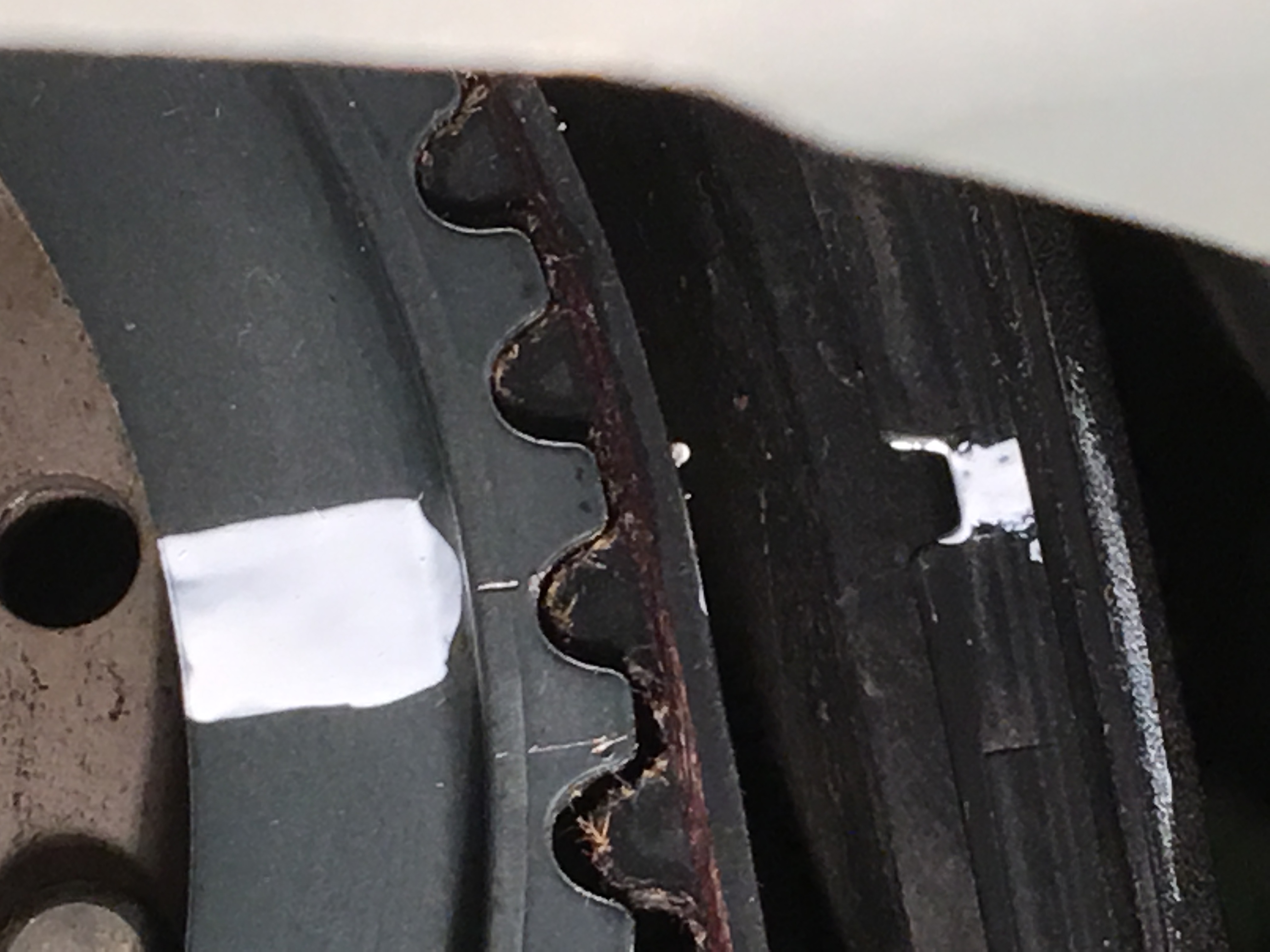

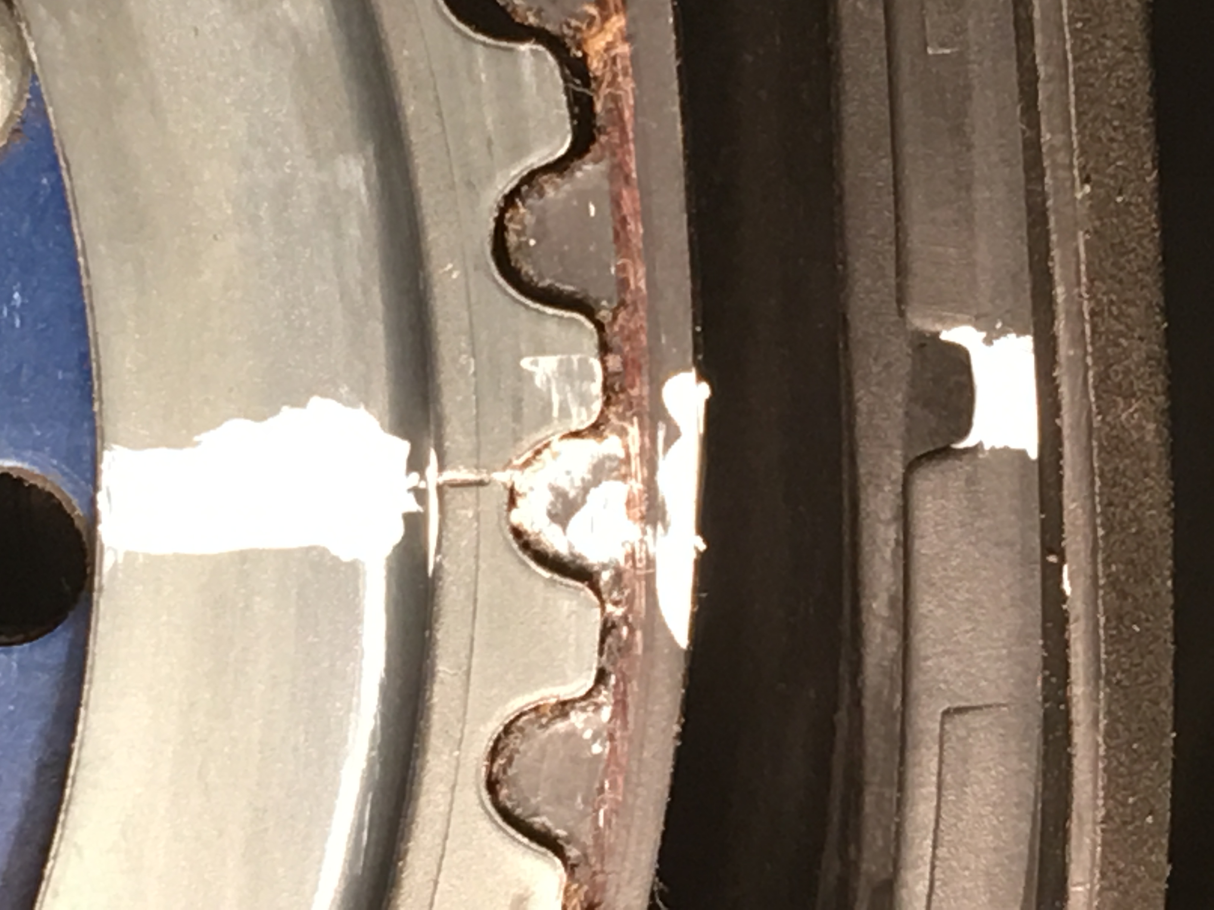

I put some white fingernail polish near the timing marks on the cams. Here's a photo of the exhaust side lined up with the notch on the top of the timing housing.
Here's a photo of the timing mark on the intake side lined up with the other notch.

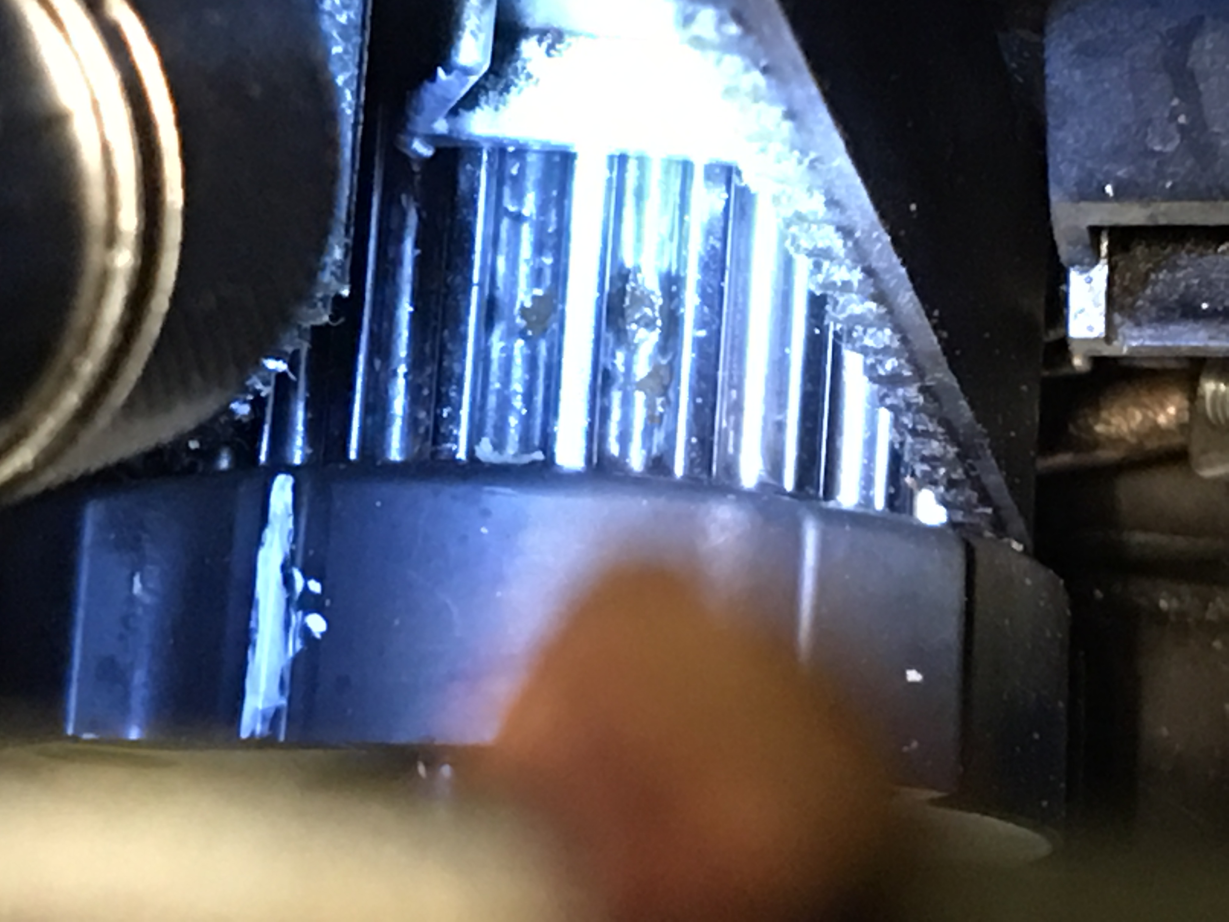

The photo below is of the camshaft timing marks. I painted the timing mark on the crankshaft pulley with white fingernail polish. The timing mark on the engine is the protruding portion of the casting at the right edge of the photo.
It looks to me like I'm off one notch. Am I off? Do I have a problem? If so, how do I fix it?
Here's my theory: it is unlikely that the timing belt jumped one notch. The car was running fine before the water pump started leaking. The timing marks are critical, but not precise. If I put it back together lined up the way it is now, it should run like it did before.
I just don't know whether my theory holds water any better than the water pump did!

Wichitas80, it seems to me that if you find your timing "off" a tooth, then this is your opportunity to correct it.
Always rotate your engine manually in a clockwise direction to check for interference before locking everything down & closing her up.
