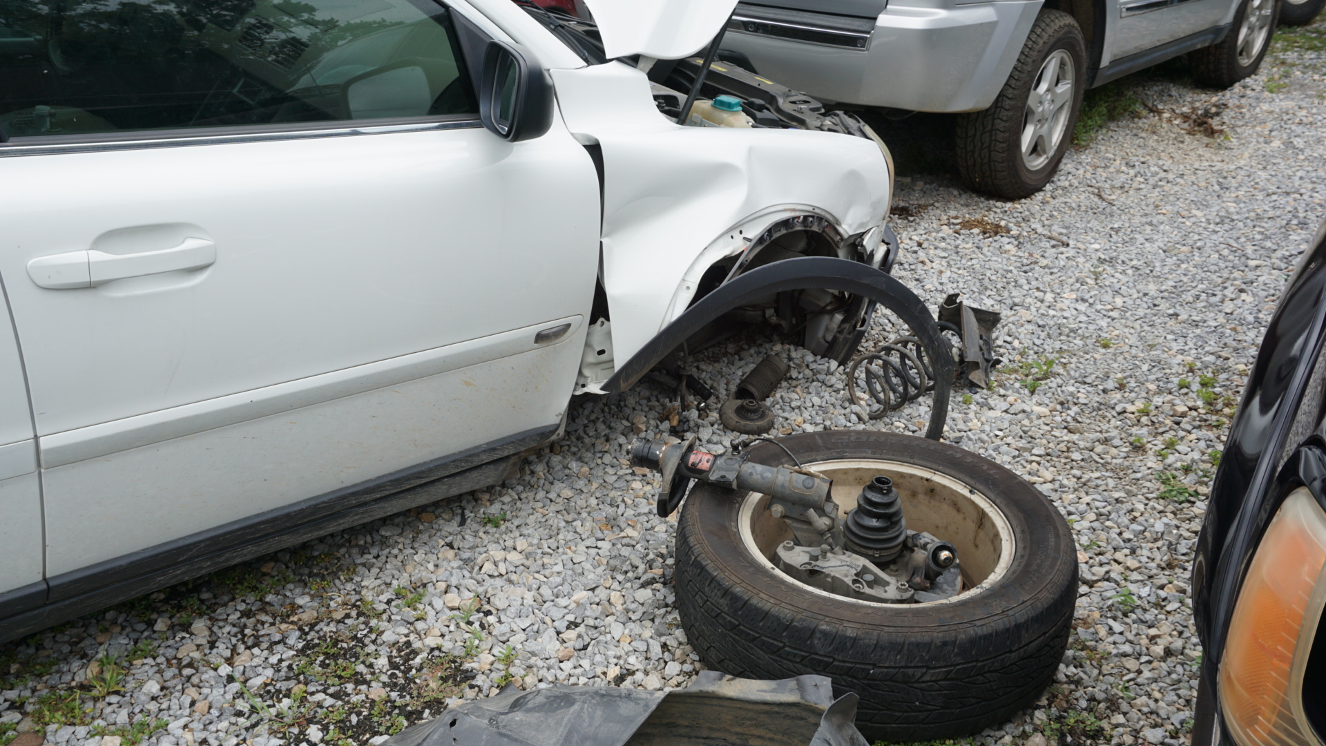

My daughter wrecked her 05 XC90 V8 back in July. Had full coverage and they totalled it out due to estimated $8900 repair bill. All this wreck did was damaged front right side of front clip and right side fender destroyed. Right wheel came off too along with everything attached to it. Half shaft pulled loose at joint, strut snapped at top mount and ball joint popped out along with ball in inner tie rod. Brake line and abs wire severed.
I was able to buy it back from insurance for $1200 after verifying no frame damage. I did all mechanical work on right side myself with used and new parts where needed. Spindle and drives haft used and wheel used. All other parts were new off Amazon or other online retailers. I had a body guy install fender and fix tweak in passenger door and repair bumper and paint for $450. Decent enough job. Today this is where I am with it.
