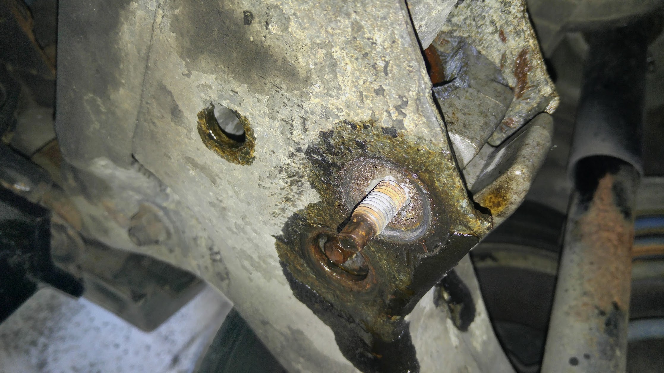

I just had the same problem. The fix was not easy, but I didn't get new bushings, I just removed the transverse arm mounting bolts. Three of the four were corroded in place, effectively "freezing" the bushings in place.

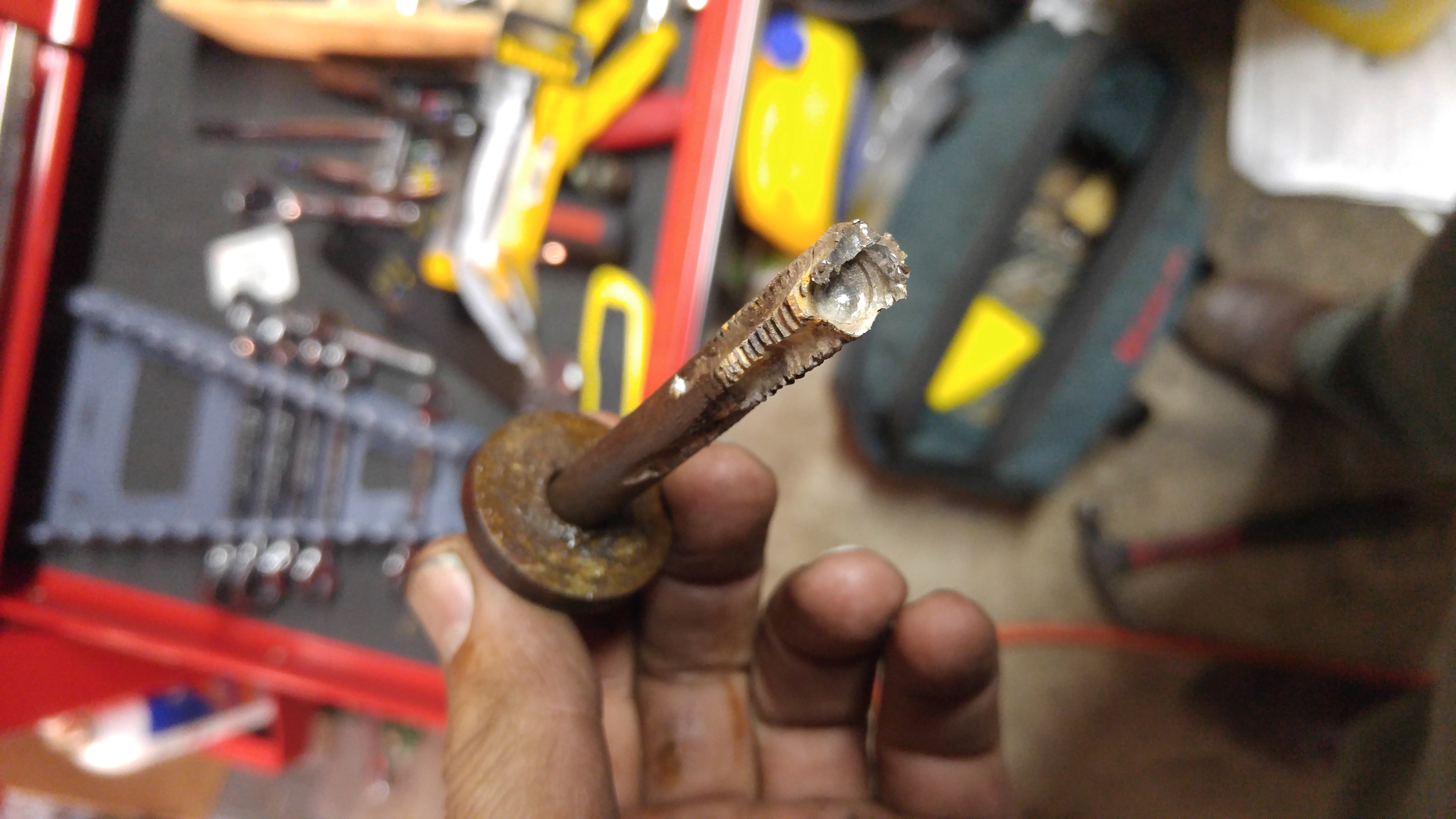

I used an air hammer to remove all but one of the bolts, the last one I had to drill out. None of it was easy. Once the bolts were out the bushings were able to move. My advice would be to do one at a time to keep the bushings in place so the alignment doesn't get too far out of whack.
Here is the bolt I drilled out. I used a small bit along four sides, then a bigger one into the shaft of the bolt so the air hammer punch would seat well. An air hammer is pretty cheap and kind of fun.

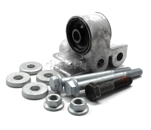

I got the transverse arm mounting bolts at FCP if that helps. Bolt is part #985358 and the corresponding nut is part #3546077.
