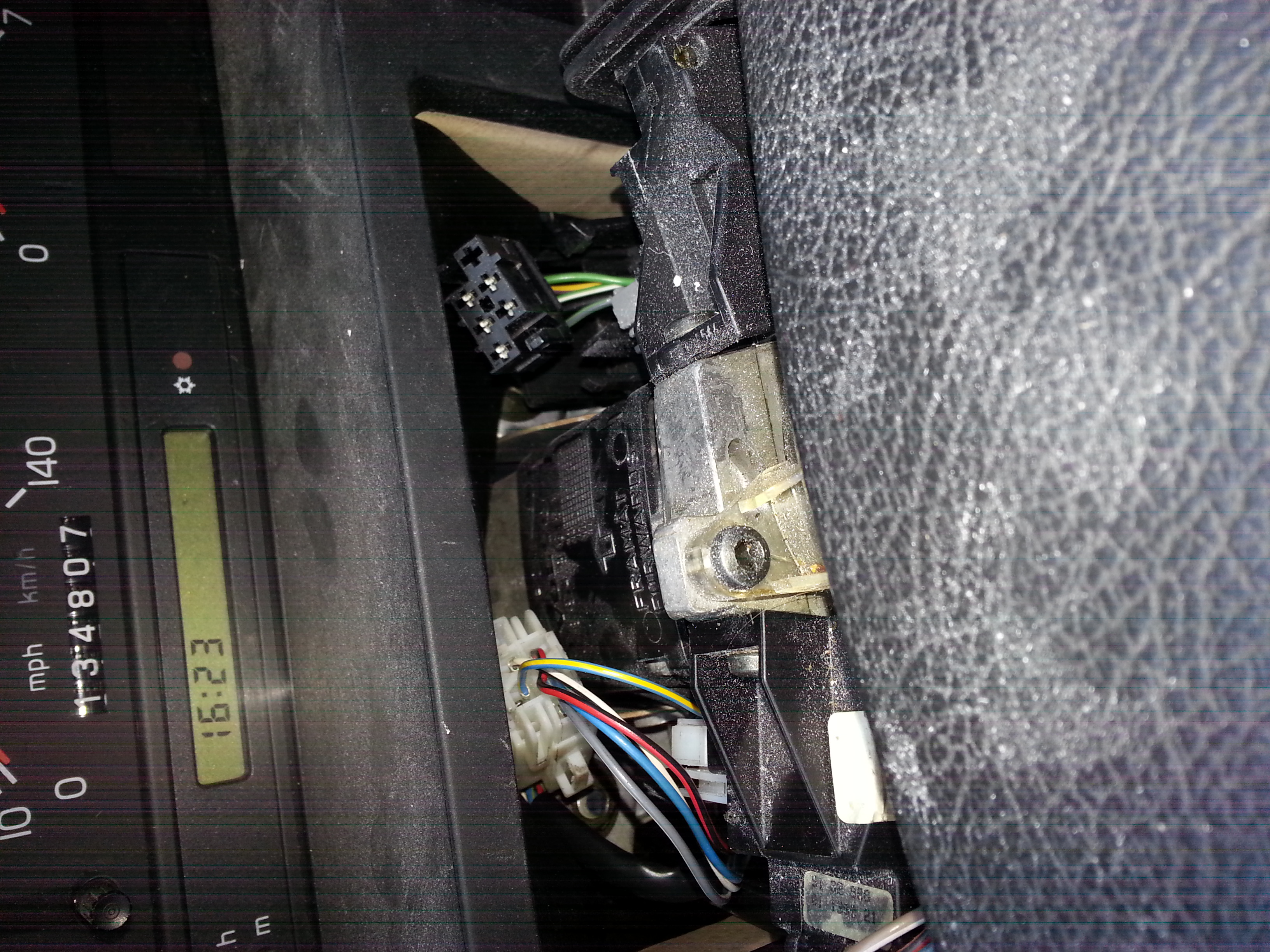

Post a pic of the black harness at the steering column.

zandershope_

- BEJinFbk
- Posts: 4070
- Joined: 05 Jan 2008, 22:32
- Year and Model: '98 V70 R
- Location: Fairbanks, Alaska
- Has thanked: 94 times
- Been thanked: 146 times
These cars are wired for most all accessories at the factory,
even if they don't ship with all the bells and whistles. That
connector looks a lot like one that would plug into a dash
switch for an accessory that you don't have.
I'm still thinkin' bad ground at the headlight and turn signal
grounding point or maybe some nasty leftovers from a poorly
installed/removed aftermarket system.
