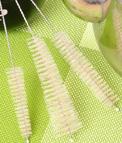

Maybe some oil sludge from the solenoids went into the pick-up pipe mesh at the bottom of the oil pan. If that's the case, looks like it needs an oil pan removal. I'm not sure if this works, but I will try on mine to clean the pick up mesh through the oil drain hole with a brush like this (not sure how safe it is, though)
- brush.jpg (52.67 KiB) Viewed 1142 times
