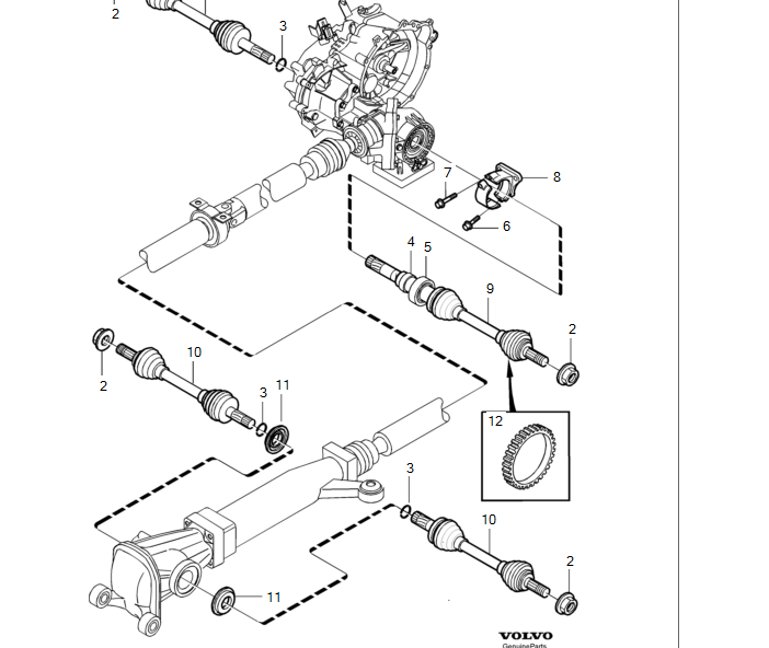

Clunking could be the torque tube mount pictured here or it also could be your carrier bearing tearing loose.
Mine was doing the thump/clunk and it was the carrier bearing rubber mount torn loose. Worth checking the torque tube mount before pulling the propshaft.

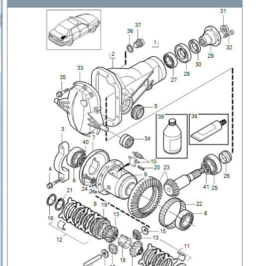

Here are some diagrams, looking up the removal procedure as well.

thank you kind sir, those are indeed the explosions i found as well. just downloaded a copy of VIDA, now all i need is a windows machine. :)
also a great pointer towards the torque tube mount. i'll have a close look at that.
