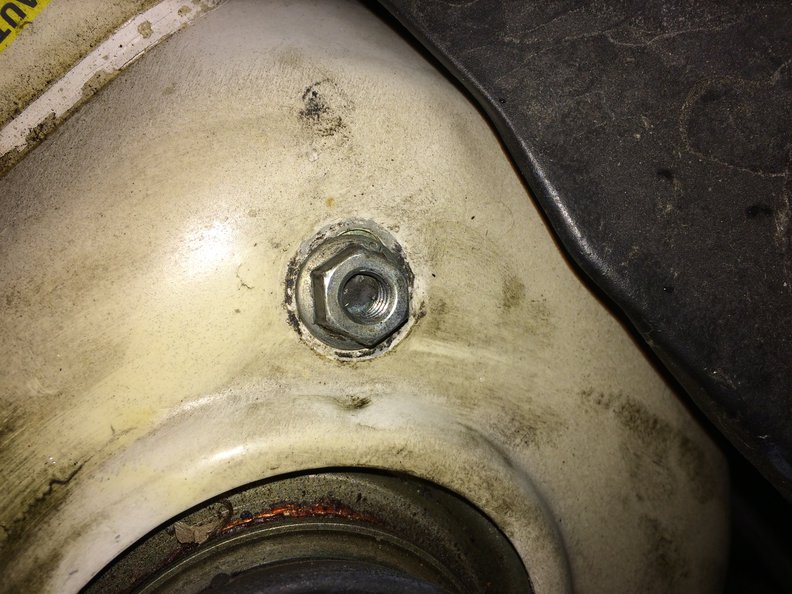

Hey. Yesterday I was replacing the driver side wheel hub/assembly and the passenger side cv axle. The work on the drivers side went smoothly, I was hoping to replace that CV axle as well but couldn't free it from the transmission. The driver side CV axle was in good condition so I wasn't too upset.

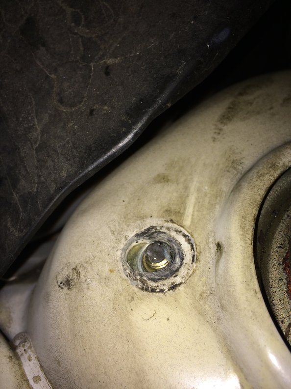

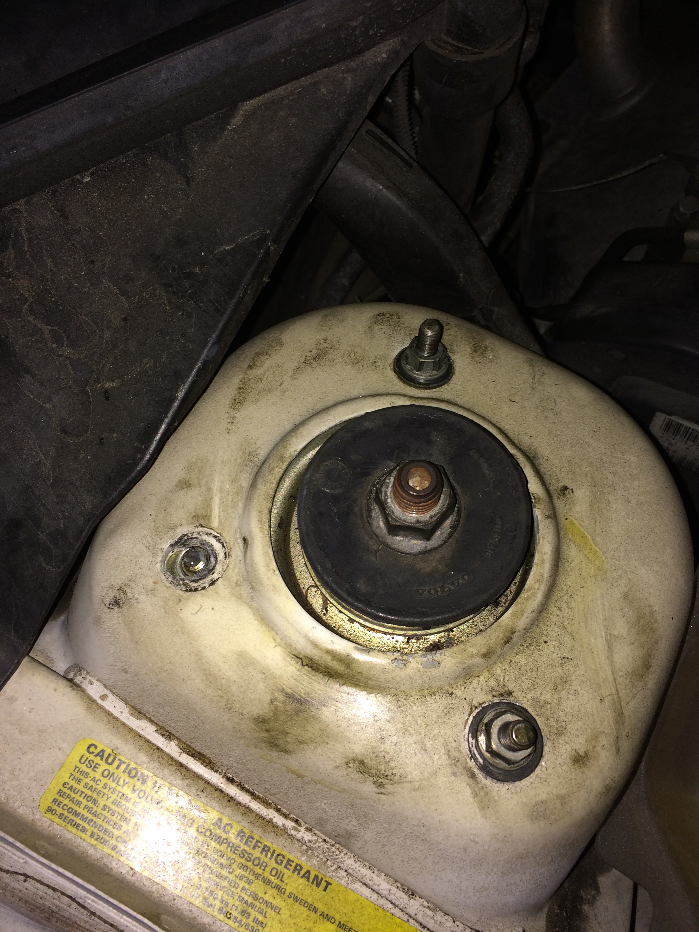

But the passenger side didn't go too great. I replaced the CV axle, lost 6 oz of fluid in the process, and got it back together. But I broke one of the three bolts for the strut mounting point when I was torquing it down (25 ft-lbs). I was able to get the nut back on, but as you can see its only grabbing two or three threads.
How big of an issue is this? I was hoping to be able to make it home for Thanksgiving (5 hr drive) and don't have a ton of time to work on this before then. It didn't seem too bad to replace that bearing/mount, I'll just have to get a spring compressor from HF & work in the dark. Any tips when replacing the mount? Should I replace the spring seat as well? If I do do this before thanksgiving I'll have to go with generic napa/autozone parts and won't be able to order from FCP. Would that be an issue as well? Thanks for the input.

On some of the bearing plates those bolts are studs that are pressing in to the plate. You can remove and replace the stud without having to tear apart strut assembly.

With only 2 nuts keeping the Spring Seat in place, it is probably safe to drive at speed below 60mph.
Options:
a. Ghetto repair until you have time to do the proper job: drill the remaining stud out and use standard nuts and bolts to hold the Spring Seat in place.
b. Do the proper job: overhaul the suspension (new Strut...I use Bilstein TC, Spring Seat etc. etc.).
I wrote a suspension overhaul a while back in forum, you can search for it.

Yea I figured it would be safe at low speeds. I don't have the tools to drill out the stud (no drill) but I'll look to see if I can press it out at all.
I saw your writeup actually, it was good and thorough.

The load of the car is taken by the strut tower, not those bolts. They just locate the strut and keep it in the right place. safe to drive, paying attention to the other nuts and hardware.
Replace all of the front suspension parts if you want to drive the car for a long time
