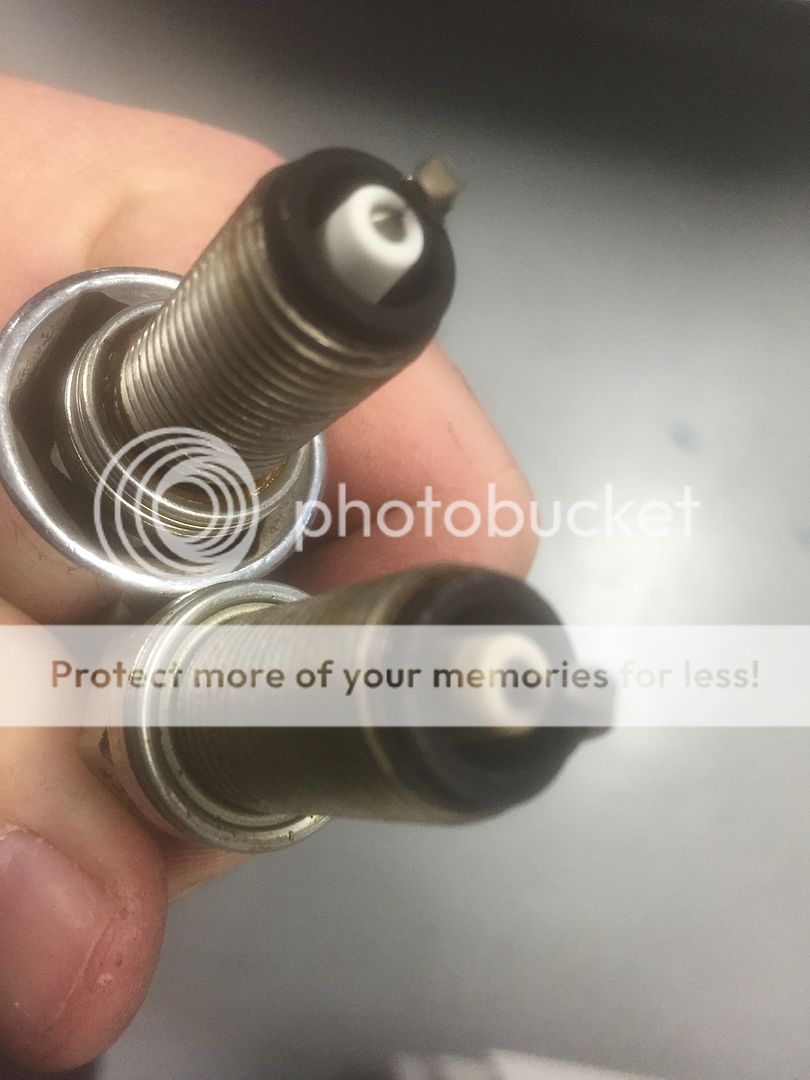

I have a personal type scanner with Volvo software. After checking the code I had hoped that perhaps this issue was due to the car needing a tune-up. When we bought the car, it had the 50k miles service, but my wife didn't know if there was ever a tune-up done, so I changed the spark plugs and air filter. When I pulled all the plugs, the first five looked good, but the #6 plug had buildup and looked like it may have been running rich or misfiring.
These are the plugs I pulled out, unknown miles. The top plug is the #6 plug and is gunked up, the rest of the plugs were nice like the bottom one.

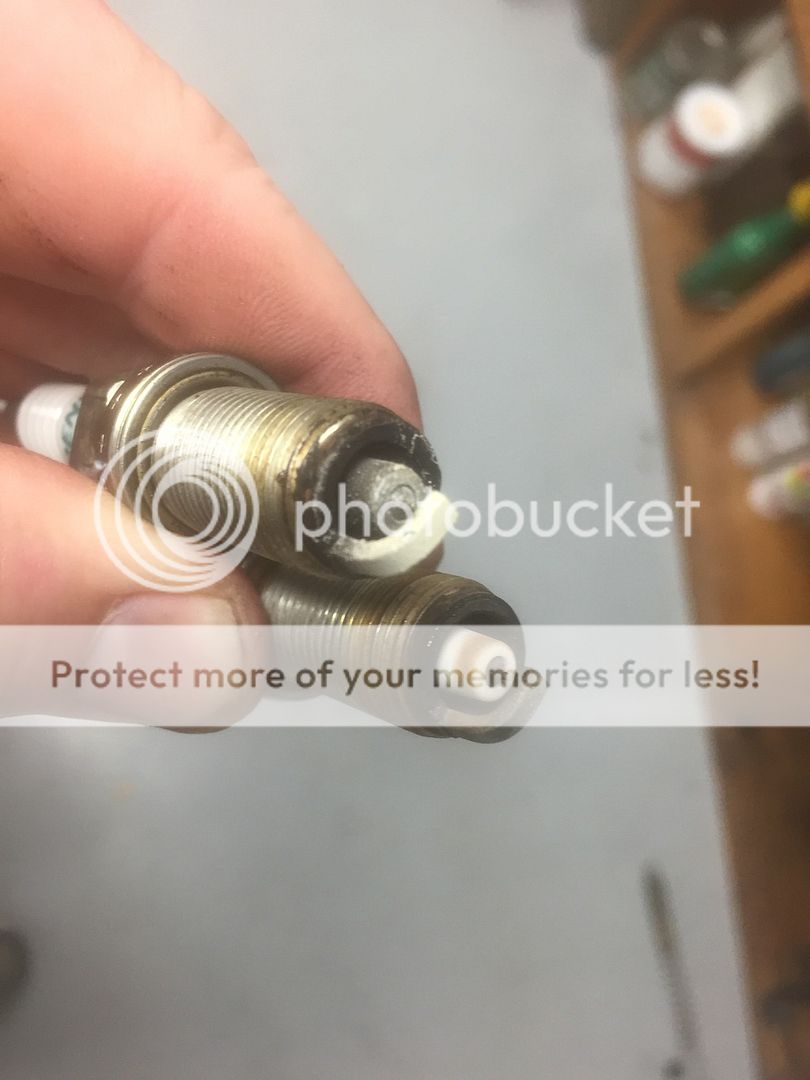

After I did the tune up, I reset the CEL, put seafoam in the gas tank and topped off the tank with 91 gas. After about a tank of gas later, the CEL came back on with the same code. To see if there was still a problem with the #6 cylinder, I pulled the sparkplugs from #5 and #6 cylinders. The #5 sparkplug looked good and the #6 plug already looked dirty and also was a bit wet with fuel.
Here is a picture with the #6 plug on the bottom this time.
