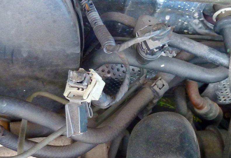

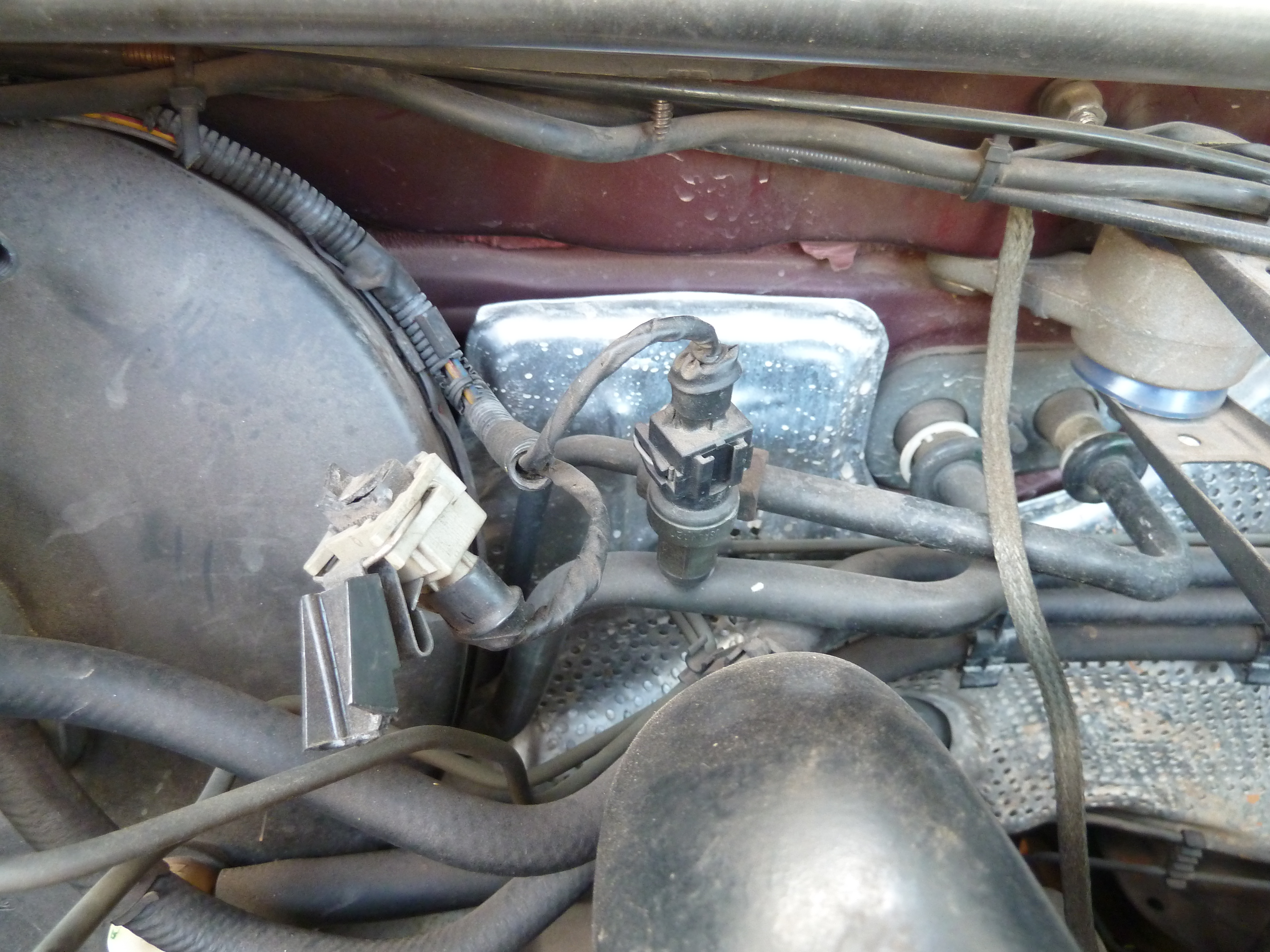

Its the one just above the air con pipes waving in the wind, I can see no obvious point of breakaway in the area, any ideas anyone. I was wandering if it could be a reason for my brake problems, they will just suddenly go flat with no pressure at all, I had to use my hand brake a couple of times to actually stop!

1994 850 T5 a damaged connector under hood, what is it off

On mine, a '94T5 that connector doesn't connect to anything but is located to the right of the master in between the VIN window and the screw holding doen the wiper/plenum plastic cover INSIDE the engine bay just near the metal lip that runs across.

I suspect that you're looking at the unused horn connector
the OEM security system that's not installed in that car.

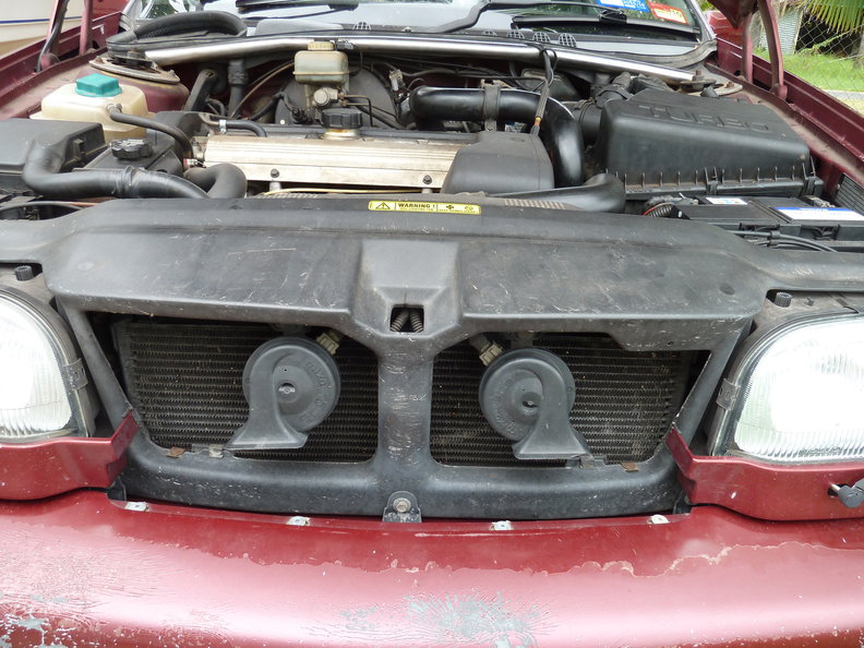

I was thinking the same thing as BEJinFBK but the right hand drive picture has me a bit confused. Is there a circular horn mounted on the firewall near the center of the engine?

Thanks guys, I think you could have it Lee & BejinFbk, it turns out there was no fitted alarm when imported into Aus and the original owner did fit an am sytem which was a waste of time and I have since removed it and the horns are on the front Lee. So, I think I can safely assume this has nothing to do with my brake problem ?

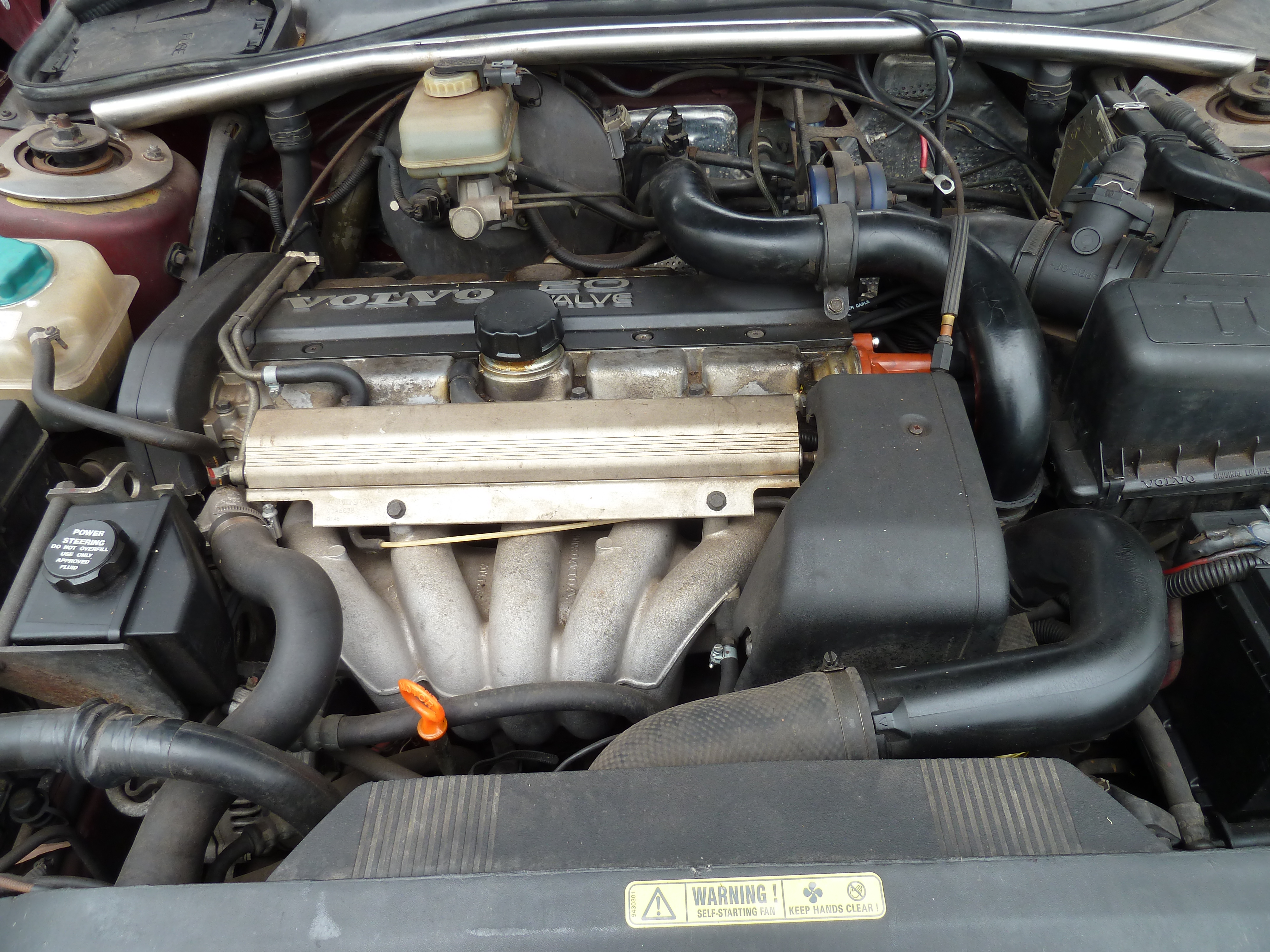

I have added a couple photo's of the engine bay layout which might help someone spot something that don't look quite right (the black & red leads hanging just to the right of the top engine mount are dead and are just connected to run the winch when I take out the boat)
