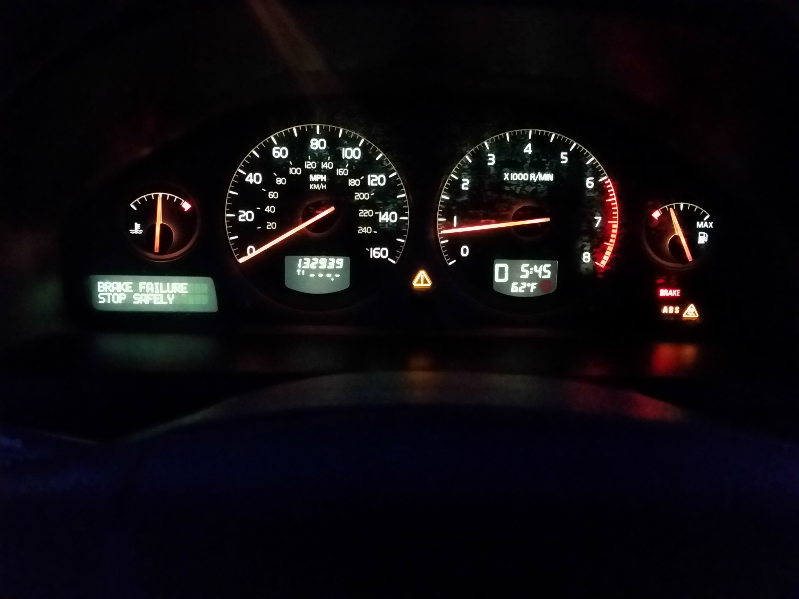

I took to mechanic and he changed the sensor maf for the turbo as i had a check engine light. Now i take it and he warned me about abs and that lights may light up in the future. picture attached hopefully people can see on here. Questions is how do i replace the abs sensor, as well as he mentioned the speedsensor is needed according to his computer diagnostic.

Whenever jump starting or disconnecting/reconnecting the battery, have the ignition key in position II (headlights on). This helps prevent any power surge that can cause issues.
When did the brake/ABS show up? Is it related with the battery going flat? To reset everything, you can disconnect the + terminal for 12h.
While the ABS sensors do go bad, the first thing to check is the ABS reluctor rings on the axles, they get rusty or even crack.

Had someone replace fuel sensor, now ABS module needs to be changed/fixed since its now throwing or been throwing out abs lights on dash, i have a code reader and can erase codes but they come back after about 30miles of driving. Anyone know of some guys who can repair these? heard buying another one would require a hefty price on flashing or reprogram. Thanks!
