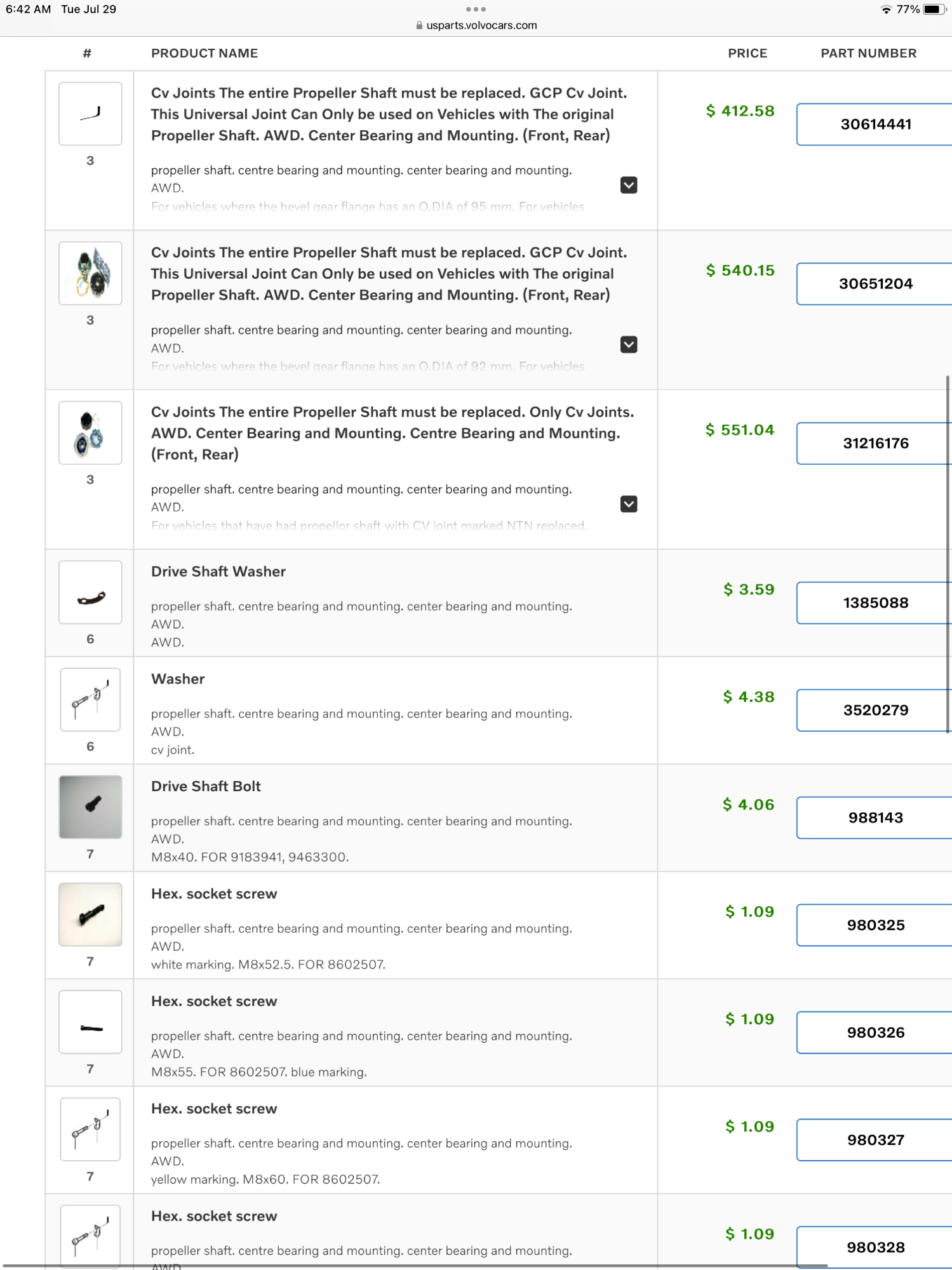

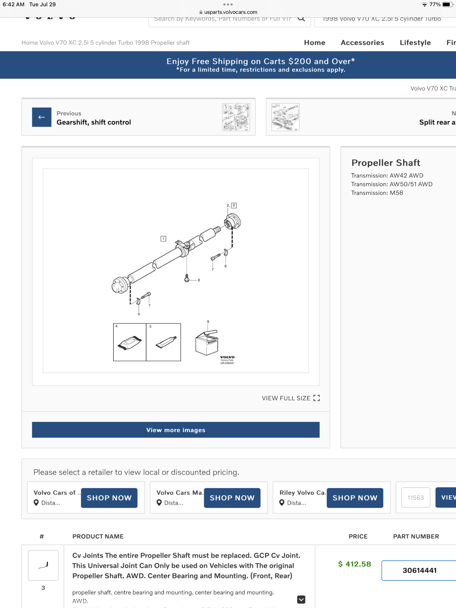

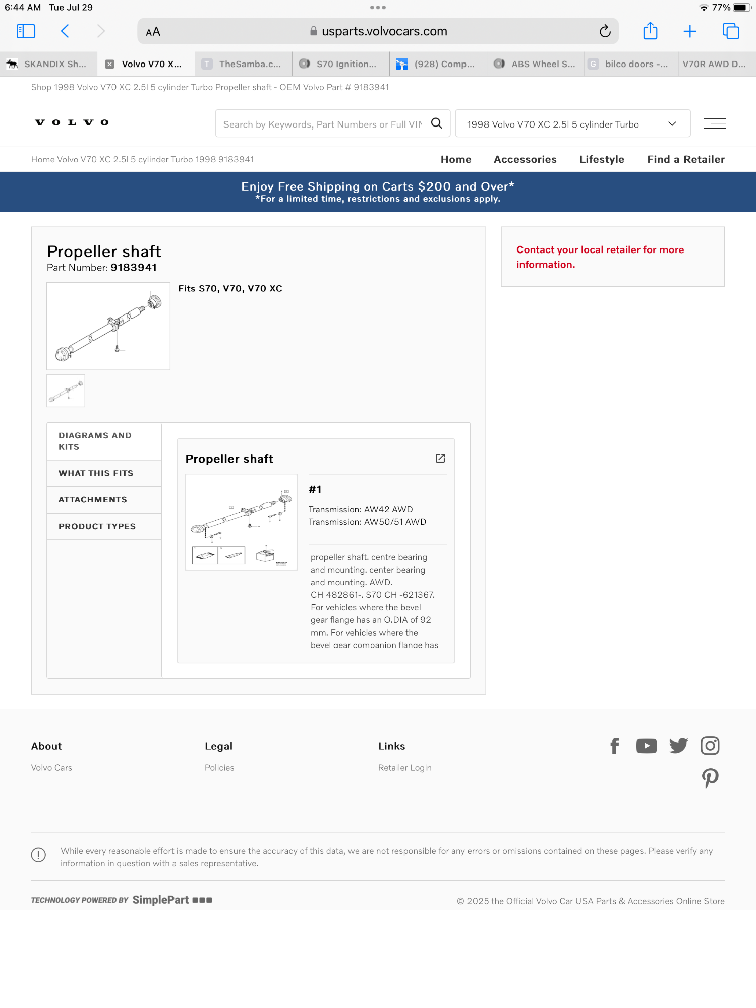

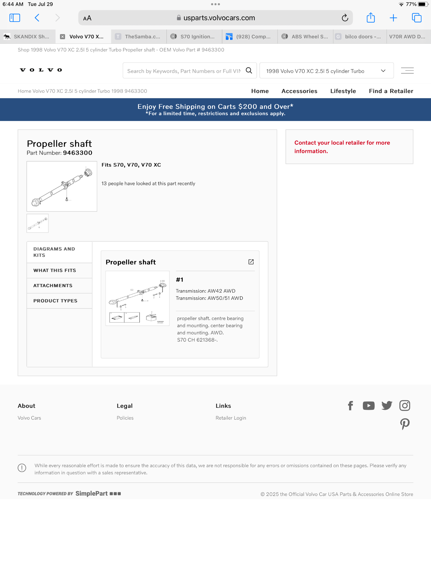

Here are the three versions of propeller shafts for the awd p80s
