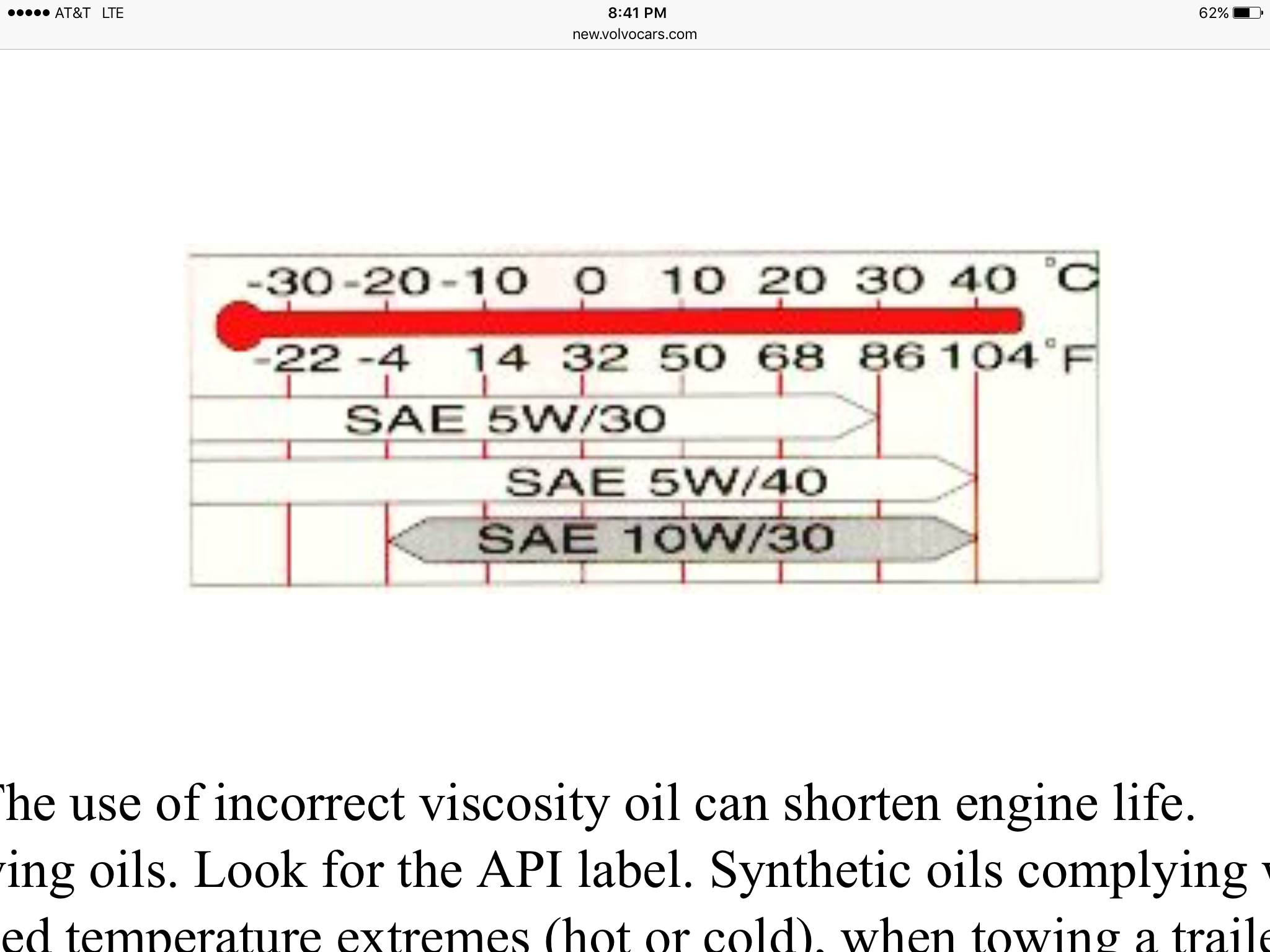

- Posts: 36145
You can see from the chart that 5W-30 oil is recommended up to 86 F ambient. Most parts of California you will be seeing that in the next three months. That 5W-20 oil will be thin at high temperatures. If you drive at 60 on the 405 every day, change it before the warm weather. Recommended interval for your car is 5000 miles, so you will be looking at another change in a few months. You don't have to run out and change that oil tomorrow but scratch Midas and jiffylube off your list.
With synthetic you can go to 7500 miles for changes, which pays the delta as well is less hassle.
