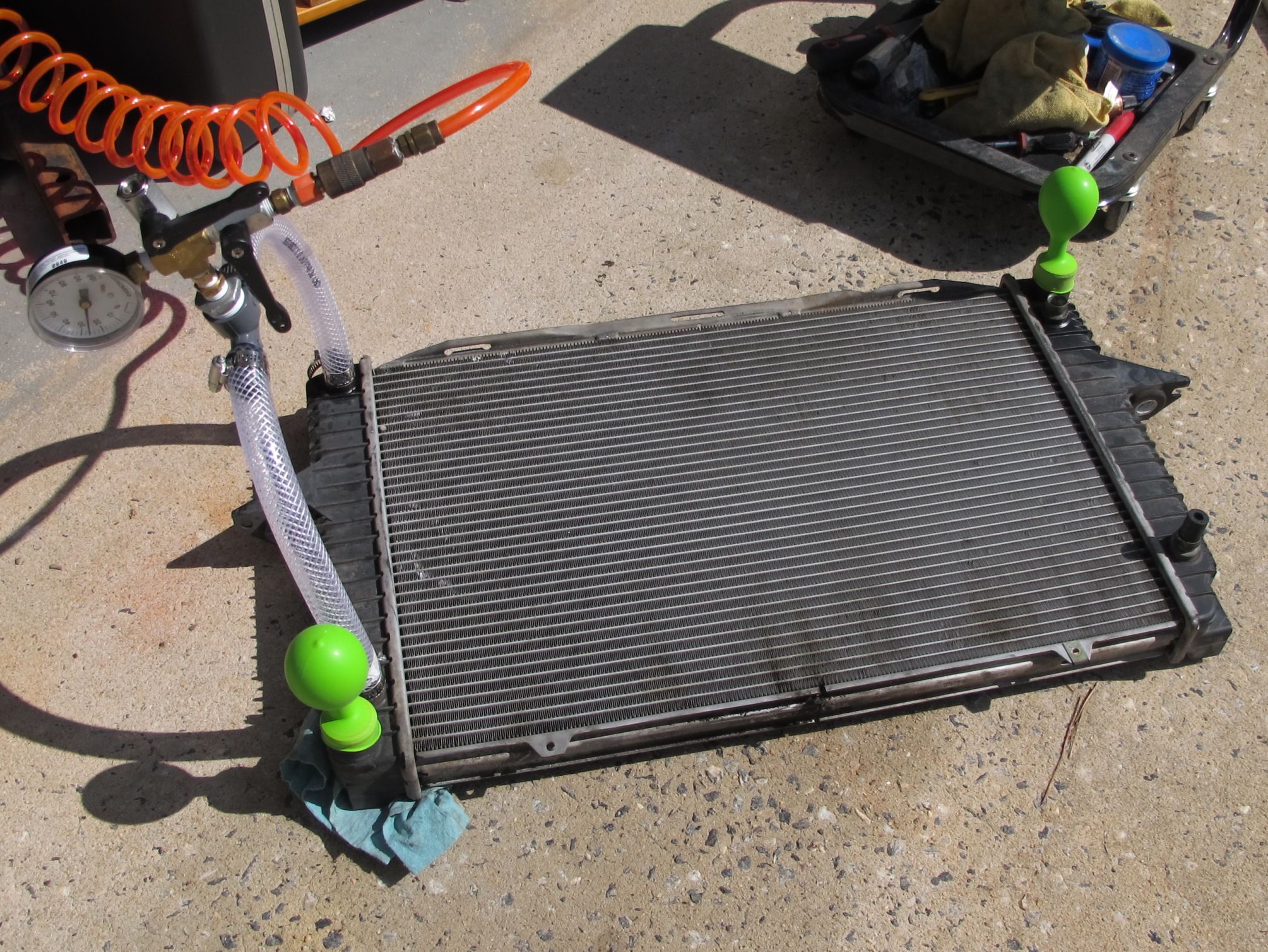

OK, so got a decent pressure leak test done on the radiator this morning and after some time have been able to confirm there is a leak, albeit a pretty small one, between the engine oil cooler and the coolant section. I rigged up the test as shown in pic below. Repeated it three times and let it sit once with no pressure just to make sure it wasn't the heat of the mid-day sun heating the air inside the radiator causing a false positive. (Mid March and 80 degrees in NC, a year or two ago and this could have been snow) Took 10-15 minutes to get enough air passed through to get the balloons to stand erect. That was starting with about 50 psi air pressure.

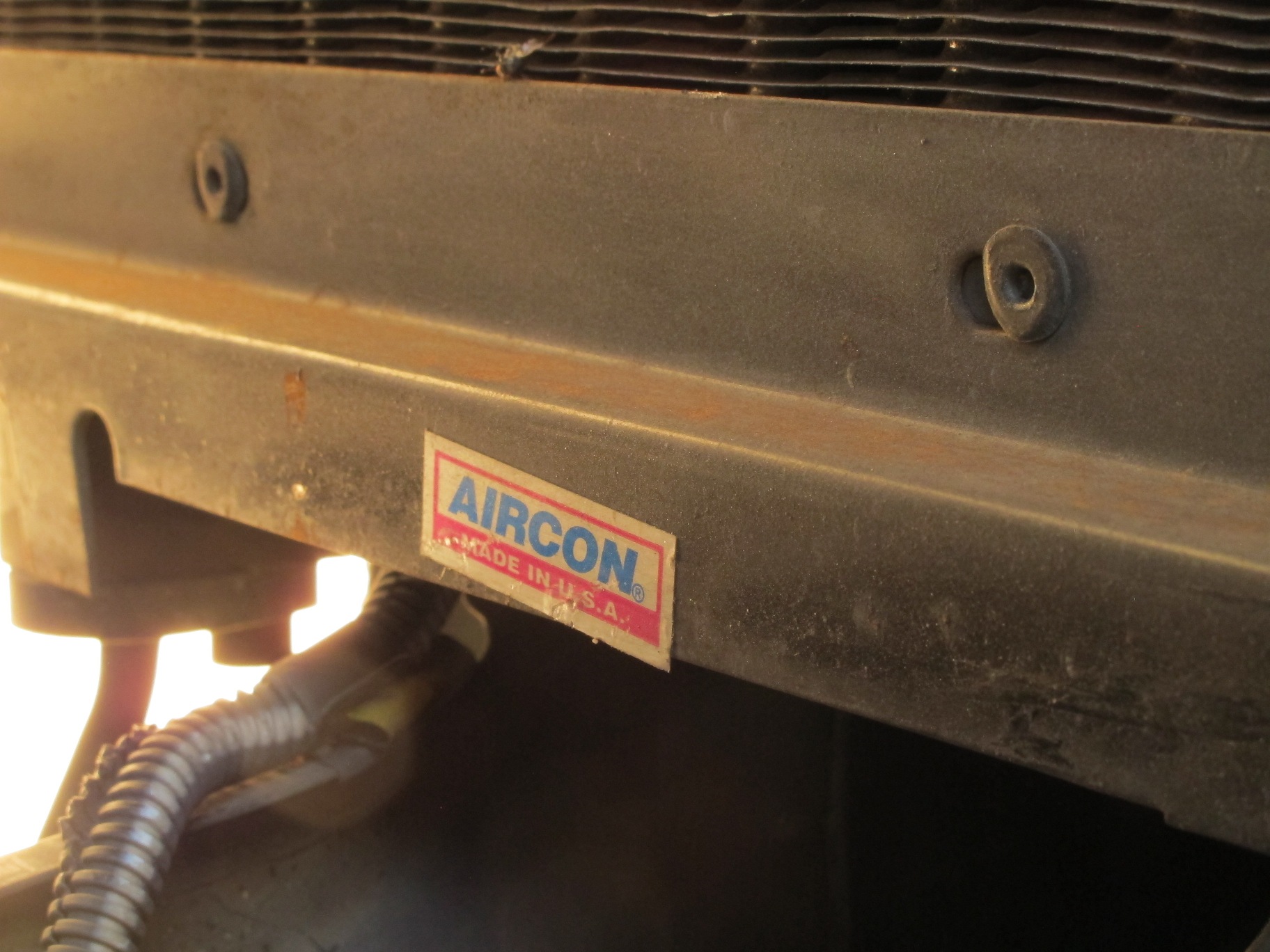

So time for a new radiator. At least that makes me feel better about spending the money as now it is definitive. Found something a bit odd once radiator was out. This was on A/C coil.
Surely Volvo didn't source this from a US supplier.

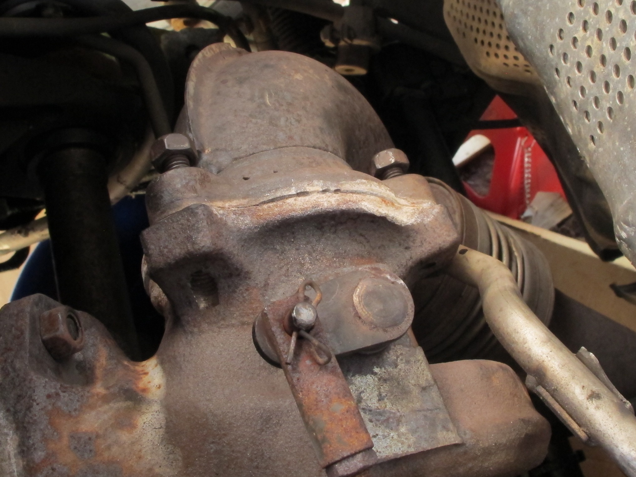

Last thing I am trying to get apart is the down pipe from the turbo. There is a white like stain all around the joint and with all three nuts off, it seems almost like the parts are welded together. No place for a pry point to separate them though the down pipe flange shows just a little edge where I am going to try and take a chisel to it (not my favorite option but not sure what else to do)

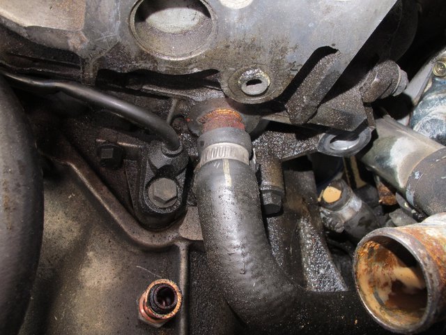

Have decided I will not change heater hoses though will disconnect them from the coolant pipe and the block to flush the heater core out independently a bit. Also, the fitting from the one heater hose to the block is rusted all up and I want to change that. Am considering also taking that big coolant pipe all the way off and cleaning it good but undecided right now. Not wanting to create a leak where there isn't one. There is rust inside and out on it though and don't want to think I'm going through all this just to have to do it again if that pipe starts to leak.
