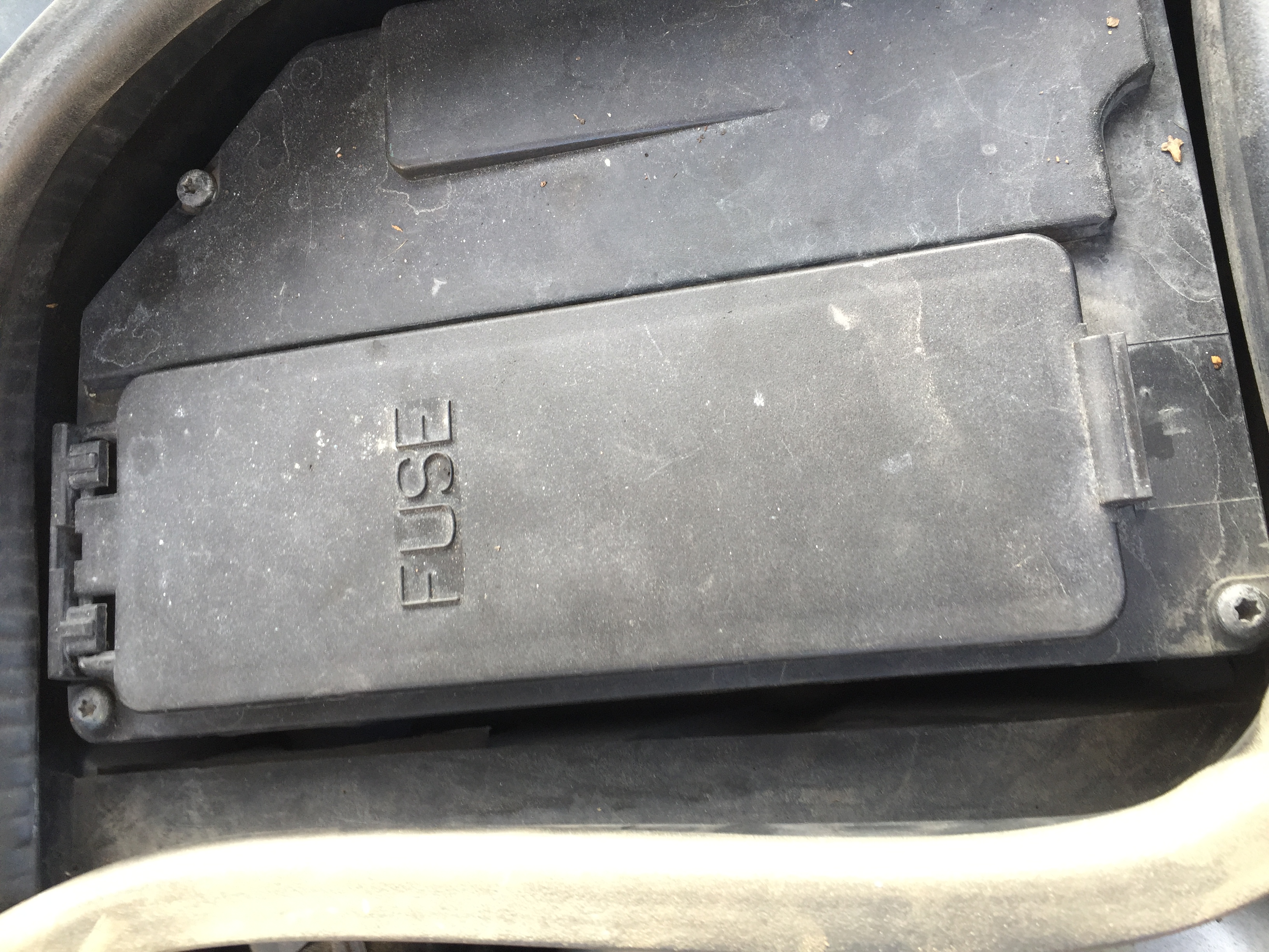

Just had a chance to get out there and look at it. So the wires are definitely bougicord and don't look that old but who knows...I'll probably replace those along with the plugs in the coming months just in case.theWIFES_S70 wrote:Hey Bren, what'd you find? Did you find any moisture around the fuses or relays? Plugs, wires?Bren wrote:When it rains the car feels like it's running on fewer cylinders and under load wants to die. Also, the Lambda light starts flashing and then stays on when this happens. After it runs for a while it then smoothes out and no more issues.
Thoughts?
I've just tried spraying the cool and dist cap with some silicone spray - not sure yet if that had helped.
But I poked around the wiper tray and fuse box area, and it definitely looked like the one drain right in front of the fuse box on the engine side of the firewall was nice and plugged up! Plus, check out the fuse box door in the pic below...no clip so it really doesn't seal shut...between these two things I'm pretty sure that's what was doing it. Thoughts on what I should do to secure the fuse box door down?

Bren, if you look closely, the Bougicord wires have a date of manufacture stamped on them. I'd say anything under 5 years old would be alright. They're pretty solid.Bren wrote:Just had a chance to get out there and look at it. So the wires are definitely bougicord and don't look that old but who knows...I'll probably replace those along with the plugs in the coming months just in case.theWIFES_S70 wrote:Hey Bren, what'd you find? Did you find any moisture around the fuses or relays? Plugs, wires?Bren wrote:When it rains the car feels like it's running on fewer cylinders and under load wants to die. Also, the Lambda light starts flashing and then stays on when this happens. After it runs for a while it then smoothes out and no more issues.
Thoughts?
Make sure you open up the clamps holding down they drain pipes and clean them out. Mine were almost solidly full of pine needs, leaves, and small branches.
If I were you, I'd tape fuse box down with some Gorilla tape. It's not something you have to open up frequently. Though, I'm sure you could get a new used PnP part.
