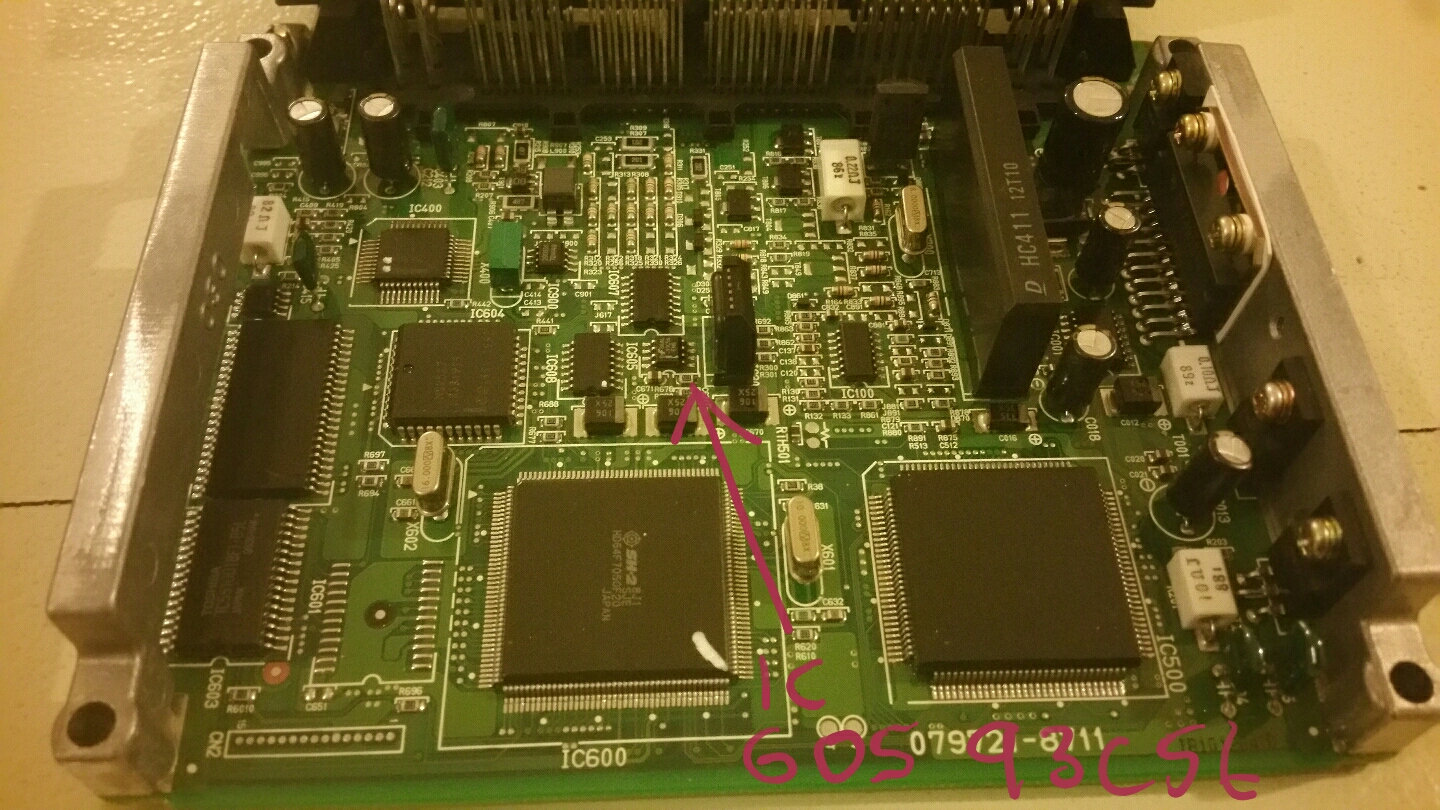

Once I crack open the casing and identify the eprom chip I can begin to appreciate the effort involved. The success mostly depends on the type of de-soldering/soldering required.

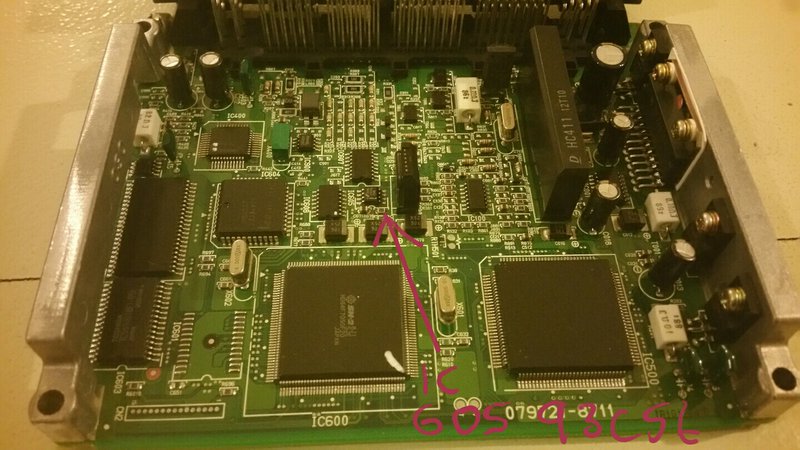

Ok so the eprom chip for immobiliser has been identified and we can now move forward with the proposal of a ECM swap to the manual ECM. It's an 8 pin IC 93C56.
Only problem is that ETM firmware currently on the car may be a later or different version to that which matches the manual engine ECU however we'll need to deal with that once the manual ECM arrives.
I strongly recommend purchasing the Vida disc or downloading it so you can make a full comparison of parts required for the manual swap.
