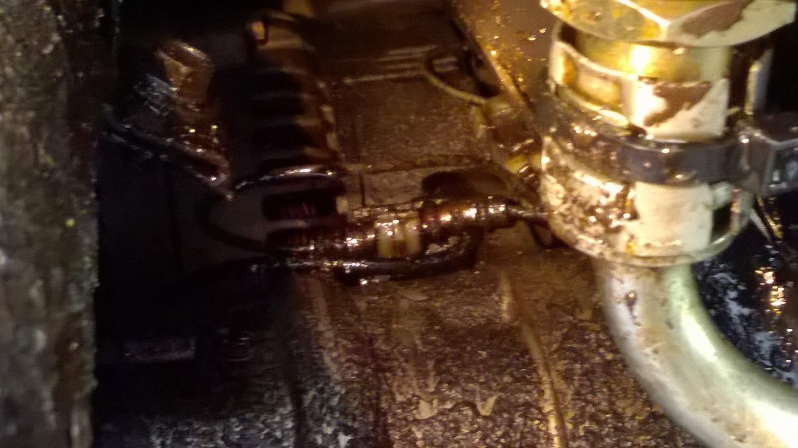

I have taken some pictures of the outside, bay, and some close ups of oil leaks from top and bottom angles I guess will serve as "before" pictures. Let me know what you guys think. Thanks for reading! I anticipate constructive feedback :)

As you mentioned the radiator is leaking so that should be replaced soon. If you're up for it you can save quite a bit of money doing this yourself. If the heater core isn't leaking then you can leave it alone for now unless you have the extra cash to replace it. The ebay Estonia heater core comes highly recommended.
I'm not sure what you mean about the AC. The AC is actually separate from the radiator so one has no bearing on the other.

The PCV is much easier than the timing belt in my opinion. So if you feel ready to do the timing belt you're ready to do the PCV.
For torx drivers just get a large set from like a T10 all the way up to a T45.
Recommended parts vendors include the sponsors at the top of the page as well as FCP Euro, tasca, and viva performance. For used parts you can also use Erie Vo-Vo, and volvosalvage.com
For each of the items you asked about: timing belt, PCV, end links, motor mounts, etc there are write ups which review which manufacturers are recommended and which ones to avoid. Take some time and read through these write ups. You will learn a lot that way. The heater core I already mentioned that the ebay Swedish Car Parts unit is highly recommended. Its cheap and comes with a lifetime warranty. Just be sure to use OEM O-rings from the dealer.
