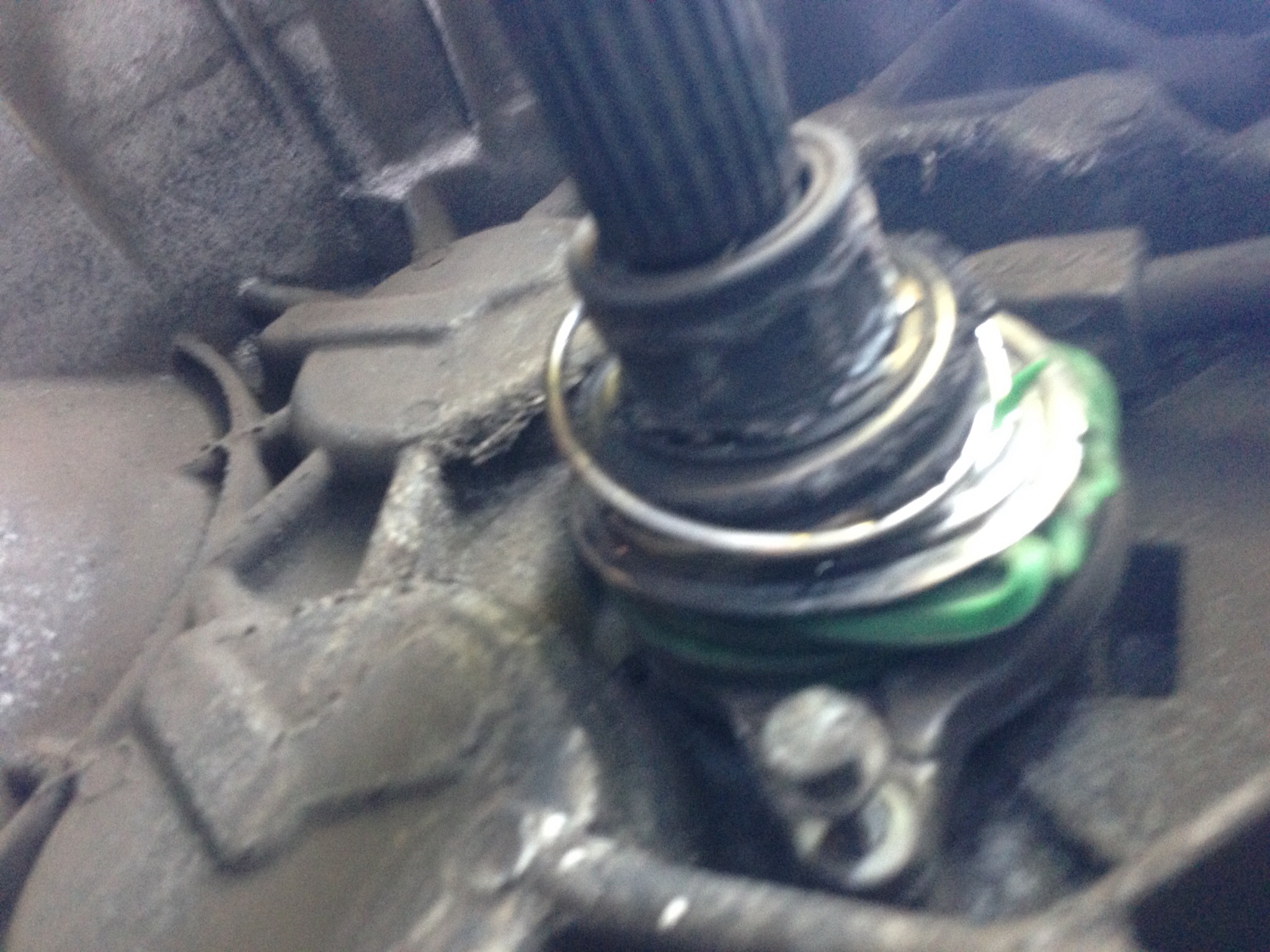

Adding some info on the internal slave cylinder
My P2 (2005) uses what looks like exactly the same internal cylinder and it self destructed somewhere between 90-110k miles. The cover , spring and ball bearings all exploded into the transmission, somewhat incredibly the bearing still functioned. I drove the car about 10,000 miles on a clutch that would slip under hard uphill load in top gear. SWMBO took this car on business trips and reported no slippage but she is a mechanics dream on car abuse ( or nightmare if you like revenue)
Nite my car was missing one of the M6 retaining bolts...Whoskey Tango Foxtrot?
