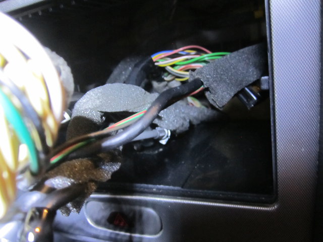

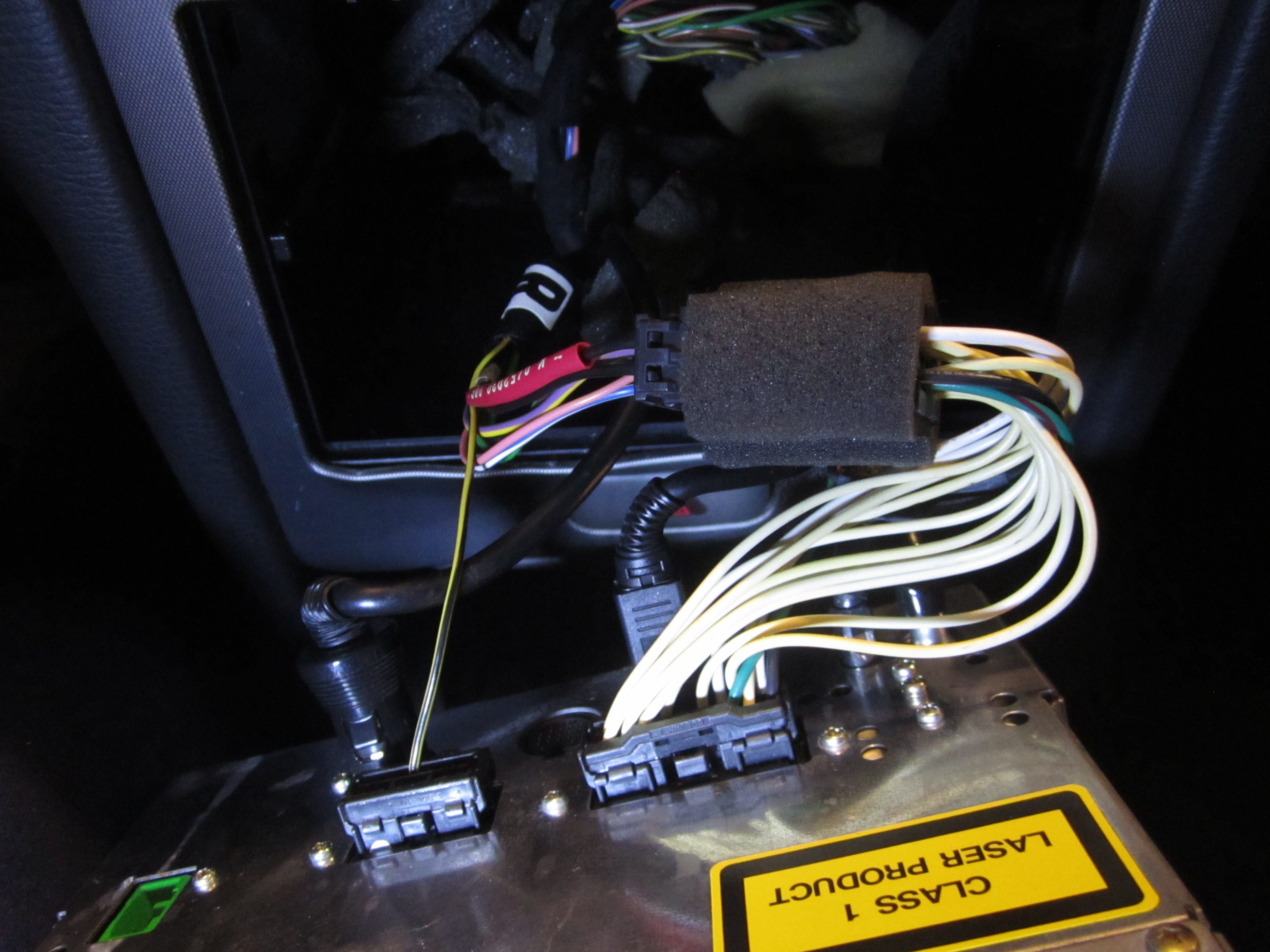

Following on from this I was looking at pulling out my amp to test the one I am sending out when I found my radio has a strange short cable connection between the regular amp to radio connector and the radio. I finally figured out this is to allow the inclusion of the 6 disc CD changer and an inline fuse.
