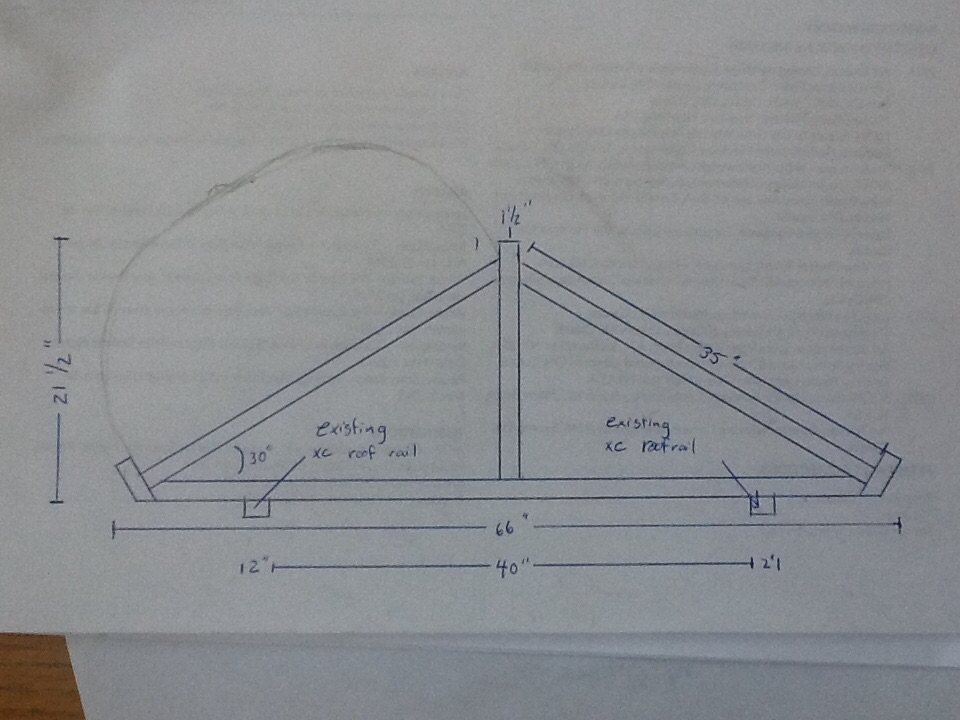

I've made this rig before out of 2x4's to do exactly what you need. You need to measure the gunwale width of your canoes and readjust the dimensions accordingly. Smaller is better. At 66" (max) you come out to the width of your side mirrors.
I don't know your canoe size or how far you are travelling North, but this rig on the car going up the 400 scared the crap out of me (the sound). Use the back roads until your comfortable that it works. I also put a few straps through the interior of the car as a safety.

Thanks for the ideas! Paco - that's an interesting rig that I hadn't considered. Any reason why you built up the A-frame rather than just going a couple inches wider and laying the canoes down flat? I need to get the canoe out of storage and measure width. I'll post pics once loaded!

I used the A frame so my roof rack wouldn't extend past the side mirrors. I wanted to keep it compact as possible. I was also transporting 1 of those plastic 3 man Coleman canoes that was fairly wide.
You will need to make 2 of these if you use it.

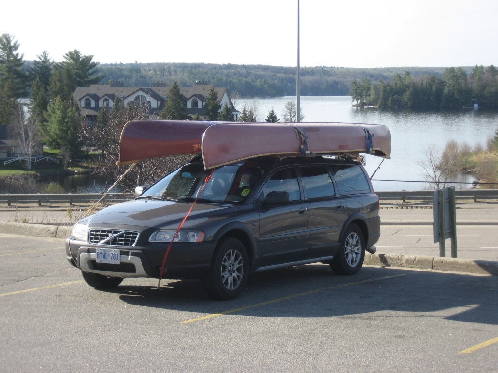

Here's the rig I came up with. I mounted two 75" long 2x4's across the roof rails, using some scraps of hardwood flooring as shims to level and locate the boards. Carriage bolts with a piece of flatbar bent into a u-bracket clamped the boards to the rails securely, and the canoes were then mounted side-by-each on the 2x4's with ratchet straps. Scraps of 2x were screwed to the ends of the 2x4's to prevent the canoes from sliding out. 'Insurance' straps were mounted from bow and stern as well, just to be sure. It ended up being a very secure rig, with no problems at all on our 500 mile round trip run up to Algonquin Park.
