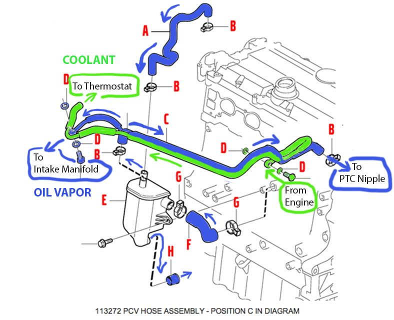

For the part from the oil separator to the PTC (with the coolant line bundled), since this goes to the thermostat, I'm guessing this is to keep the oil cool, versus to heat it (as I orignially thought - assuming it would be best to not clog the hose by keeping the vapors from condensing). I'm guessing the thinking is to get the vapors to condense and stay in the oil separator, versus moving to the PTC?

Since (answering my own question), the separator->PTC hose should be at least shielded from heat (are the upgraders to heater hose wrapping the coolant line around it?), I'm thinking use the stainless version there, and use an extra long coolant hose wrapped around it, and then cover the two in header tape to insulate from the block heat.

It may be just me, but I don't really understand what you mean... I can't remember any coolant line to the thermostat that has anything to do with the PTC. All that goes to the PTC is the hose from the oil separator and the vacuum line from the passenger side of the manifold... right?
The PTC is there to heat vapors for a short while at start-up - I don't think the volatile parts of the crankcase pressure gases will care too much about a few degrees while the car is running - that's also why they're routed back in to burn with the rest of the dinosaur remains. The hoses are indeed shielded from heat, but I suspect that's more of an issue for the hoses themselves (especially those hard plastic lines) than for condensation reasons. I may be totally in the wrong. It's been known to happen, more than I'd like :lol: .

Sorry, I'm referring to this pic:
https://www.matthewsvolvosite.com/forums ... p?id=19810
From Page 5 of https://www.matthewsvolvosite.com/forums ... 40#p305270
(Post by MMT51 » Fri Nov 01, 2013 3:42 pm)
I'm assuming that green line is coolant - I can't image a reason to run a vacuum line 1) to the thermostat or 2) bundle it with the larger hose. (?)

The coolant line (1999 and on) actually is to keep the PVC system hot relative to air, and keep the oil in vapor to get drawn into the air snorkel vs the PTC nipple
