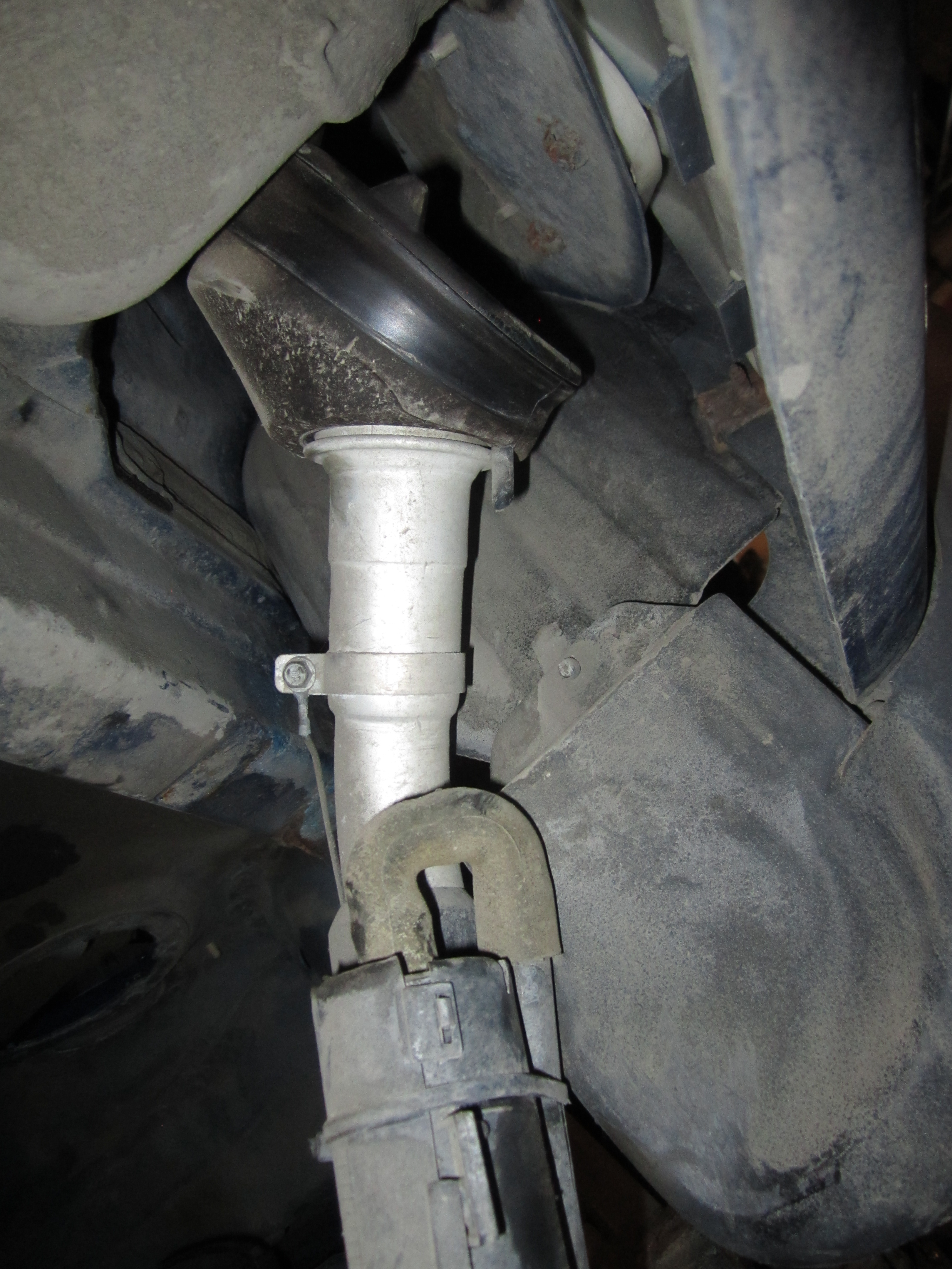

I don't believe this causes a problem. It fits to the outside of the fuel filler pipe to fill the gap around the pipe and to channel any splashes of fuel down a small hole.
Attached below is a picture of the rubber 'neck' after dropping the rear suspension on my 2000 'R'.
I believe you could replace this by removing the gas cap, removing the lock ring at the outside edge (it is a large round stainless ring with a short part missing to allow it to compress to remove). And the rubber ring should come out.

Well thank for the replies, but I have completely opposite answers from 2 of the most respected voices on here. I feel like I am at work.....
And sorry the photo is upside down, I generated the post from my phone and it looked fine in the preview.

I totally agree with Scot850. That part is completely independent of the filler cap seal and is superfluous to the monitored emissions system. I'm betting OzarkLee didn't know exactly what part you were referring to when he answered.

Heck, I've been wrong many times! I will try to find the spare filler tube and take some photos for you. Still stand with my view though!
The filler cap has the seal you need to worry about.
The only way to remove the fuel filler pipe is if you can access the upper pipe clamp on the rubber hose that goes into the fuel tank. Be aware the rubber hose is obsolete!
