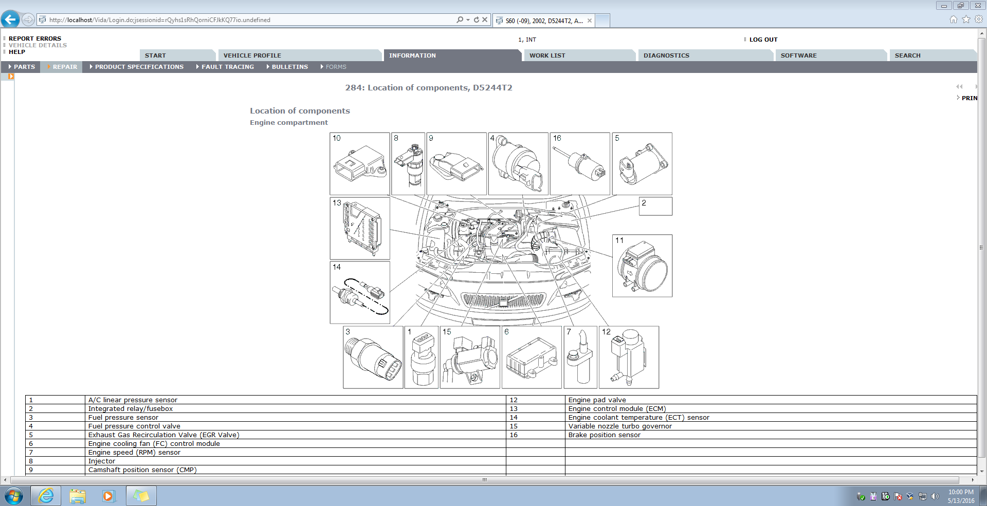

Well I decided I would spend the $100 bucks and change the fuel pressure sensor. The ones I found online all say they are mounted to the fuel rail. The only things on my fuel rail are 5 injectors and a pulse damper. Does anyone know where the sensor is on my 2002 S60 2.4 turbo AWD Volvo?

I'm *assuming* the correct engine, although I doubt it would be much different. If I can find more information in Vida, I'll post it. The D5244T2 correct?

There is no fuel pressure sensor on 2002 models. This was added on or around 2004 or 2005.
That diagram above is for the diesel. Your engine is the B5244T

Thank you MarcM, and precopster. The diagram did not look like my engine. I do have the 2.4L tubro 5 cylinder gas engine. Where can I find that engine number?
