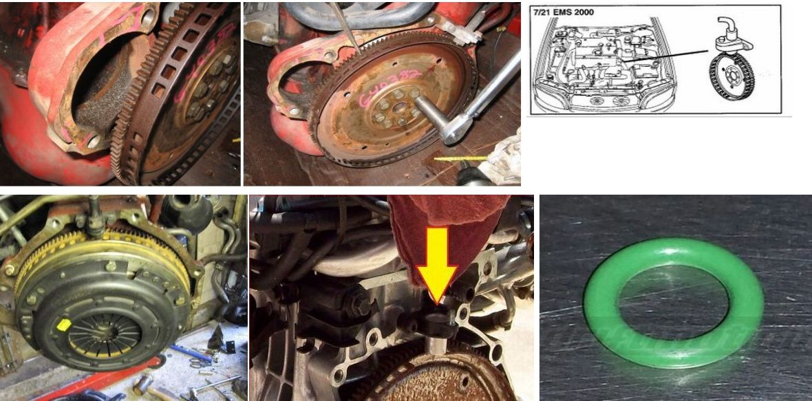

Larry's explanation of what he found ... as best I can remember and understand from his tutorial using a Volvo 5cyl engine in the shop :
1) Checked obvious things like injector fuel rail pressure and coil spark.
2) Checked codes - found O2 sensor codes and speed (crank) sensor code.
3) Dug into crank sensor area and found an o-ring sitting on the flywheel sensor trigger ring (the thing with square holes attached to the flywheel and which triggers the Hall-Effect sensor). O-ring was just sitting on the trigger wheel next to the sensor.
4) Seeing no problems with the crank sensor itself, removed the o-ring and put everything back together.
5) Cleared codes and tested the car, start run etc.
6) Concluded that the o-ring might have been bouncing against the crank sensor causing bad sensor reading to the ECM.
I attached some pictures of the crank sensor area and the suspicious o-ring which seemed to be the only anomaly circumstantially related to the problem.
Pics are just ones found in forums and websites but are representative of the actual situation with the 2002 V70.
Also found this thread that discusses a no-start problem related to faulty crank sensor : http://volvoforums.com/forum/volvo-240- ... elp-60939/
In summary, glad to have a working car but intellectually unsatisfied how an errant o-ring causes crank position sensor problems.

I'm not too happy with the oring theory either. More likely bad wiring or connectors that have been ameliorated by the disconnecting and reconnecting during servicing. Time will tell

Post by 01_Nautic_V70 »
As an electrical engineer, I'm not on board with the diagnosis. The electromagnetic permeability of rubber is approximately the same as air. Placing an o-ring between the sensor and the toothed or similar ring won't do anything. While messing around in that area, he may have bumped a loose connection.
Hall effect sensors are very very simple devices and pretty robust in that they are hard to break and the mechanism that makes them work (magnetic flux) never stops existing or working.
I'm not trying to be difficult or worry you, but I'm not confident he fixed it permanently. In you hypothesize what could cause your symptom, check that and reformulate as necessary. Until you find a deficiency that could actually cause the symptom, you haven't fully troubleshot and repaired the issue.

Abscate's theory sounds plausible.
I'm going to get a code scanner to be able to keep tabs on any CEL occurrences.
abscate wrote:I'm not too happy with the oring theory either. More likely bad wiring or connectors that have been ameliorated by the disconnecting and reconnecting during servicing. Time will tell
