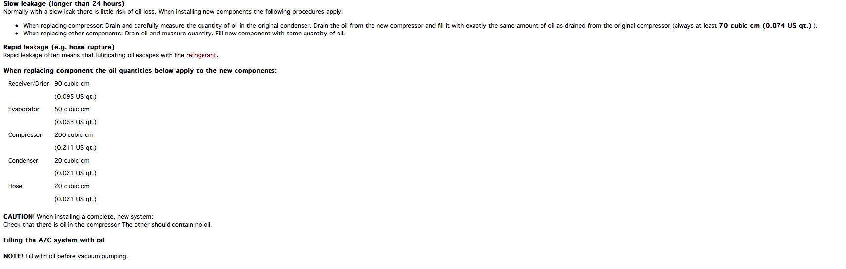

Help from Alldata on replacing PAG - Note comment on always adding at least 70 Ml on replacing compressor

I think the trickiest (and most critical) part is getting the oil right.
I'm going to post separately, but I have a seized compressor that should have had the right amount of oil delivered by the machine that "just knows how much it needs."
The machine is not mine. I couldn't get the old dryer disconnected so had the local shop do it, then (they said) they pumped down the system and the machine added the right amount of oil. That was last summer. I had cold air for about 7 weeks, then near the end of the season it went to cool and warm.
I let it be until last week, when I put a gauge on it and discovered it was a little low. So I added about half a can. wondering about the oil. At that point, I had no way of knowing how much oil was in the system and didn't want to start over. I should have taken it to a reputable dedicated A/C shop and had them do the pump down and refill. The clutch gap was wide though the clutch was cycling on-off. I shimmed it down to .012. As I proceeded to add some R134, it started to smoke and froze up.
Is there a moral here? I don't know. That car has more than 160K miles, maybe the compressor was naturally shot and just gave it up. I suspect the local shop's machine didn't get the oil right after the system was fully open and closed back up. I was suspicious of it then, but the techs assured me the machine knows how much oil is needed. I asked the shop manager how much his guys put it, he said, "what it calls for". He wouldn't give me an amount. I suspect they didn't add any to the new dryer, just set the machine....
When I went to pick up the car (last summer) after they'd replaced the dryer, I started the engine, drove about 3 feet and the union at the dryer blew apart with refrigerant and dye all over. They put it back together and it stayed together. Did they properly pump it down? Add oil for a new component?
There isn't any way to prove they did things wrong. This time around, I should have stage zeroed it with a dedicated shop. I eat this one.
They also worked on my other 850 A/C which blew cold for a few weeks then went to warm. All the 0-rings leaked, system pressure went to zero. I'm going to replace the 0-rings but then take it to a dedicated shop for the remainder of the service.

You can't really over oil these systems. I guess you can to the extreme. Excess oil will end up in the dryer and just sit there.
