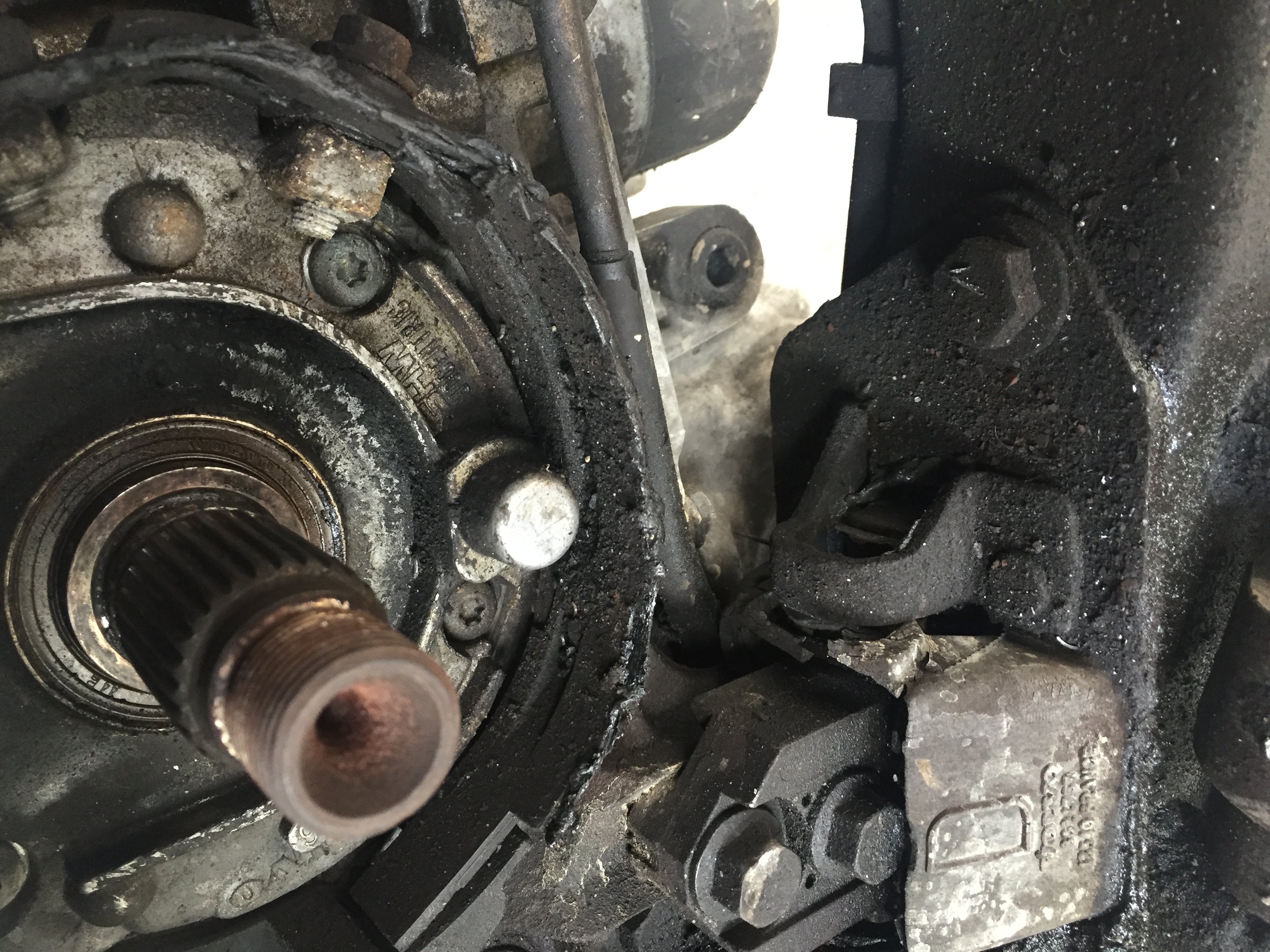

I have attached a picture of the inside and outside of the gear.
They said they did not remove this initially and it was difficult to remove because of corrosion. They are not accepting responsibility for the toasted engine.

Based on the pictures that crankshaft timing belt pulley is not stripped. There is no way you could turn that on those splines.
It is indexed, I wonder if they jammed it on over the index mark in the wrong place?

There was a thread in the XC90 forum regarding a stripped timing belt gear. The XC gear had corroded at the joint and the splines stripped. I think it was on a 2.5L.
Splines in your picture look like they are good at front end, but stripped starting about a third of the way in. The comment about the collar not being bolted in properly leads to maybe the gear "walked" out from the crank end, and then the torque stripped out the splines ? If that were the case then yes, it could have taken time to occur, and yes, it could be due to improper initial repair. The court challenge though will be to PROVE IT.

splines don't simply strip out unless they're not engaged properly. (or in the case of angle gear collars, inadequate material)
I would not expect anyone doing a timing belt service to remove that and inspect it. that's beyond the scope of that work. once that piece is installed by the factory it should never need to come off.

Those splines don't get messed up as long as the crankshaft nut remains good and tight. My guess is that shop "A" didn't torque it properly. This allowed the pulley and sprocket to slowly wander off the end of the crankshaft. About a 1/2 inch before it totally slipped off the crank it started wobbling about, messing up the end portion of the crankshaft splines. Finally the sprocket either fell completely off or it had such minimal interface with the crank splines that it DID slip - BAM - end of engine.
Take a look at the inside of the plastic timing belt cover. Look for evidence of the belt and/or other rotating parts digging into the plastic.
BTW - in the first photo, which I assume was shot from the inboard side of the sprocket, the splines look slightly flattened or worn off. They are often built this way to make it easier to install the sprocket. Looking deeper into the sprocket, the splines look entirely worn off but I think it's just the obscure lighting that give that illusion. If you look all the way through the sprocket to the other side, the splines are visibly still in tact.

What's their explanation for how beat up that one bolt is? Oh yeah, and where's the crankshaft nut?
