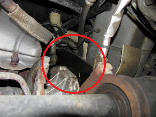

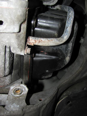

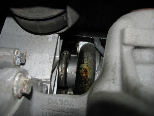

Hi there,
Yesterday, I did the yearly engine oil/filter change, usually I do it in June after a top up in December with 1.4L.
I was expecting to get to June with the oil level being at the min. on the dipstick (as every year), but this time the level was about 3/4" below the min. level :shock:
The car has 235.000 KM, runs smoothly, no errors or whatsoever, however, when I was removing the oil drain plug, I noticed three wet areas, I have no clue whether they are related to the low level of the engine oil.
I took some pictures, I am sure you can tell me what it is and what should I do next.
Thank you!
Alex

Pretty normal after all those miles- just keep an eye on them! The first picture of the turbo is very normal...the other two, I'm trying to still make out where they are...but if it's just a tiny bit- like I said, don't worry about it... You might however check your rear or exhaust cam seal...it sometimes goes quickly than others and can drip from the top... just a little at first. If it's barely wet, I wouldn't sweat it but I would investigate the PCV system to make sure it's not starting to clog up. If it is not breathing properly, then the leaks will progress.

1 liter every 5000km isn't too bad, and you guys drive a lot in Canada. How many kms did you drive in the year?
You should check the oil dipstick every month or so on a ten year old car. You don't want to run this lie on oil, it gets really expensive fast. Those leaks look really minor, almost just seeps, not leaks, so not worth fixing yet.
