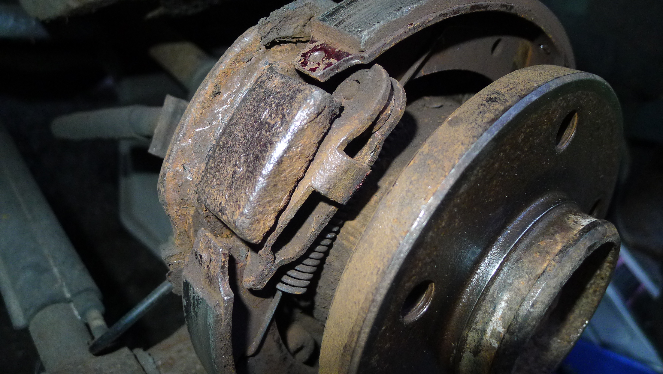

see photos. rusty, eh?

Wow, it is rusty! I have said before the parking brakes are not a fit and forget item. I suggest first get someone to gently pull on the parking brake lever and watch to see if the brake shoes move. If they do then you should be ok, but when the release the parking brake do the shoes return? If in doubt measure the diameter before and after.
The shoes do not look fully collapsed. There is a swivel pin on the saddle at the end of the cable which seizes when not lubed from time to time. The lever mechanism also can seize. Seen enough of them at PnP and on the cars I have bought. My advice is to strip that side down to the back plat and remove the lever mechanism. You may have to soak it in PB blaster of similar to be able to push the little cylinder pin that holds the cable to the lever out. To access it you have to be able to fold the lever outwards.

These are the brake shoes that were on the car, so the old rotor was on this setup, but the new rotor will not fit over.
Yes, I do think the shoes are not fully collapsed. That little pin does swivel, but I now realize the problem may be the cable not fully retracting.
Yes, Neil I should strip that doewn to the backing plate. I am not sure what the cable area as it enters the plate will look like or what I need to free up but I may find out.

thanks, Neil. that cable had indeed come detached from the housing, but a new cable was not in the cards at the very moment. I did spray the snot out of it with lube, but most of it never made it to its intended target.
My cam looks different than your cam. I have a high suspicion that the parts used on my car were not the correct parts.
I did manage to get it back together, but maybe I should not say how....
