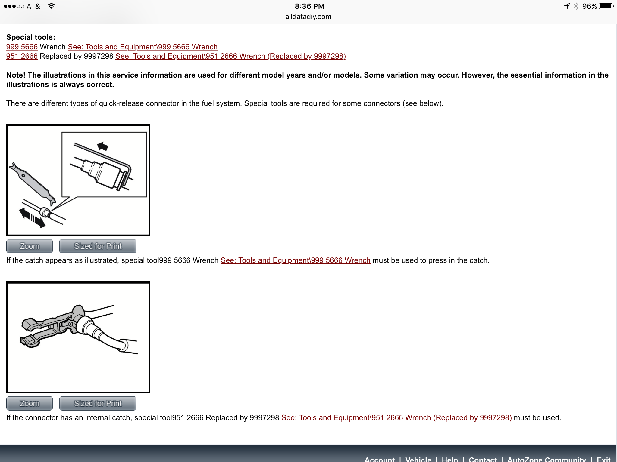

You need a fuel line release tool to release the fuel line, or fabricate something similar.
Pulling harder is not the answer.

abscate wrote:You need a fuel line release tool to release the fuel line, or fabricate something similar.
I needed one for 2002, but not for 2005.

It turns out there were different styles of connectors used in 2005, so, as they say, YMMV
