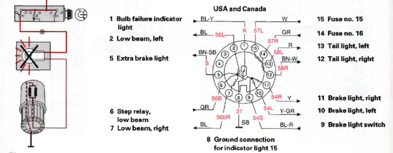

the blue-yellow wire is the wire to the bulb-out failure light. cutting it effectively disables the bulb out sensor.
pin 1 - blue-yellow - bulb failure warning light
pin 2 - blue - low beam left
pin 3 NC
pin 4 NC
pin 5 - brown-black, to 3rd brake light
pin 6 - grey, from step relay (low beams)
pin 7 - blue - right low beam
pin 8 - ground for warning light
pin 9 - blue-red - brake light switch
pin 10 - yellow-grey, brake light left
pin 11 - yellow - brake light right
pin 12 - brown-white - tail light right
pin 13 - red - tail light left
pin 14 - grey - from fuse 16 (power for right tail)
pin 15 - white - from fuse 15 (power for left tail)
battery to fuse panel to fuse 7 to green-red wire to brake switch (at brake pedal).
brake switch to blue-red wire to bulb sensor pin 9
bulb sensor pin 5 to brown-black wire to conenctor 'F' pin 15 to brown-black to high level brake light
bulb sensor pin 10 to yellow-grey to connector 'F' pin 19 to left brake light
bulb sensor pin 11 to yellow to connector 'F' pin 20 to right brake light.
connector 'F' is a 2x12 (24 pin total) connector that I think is somewhere near the back of the fuse panel. has a whole PILE of stuff on it
Can someone please educate me on when I take measurements at the aforementioned pins on the bulb failure relay - what is my reference/ground point?
93Regina
Posts: 2813
Joined: 18 Jan 2014, 19:11
Year and Model: 93:240/940
Location: Sunflower State
Been thanked: 65 times
Post by 93Regina »
seanj wrote:educate me... brake lights
To light a light bulb requires a positive and negative.
So, one uses a grounded test lamp, and touches the metal-tabs on bulb's receptacle. No go...then pull the wiring harness that attaches to rear-light assembly, and touch the pins on it while brake is depressed, or lights on, etc.
Is there power at this rear wiring harness?

I figured....but before I get to the tail lamps themselves (those have been rather "tastefully reconfigured' by the PO - so half of it is hard wired and the remaining half uses the PCB - I intend to make it all hard wired in the future), how do I check the bulb failure relay (the red cylinder)?
I have a basic DMM. So positive lead would go to into the pins, but where is a ground point within the dash to connect the negative lead of the DMM?

Post by 93Regina »
seanj wrote:ground point within the dash
When I get serious, I run a jumper cable from battery's ground post and use it as the ground.
Late model 1993 diagram...Yours may be different...or the same.
seanj
Posts: 23
Joined: 23 Apr 2016, 11:25
Year and Model: 1991 Volvo 244
Location: Motor City
Post by seanj »
Thank you! This is what I was looking for..
