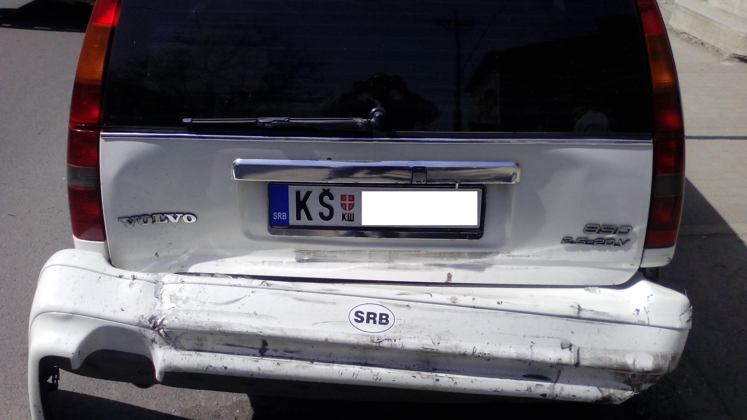

Since the car got a hit at the back about 2 months ago at a parking aside of the road:
tailgate spoiler mounting brackets
