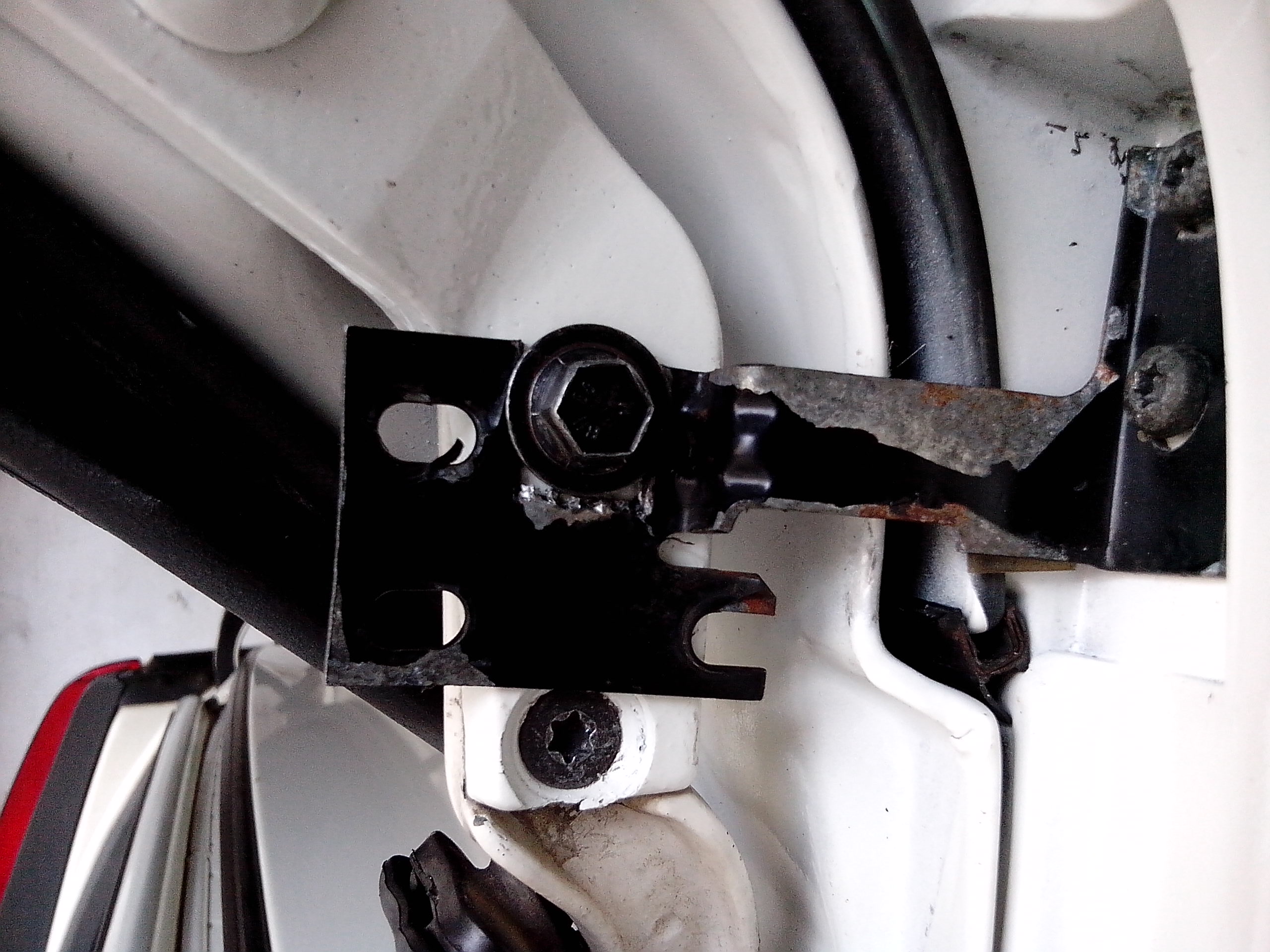

Recently,i acquired a OEM Volvo tailgate spoiler for my 850 from V70 R.As some of you know,there are two styles of mounting brackets for it.A single type and a two-piece type of mountings.
Since i got a two-piece mounting and the other half is missing i just lightly modified them in order to safely install my spoiler.
Here is the picture of how it looks:
I just cut a little u shape opening in order to bolt it with one of the existing tailgate securing bolts.In this case you will need to use a bit longer bolt with the same thread.The other type of mountings(single-type) use similiar method.
You can bent a lower side of mountings to follow the shape of hinges if you want.
