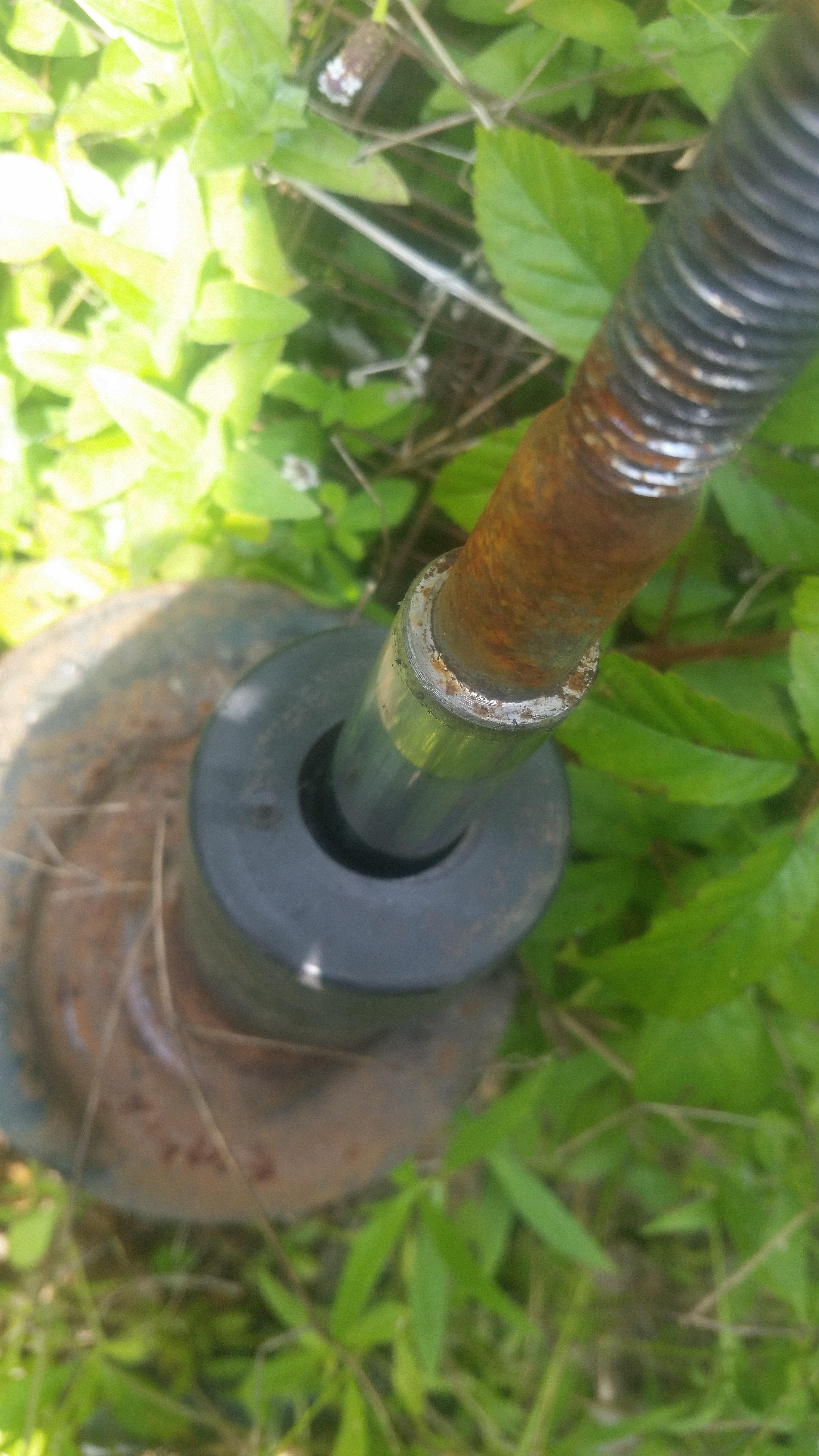

First, find a shop that can give you a printout like this one. It goes a long way in telling you what the problems may be. Mine had frozen adjustment bolts on the rear that the previous shop didn't tell me about. Those camber bolts are a common item, I think they're the same as on a lot of cars, but keep in mind that needing a lot of adjustment means something is wrong. The v70 struts aren't slotted but the holes are large enough to allow slight adjustments. My internal strut bushings were worn and replacing them brought everything back in tolerance.
