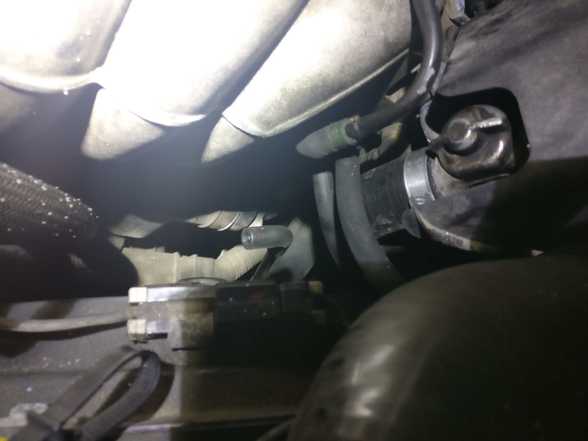

Took some photos. Here is connection to pcv nipple:
Vacuum connections at intake pcv

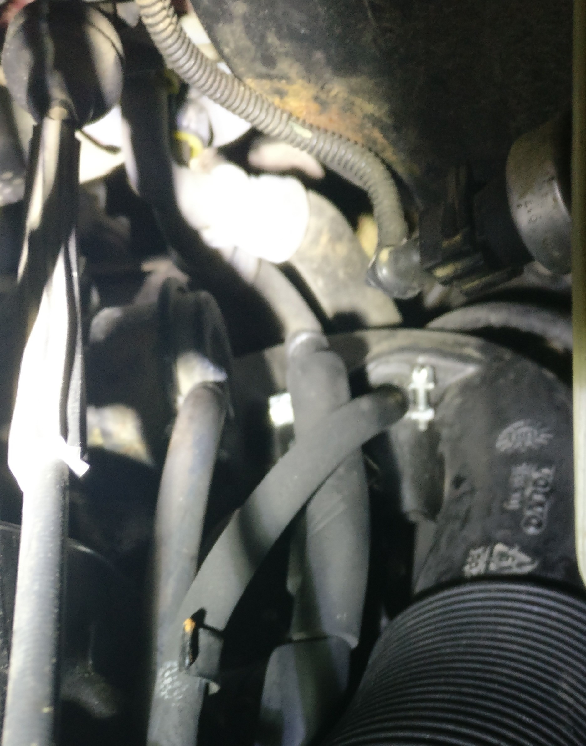

Here is the elbow:
Elbow pipe
Elbow pipe

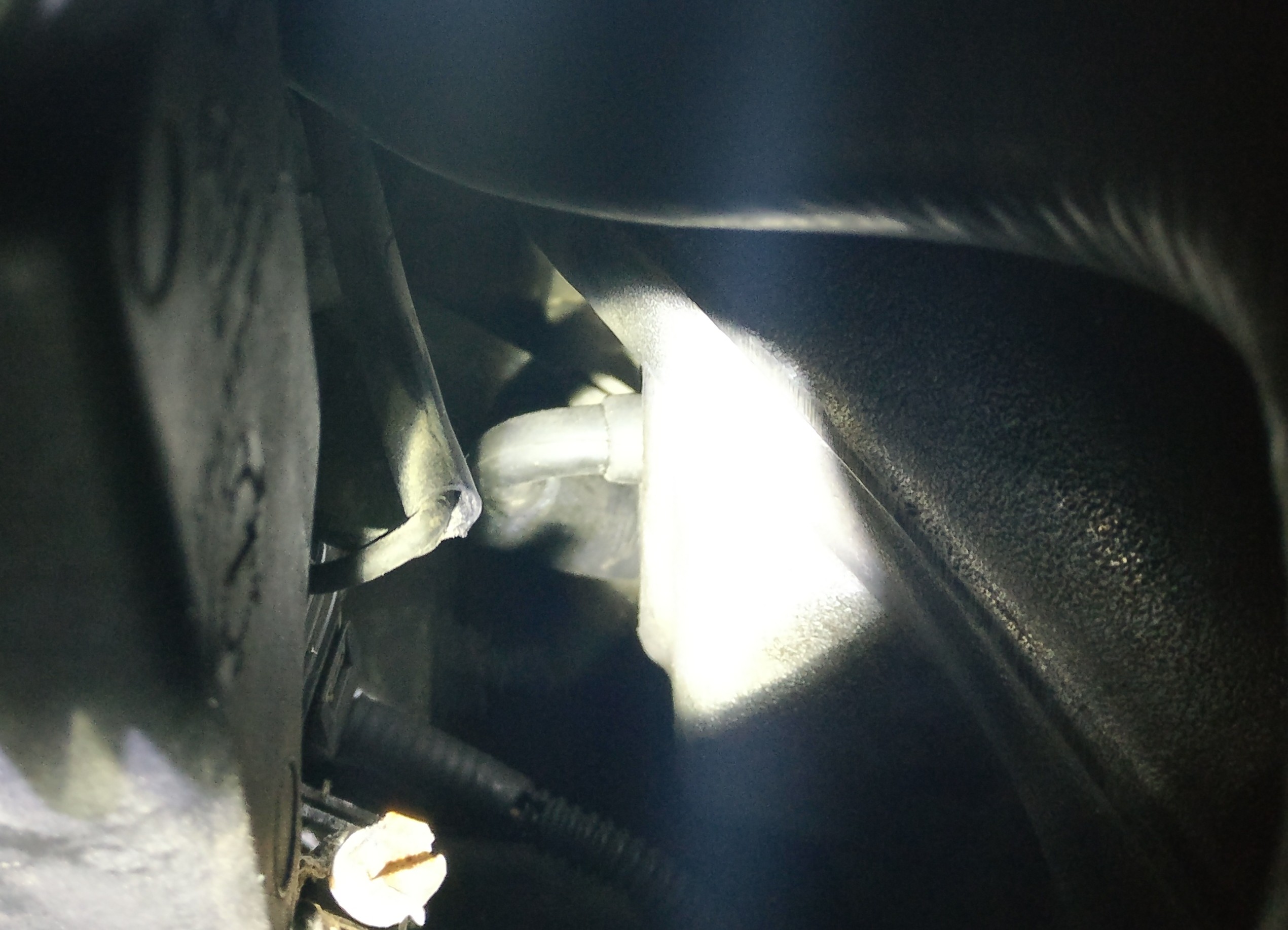

And here is one lone tube that is not connected to anything, any idea where this should go?
Lone tube
Lone tube

Hei, blackVolo
That looks like on the connections to the airbox valve for the heater flap. There should be two pipes sticking out the rear (towards driver) of the air cleaner housing with two hoses/elbows on them on your car, if it does NOT have a turbo
You will need this working in Finland in December!

abscate wrote: 09 Dec 2019, 07:24 Hei, blackVolo
What does that mean, airbox valve heater flap? is it for heating up engine from cold, redirecting warm intake air from exhaust manifold? Or is it for cabin heater? Because cabin heater works fine, gives hot and cold as needed.
Yes, that is the one. Follow the silver fat hose from near the exhaust Manifold and it will lead to the 'motor' that opens/closes the valve to set the air intake to the right temperature.

It has a Turbo, if that helps for the diagnosis. Where should I connect the other end ( in the third picture). The lone tube just stands in between fan and throttle body.
