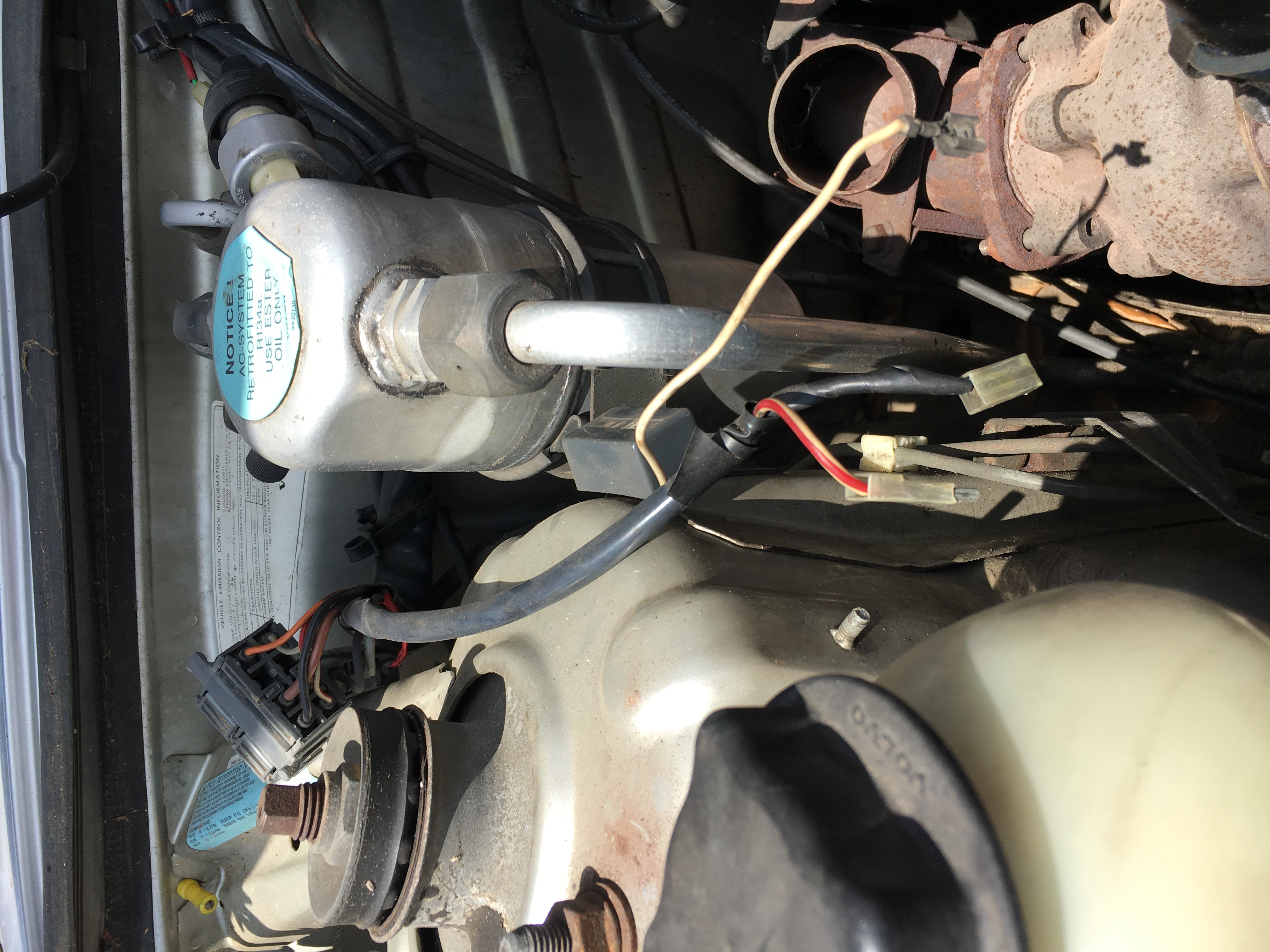

First I would like to say hello and I am new to the forum. I have been searching the forums looking for a clear answer as to how I should correctly wire a new Bosch ignition coil (not Regina) on my 1987 Volvo 740 turbo wagon. I recently purchased the car for $200 and had it brought home on a flatbed. The ignition coil is missing and there are 3 wires standing there (plus the coil wire coming from distributor as the 4th wire). I have included pics.
1 wire is red/white
1 wire is covered in black tape so I am not sure of original color.
1 wire is white/creme and is coming from a little grey box mounted on the passenger side strut tower. I haven't the slightest clue what that thing is. (Have looked through my chitons manual also)
And of course the coil wire, but I know where it goes lol
Seeing as how my Volvo came without an ignition coil, I don't have a clear answer as to how the wires go back on the new coil correctly (I noticed a positive and negative side on the new coil)
If anyone could assist me I would be very grateful! Hopefully the attached pictures are of some help!

Cheyenneholdings wrote:1987 Volvo 740 turbo
Turn key switch on, and find the hot wire, and place it on + side of coil.
Put other two wires on negative side of coil.
Use a coil that was designed for your Volvo...

Thank you very much for the prompt reply. I have a 6-12v circuit tester. I turned the key on as instructed and attempted to test the metal pieces (connectors?) at the ends of the 3 wires. The test light never lit up. Am I possibly using an incorrect tester? Or do I need to actually pierce the wire with the tester to accurately check it? Also, I grounded the clamp to the fender, is that acceptable?

Red-White (coil terminal 1) wire goes to powerstage pin 1.
Blue (coil terminal 15) goes to powerstage pin 4 and fuses 12 and 13
My 1988 760 Turbo Wagon which has same EZ117K ignition system has this:
2 each red/white wires connected using one female spade terminal to coil.
1 each blue wire connected to the other terminal.

Ok I see it now. That sort of makes sense.
So if I understand correctly, the red/white wire and the creme colored wire go to the positive terminal on the new coil? And the black wire that should be blue goes on the negative side of the coil?
I have no idea what power stage pins are.... Are they they prongs on the new coil? And if so, how do I know which is which as none seem to be labeled??

Post by lummert »
Cheyenneholdings wrote:Ok I see it now. That sort of makes sense.
The ignition powerstage is also known as an ignition module. For future reference the powerstage is attached to an aluminum heat sink on the drivers side inner fender near the battery.
Terminal 15 (blue wire) connects to the ignition switch. That would be the coil positive side. I can'd find a cream colored wire connecting to the coil in any of the wiring diagrams. Maybe trace the cream colored wire to it's other end, maybe it has been spiced into another color wire.
