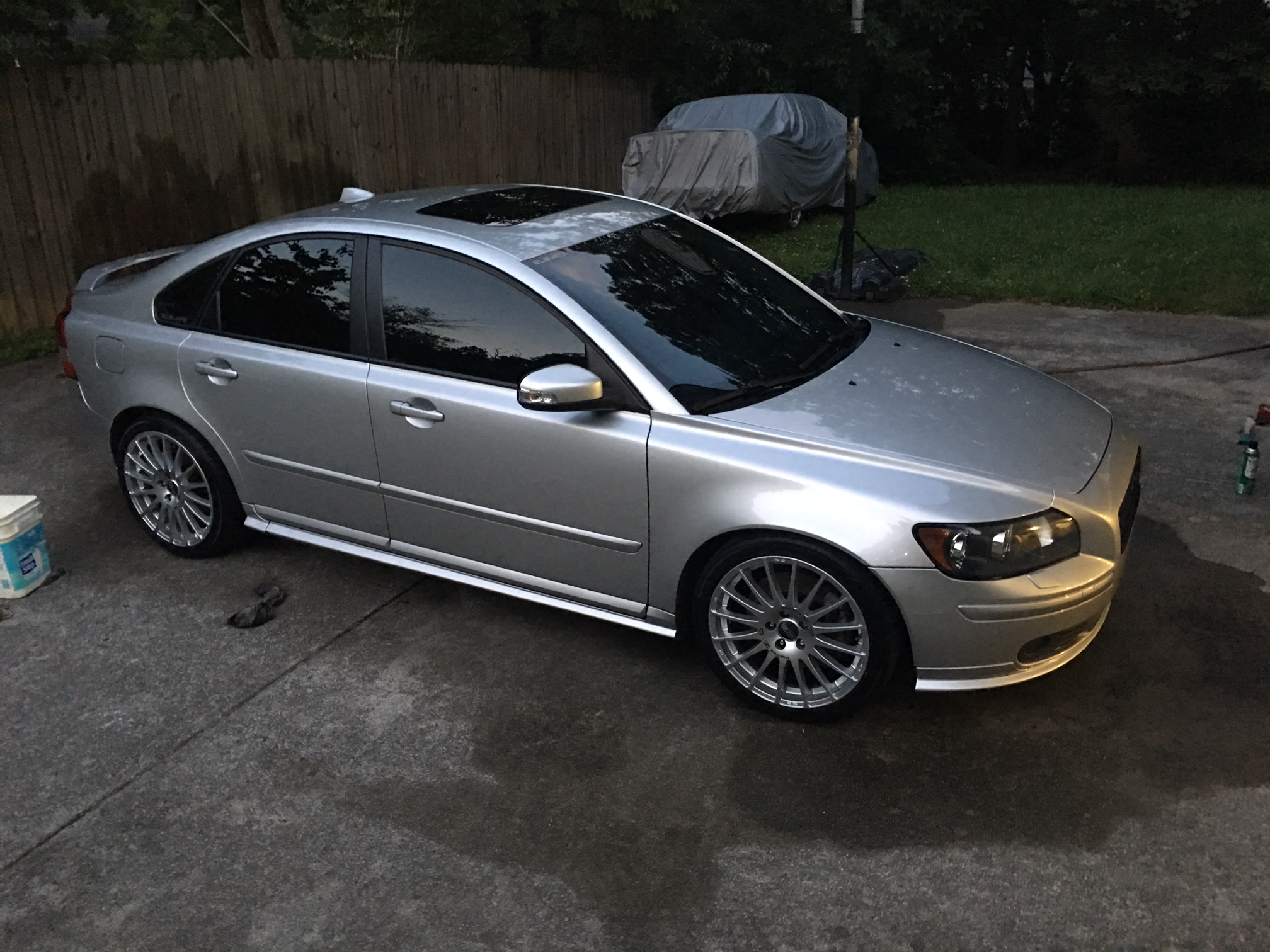

That really is a nice looking Volvo. Most models do so well in silver - but not the C70, the rubber roof seams screw up the lines.
Do you ever feel like the rear end is trying to get away from you? Is it a DSTC car? 27mm sounds pretty extreme, I think the Elevate is 25 and IPD's is 23.something. I hate having to choose based on marketing and sales hype; but then, how many people get to drive more than one configuration...

Yes, it is DSTC and AWD so I don't feel that it does give way in the rear. Instead, I feel very well planted. It would however probably be dangerous to drive it with the stability control turned off (which I can do if I choose) especially in some tight cornering. Being AWD, the option on the front bar- although possible, is limited- it's a lot of work to lower that subframe to add a larger sway bar up front (with AWD)- more important would be good end links at this point LOL. Yes, 27mm is a bit aggressive but for a lowered car (Heico lowers it 30mm) it feels very stable. If your suspension is stock (and not lowered), I would probably stay away from something like my setup as you would have to compensate with a front sway bar that is beefy as well. That was one reason I added the mid chassis brace. Anyway, several people had tried my car's configuration over on Swedespeed and reported good results so that's what prompted me with the go-ahead. If your C70's suspension is not altered, I would be tempted to go with IPD's rear and front sways unless Elevate offers a front and back set and it's fairly reasonable. I have IPD's on all of our other Volvo's and I have always thought that these were the best things that I've done to them- their sway bars and their skid plates. I could tell you some stories of a skid plate saving my S70 (but I won't go into that here) so I'm a firm believer in them and I generally feel that IPD's stuff is quality!
