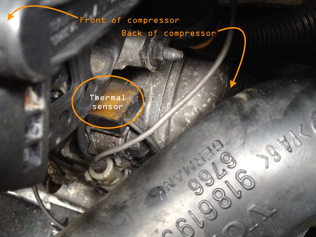

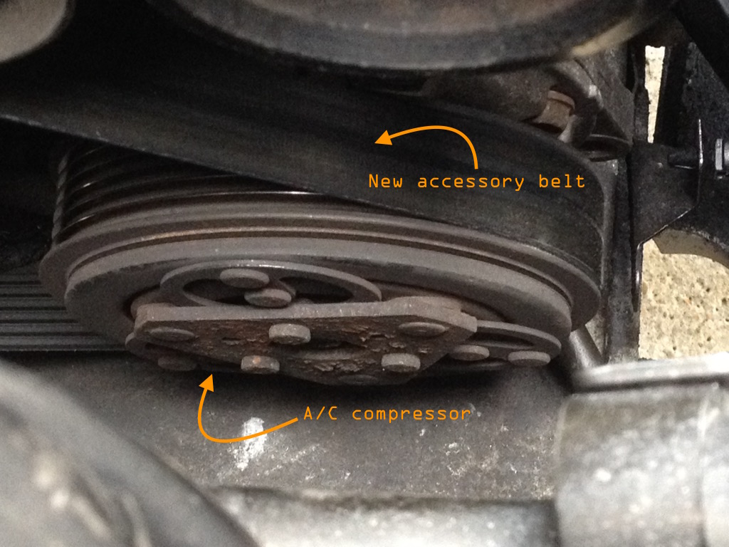

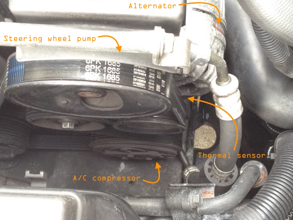

Pictures to help the next guy (and myself) to see what I'm talking about
↑ IMG_1692 — Right side of the engin (passenger side), all accessories pulleys, front of A/C compressor
↑ IMG_1691 — Front of A/C compressor
↑ IMG_1697 — Front of engine, close-up of thermal sensor (little orange box) with cables
