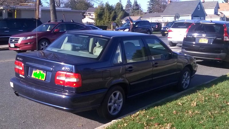

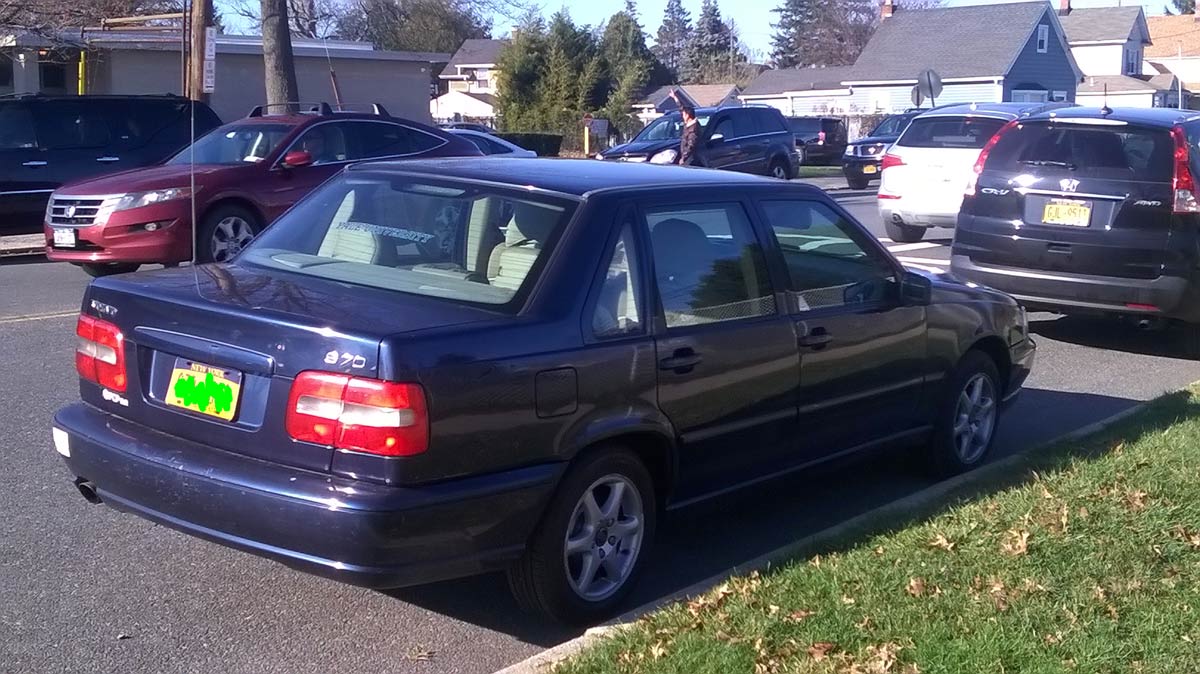

I actually never took a picture of the car when I purchased it. But I did take a picture of this:
We're at 162K right now. (Yeah, we don't drive much!) We're coming up on the one year anniversary of having our Volvo!
Here's what she looks like right now:
98 S70, N/A, 5-Speed, Dark Blue, purchased with 156K 7/24/2015
