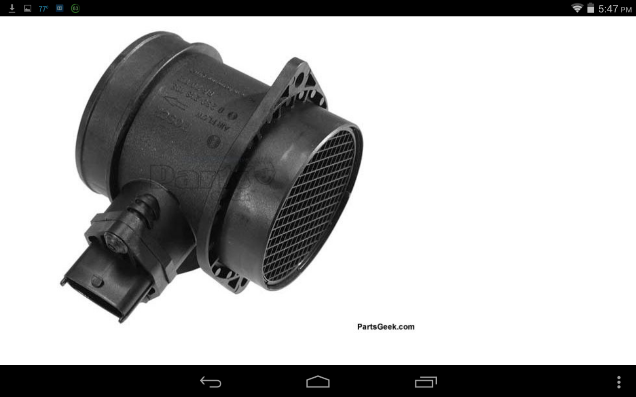

Hi there. I'm wondering if the item you're referring to is the mass air flow sensor since you mentioned a "short". There is a heated filament inside of it that helps the cars processor determine air flow rate entering the intake to accurately meter the fuel mass that is delivered via the injectors. If it isn't working correctly drivability suffers, ie: stalling, no starts, even poor shifting in automatic transmissions. If no improvement occurred with replacement, there is more than likely something else going on. Sounds like parts are being thrown at it without a clear diagnosis, and those prices are way too high also. I'll post a picture of the maf from a 2000 s70 and you can confirm if its the part.
