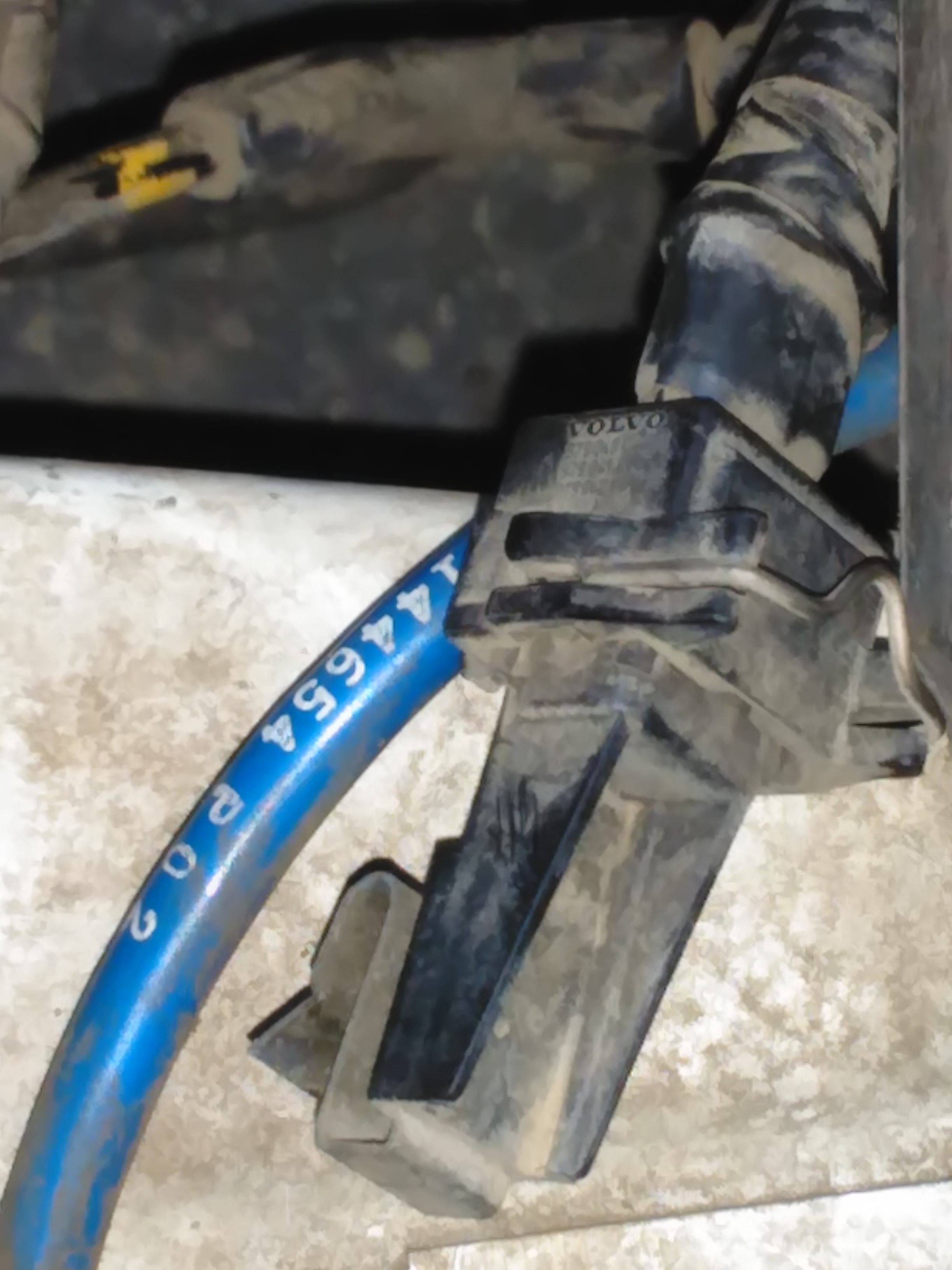

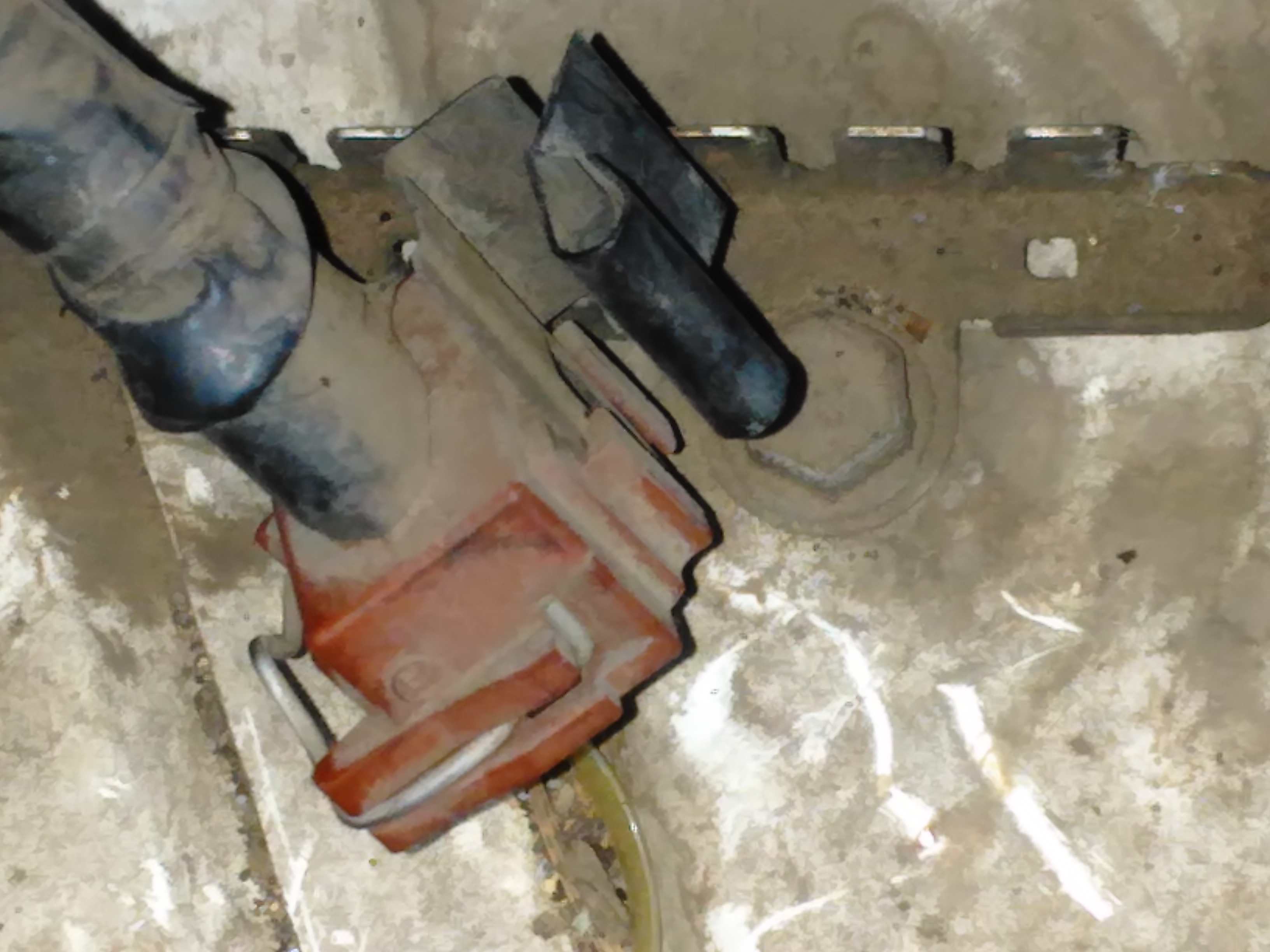

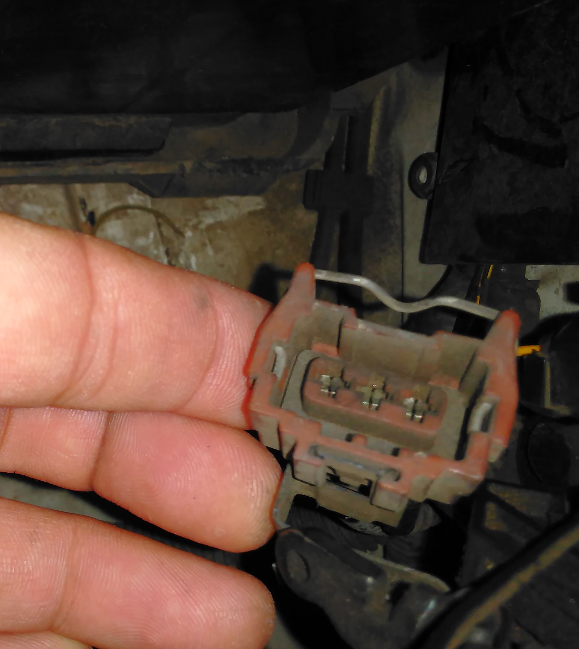

found these just loose unplugged near the battery , any ideas??

Headlight wiper motor & headlight electric adjustment if your car is not equipped with them.
These cars are prewired for all possible equipment from the factory...just....some cars are fully equipped...some are not.Some have more equipment than another.
They are not just "loose unpluged"...they are capped for possible future use.
