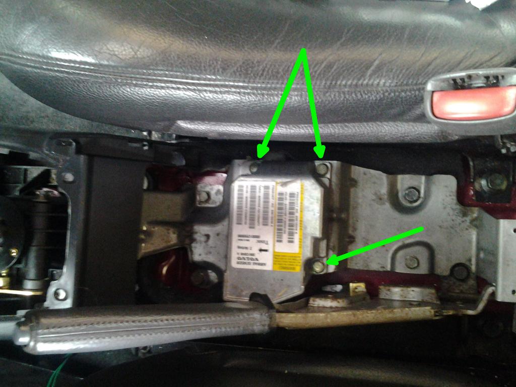

As a rule, SRS Module and sensors are buried deep inside the car (like the Black Boxes in the rear of the planes to avoid damage).
Pick any car, the SRS Module usually sits in the center console, and is protected from the most severe collisions.
The Temic sensors (usually 3: one mounted on R cross-beam....under right passenger seat area, one mounted on L cross beam and one sits somewhere aft of the gear shifter.)
Each of these sensors measures: right hit, L hit, frontal hit respectively.

I will post the photo of the SRS Module only to show you the location.
No need to replace it.
The Module sits between right and left seats:
