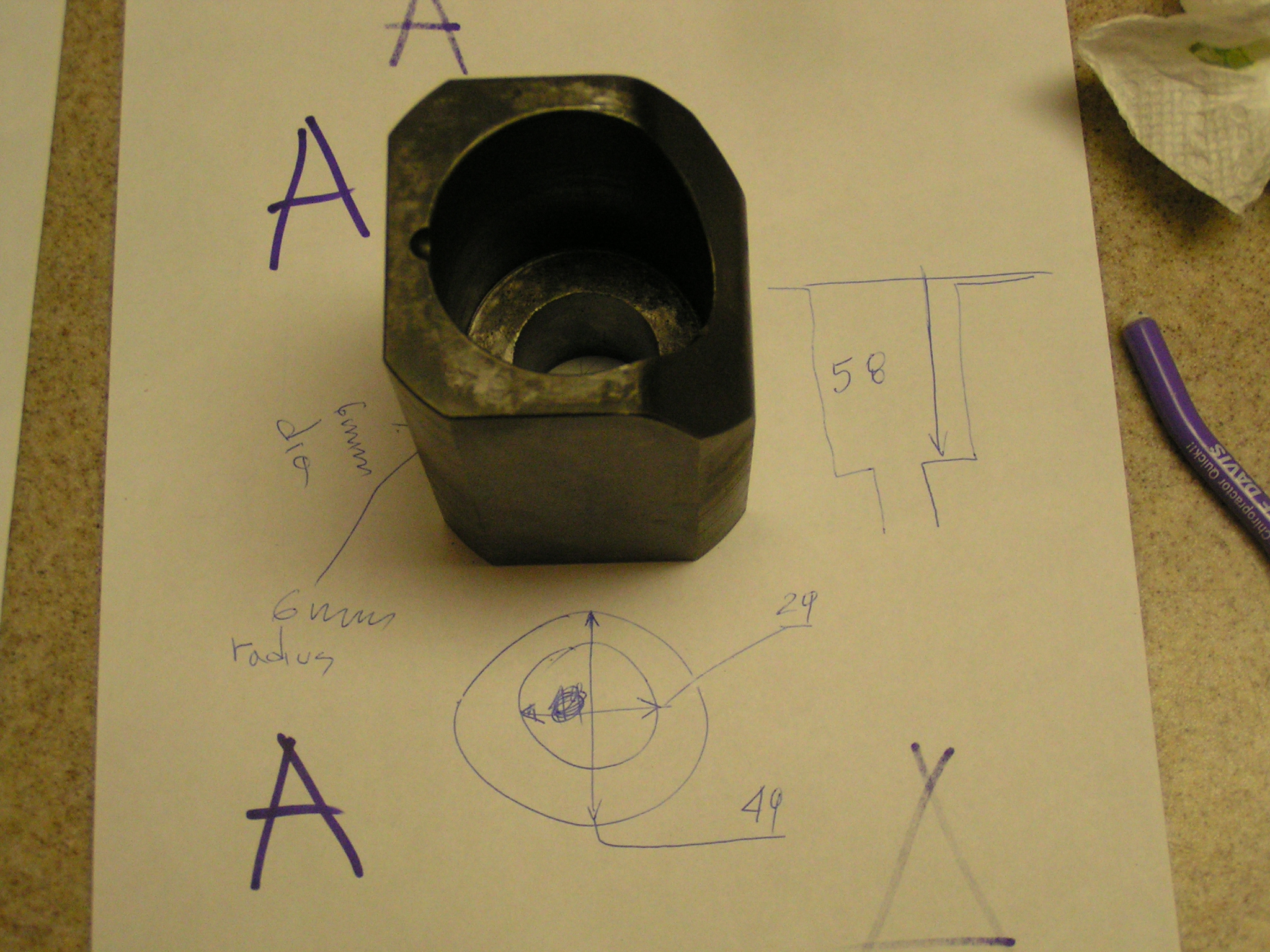

General consensus is that replacing the complete arm is times easier than pressing the bushings. If looking to keep the car for another few years, there are only two durable options for the arms, either Lemforder or original Volvo part. I did buy the bushings off Ebay and had them pressed in, to press out the old ones you need to drill the rubber, throw the center metal part, ten punch out the outer sleeve (a small groove cut helps punching it out). Something like this
Pressing in new bushings requires special adapters although this user managed to use standard pipe sections https://www.matthewsvolvosite.com/forums ... 11&t=23405 . With these adapters you can punch in the new bushings using some grease to help.

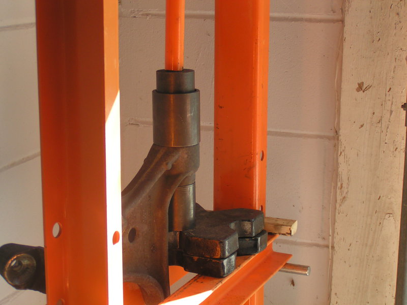

Easy to replace if you have newer LCA, which can be put squarely on a vise (2002 V70 has curved LCA - PITA to replace bushings). I got two sockets of appropriate size in Lowes or Home Depot or Sears, can't remember. Just take the front/rear bushings and a caliper with you and pick up the proper sockets.oragex wrote:General consensus is that replacing the complete arm is times easier than pressing the bushings. If looking to keep the car for another few years, there are only two durable options for the arms, either Lemforder or original Volvo part. I did buy the bushings off Ebay and had them pressed in, to press out the old ones you need to drill the rubber, throw the center metal part, ten punch out the outer sleeve (a small groove cut helps punching it out). Something like this
If you follow my setup - better put a weight plate on top of socket, that way you don't need to align the whole construction superprecisely
Lemforder front bushing has a bit longer metal bracket, so socket compresses its rubber a bit. Volvo OE bushing goes in/out without problems at all.
Couple of months ago I did it the second time, pressing out Lemforder/Meyle for OE, because I was changing everything in suspension to OE to have exact new Volvo ride, and the bushings replacement itself took me maybe 15 minutes per LCA. Btw, Lemforder were like new after 30-40k miles, but oh well, I've got OE already.
