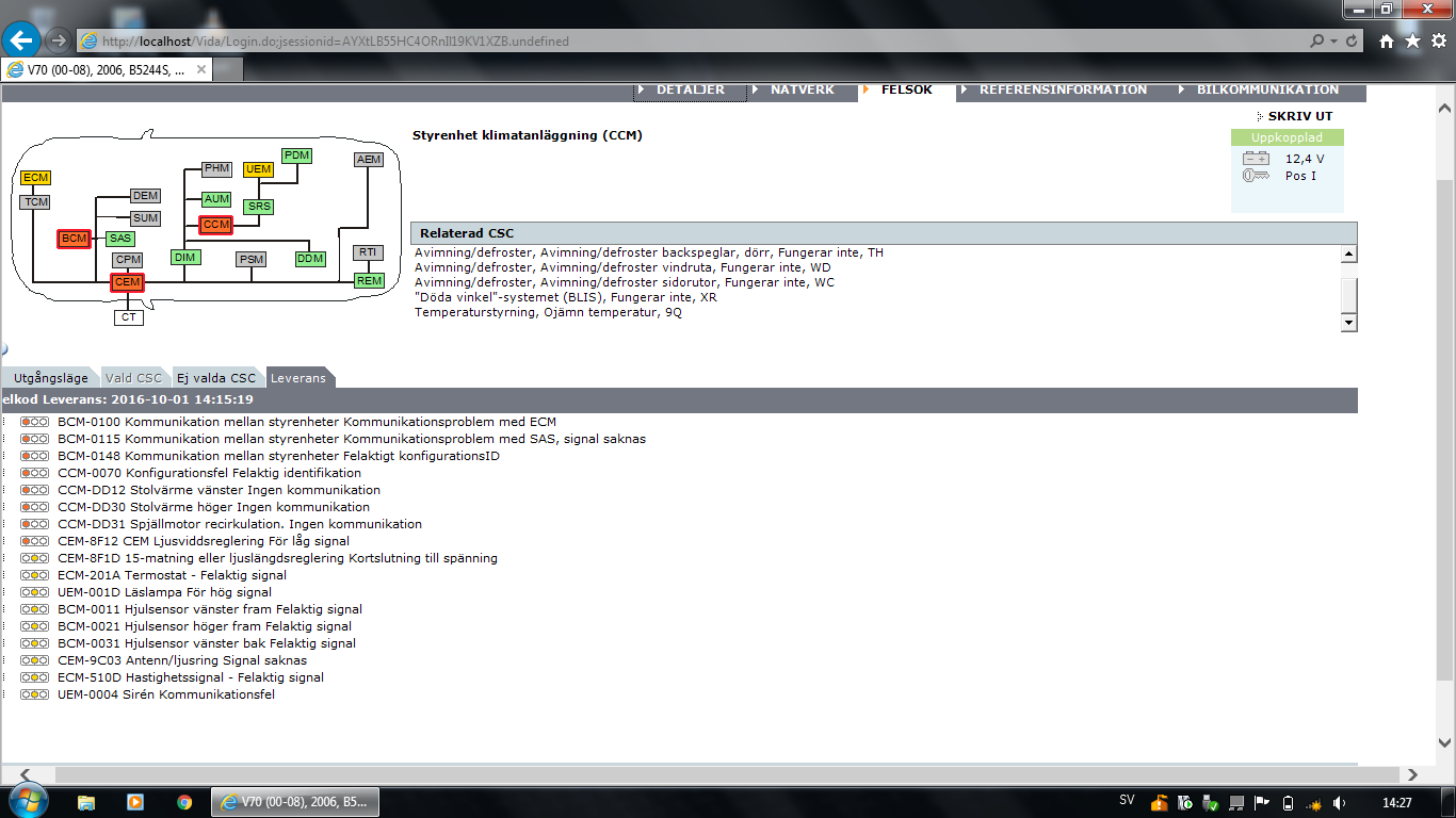

I just replaced my 02 with an 06 V70 due to issues on the ETM. So the car we just bought have some fault codes that I need help with to investigate:
CCM -0060
CCM-0062
CCM-0063
CCM-0070
CCM-DD12
CCM-DD30
CCM-DD31
CEM-8F12
CEM-8F1D
Is there someone that has any good ideas to where I should start my investigation of these errors?

Try to go through diagnostic flow charts for BCM and CEM: http://xemodex.com/us/diagnostic-flow-charts/
The BCM issue is the sellers responsability to fix since we just bought the car. But do you think that the CCM issue might be caused of that aswell?vtl wrote:Try to go through diagnostic flow charts for BCM and CEM: http://xemodex.com/us/diagnostic-flow-charts/
doublebug
- Posts: 347
- Joined: 19 Jul 2013, 06:08
- Year and Model: XC90 2007 D5
- Location: Belarus
- Been thanked: 7 times
As for BCM only issue is wheel sensors. But details needs to be posted. That maybe and very old issue and can be ignored.
CCM There is issues with seat heater control modules and some damper motor.
ECM has issue with thermostat that is cause of BCM-0100.
UEM faulty siren module.
CEM current issue with headlamp adjuster motor
SAS faulty steering wheel sensor. Causing BCM-0115 and BCM-0148
All yellow codes needs to be checked for details and counters. Without this information they are useless.
And all these codes are not software related.

Thanks for reply. Will see after wednsday what happens since alot of these faults is going to be fixed by seller.
doublebug,do you think that replacing the seat heater control module might be enough to get the seat heater working again?doublebug wrote:As for BCM only issue is wheel sensors. But details needs to be posted. That maybe and very old issue and can be ignored.
