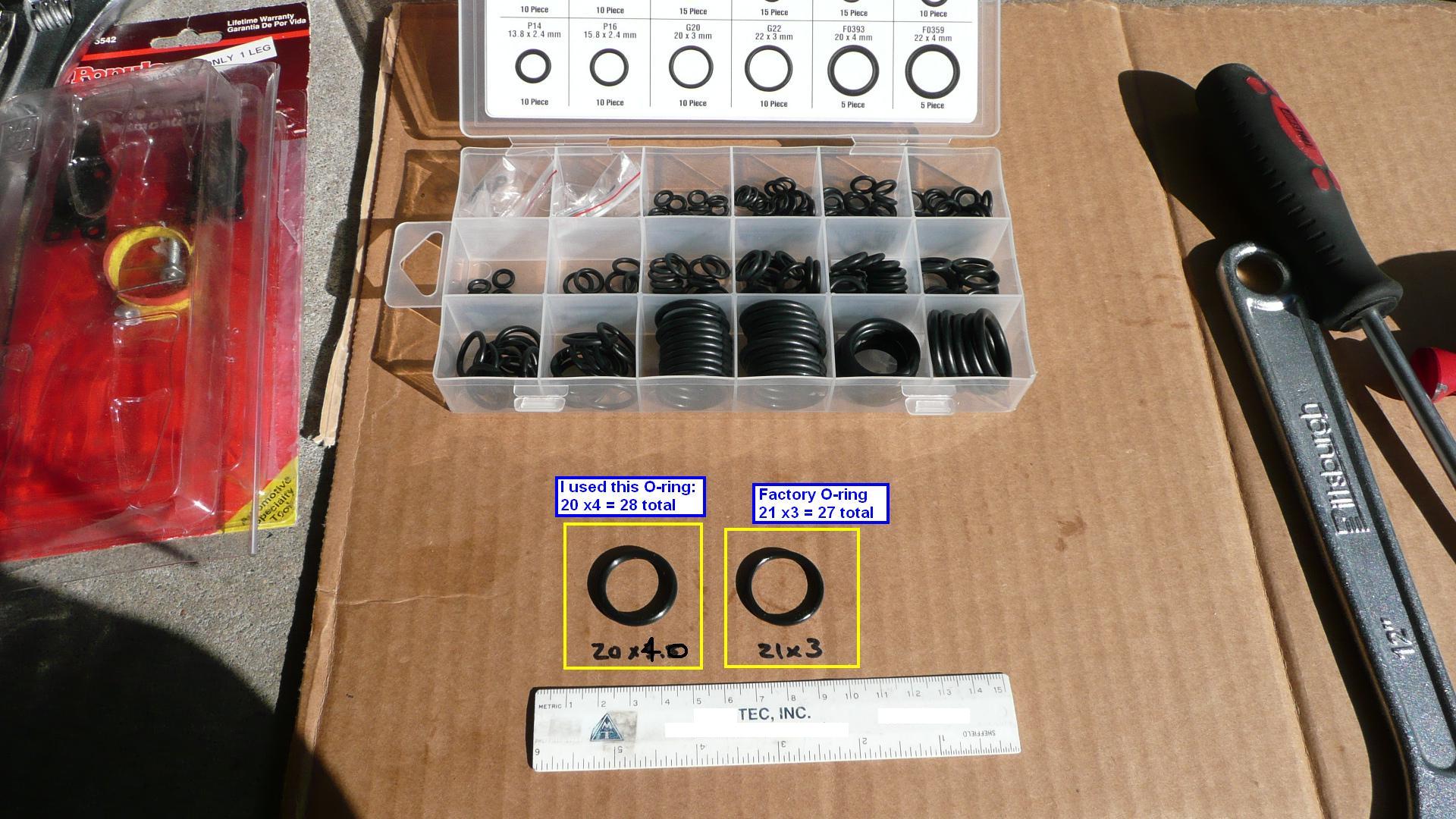

PARTS + TOOLS:
- O-ring set from HF: $5
- Hydraulic Oil: $5
- Adjustable wrench, screwdriver, snap-ring pliers.

3. The Oil Chamber (reservoir) is #21. Oil leak is prevented by:
- Teflon O-rings #20, #23. These Teflon rings are very robust and should not leak at all.
- O-ring #19: this was my problem. After a few days in the garage (not using jack at all), it leaks from the O-ring: a few drops on the floor.
Factory O-ring is: 21 x 3 = 27 mm total.
I used O-ring with: 20 x 4 = 28 mm total: zero leak afterward!
