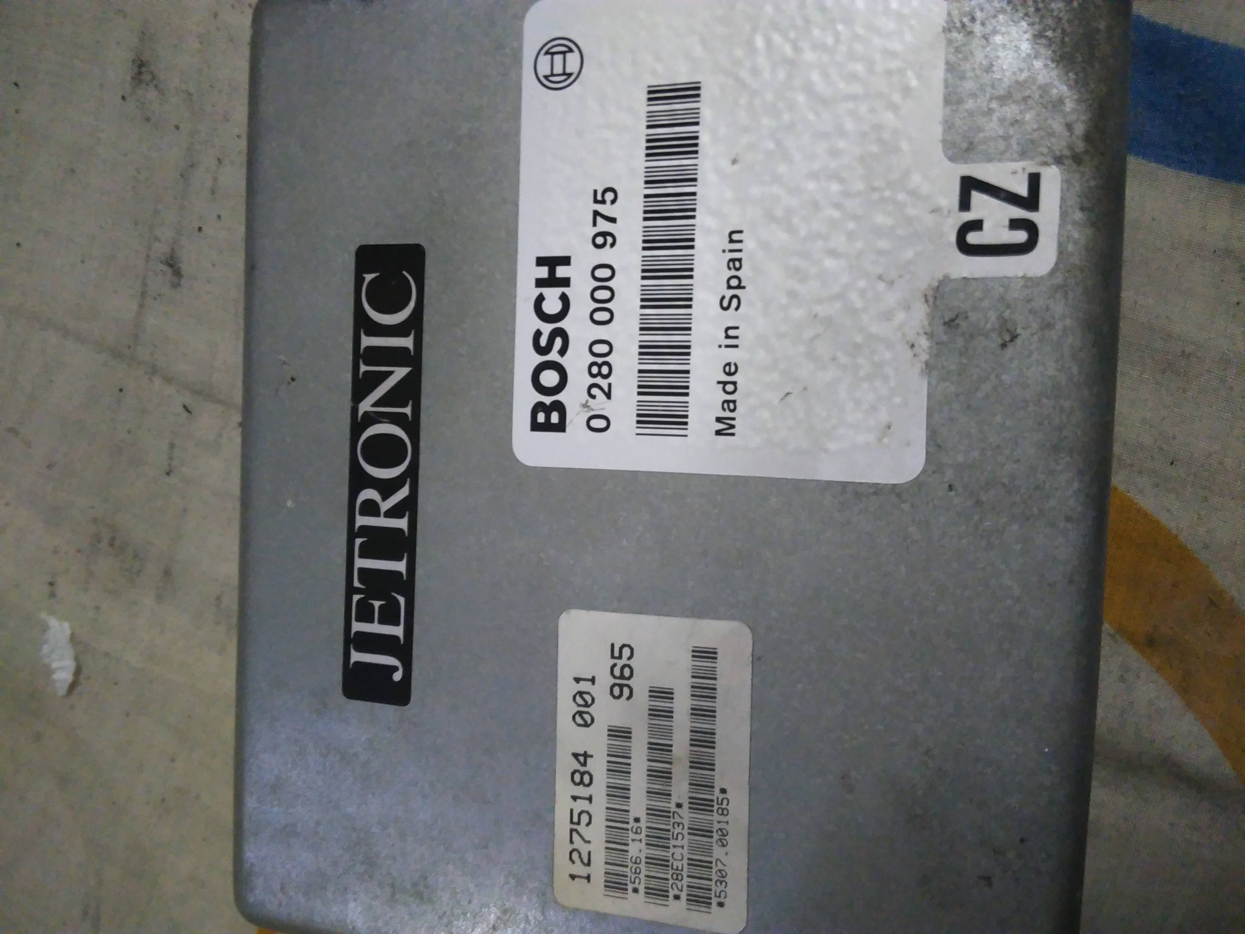

JETRONIC LH2.4 - 0280 000 975
Post by bullet79 »

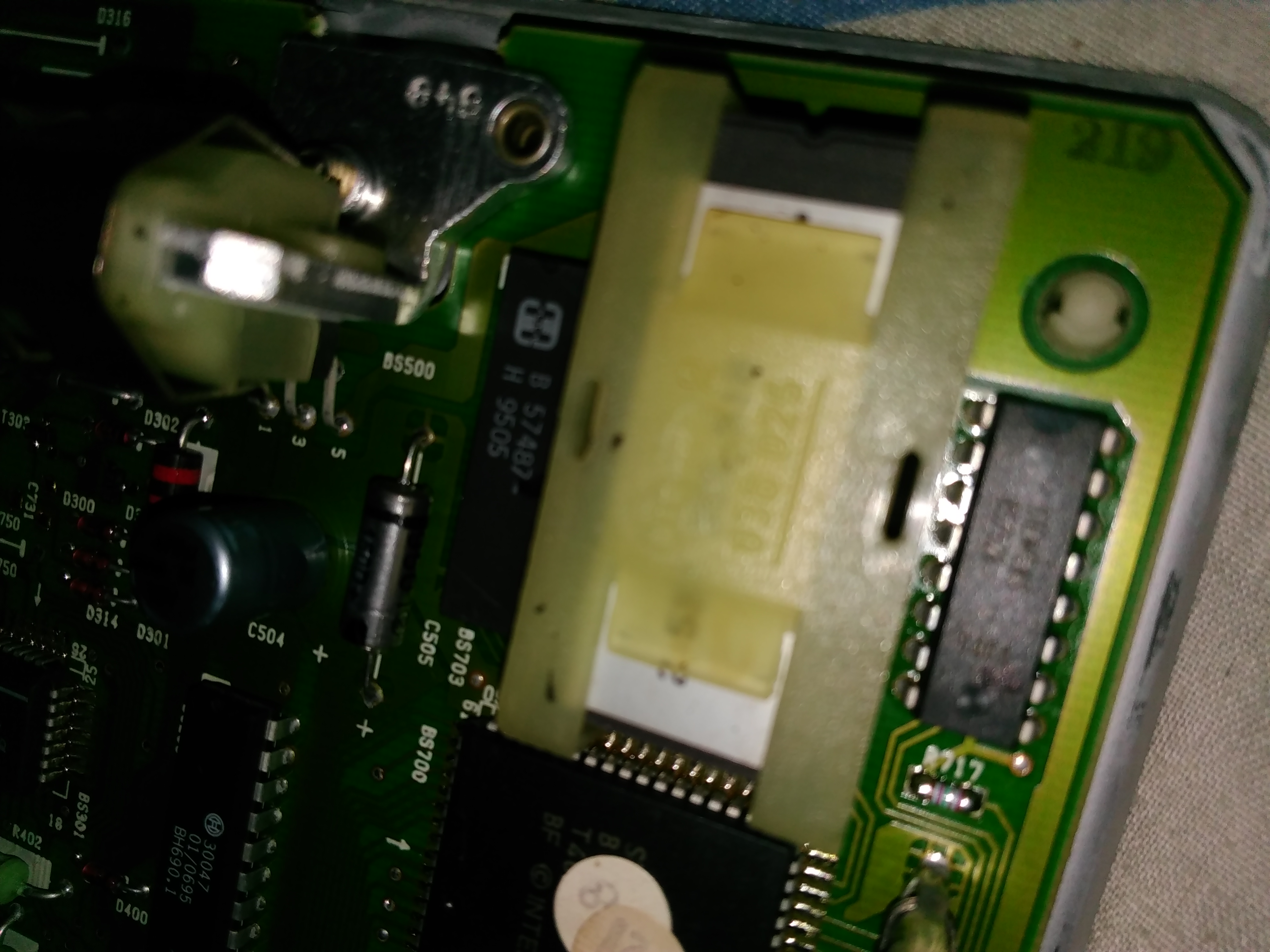

i just take it out to look for any faults.. since i still havent start my 940 since the day i got it... as
iv been told by the previous owner the stock engine+trans all harnes & ecus has been replaced with B230FT from1995 940 halfcut ... i think from Japan ...
im surprised to see the eprom chip inside this ECU has been socketed is this factory standard or what?

bullet79 wrote:...start my 940 since the day i got it...
0 280-000-975 was used on later turbo engines.
Here's a FAQ: See ECU Diagnosis
So, what diagnostic trouble-shooting did you do?

Post by bullet79 »
iv check almost everything for continuity.. even resolder those relay.. i think maybe the Rpm sensor.. since it got no resistance ... already bought a new one.. and it got few ohm of resistance... crossing fingers huh
