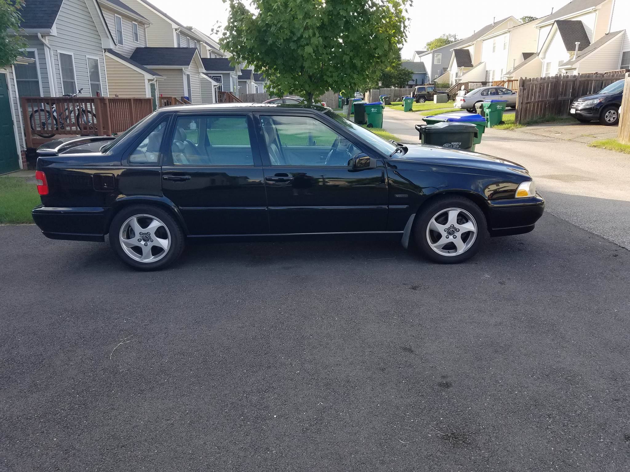

First off, YES I have researched this topic and I've heard conflicting stories on the Bilstein strut/ride height deal. I installed Bilstein TC struts along with XC90 spring seats this weekend and am curious if this ride height is "factory". I haven't been able o find stock measurements for the S70 anywhere. I know HD's raise the front because of the increased gas/monotube pressure but I don't see any reason why the twin tube TC should.
This is really just for curiosity's sake - I'm thoroughly happy with the TC ride quality and plan on adding IPD overload coils to bring the rear end up to where it should be. No real desire to lower the car with crappy local roads. BTDT. Car handles quite well already and this is before adding IPD sway bars.

Yes, they DO raise the ride height about 1/2" or so

Thanks, JRL. I remember seeing you post that somewhere else. Does anybody have the factory height measurements available?JRL wrote:Yes, they DO raise the ride height about 1/2" or so

The gas tube pressure can not possibly raise the ride height. OK it is possible, but then the strut would be basically incompressible. Front ride height is determined by two things: the coil springs, and where the coil springs mount on the strut. That's it. The latter is why the TC was reported to raise the ride height, because the shelf/plate of the lower spring seat was mounted about 1/2 inch higher.
Somebody already started a thread about this a couple months ago, and it includes some of the measurements you are interested in. Try a quick search. OK, here ya go https://www.matthewsvolvosite.com/forums ... hp?t=77013

For some reason the aftermarket companies got the wrong measurement of the lower spring seat of the strut. I put on my S60 some Boge struts, and again the front raised by about 1/2". Or maybe these measures came from the struts on the XC models which might sit higher. It's not very good because more weight goes on the rear shocks which are softer, thus handling is degraded at higher speeds.

It IS possible to search and miss a particular, specific, forum thread... Thanks for the link regardless.erikv11 wrote:The gas tube pressure can not possibly raise the ride height. OK it is possible, but then the strut would be basically incompressible. Front ride height is determined by two things: the coil springs, and where the coil springs mount on the strut. That's it. The latter is why the TC was reported to raise the ride height, because the shelf/plate of the lower spring seat was mounted about 1/2 inch higher.
Those struts he installed were from 2009, and I've heard that Bilstein may have made changes to the struts since then. I put the B4's side by side with the old Sachs strut and couldn't tell any difference between the two. Granted, I did not measure.
What I was interested in is a factory ride height measurement, from bottom of wheel to fender or something of the likes. I'm used to BMW Bentley manuals that have these measurements readily available, haven't been able to find that for the S70.

Another thing you will want to know just as an FYI is that the 850 spring seat is now exactly the same as the XC90 one, it has been that way for about 4 years now. Same part number, same part. Volvo figured that one out, eventually. So as long as you buy it from Volvo, you don't have to dig for the part number etc.
For ride height measurements, maybe some people with bone stock suspension rebuilds can chime in.
