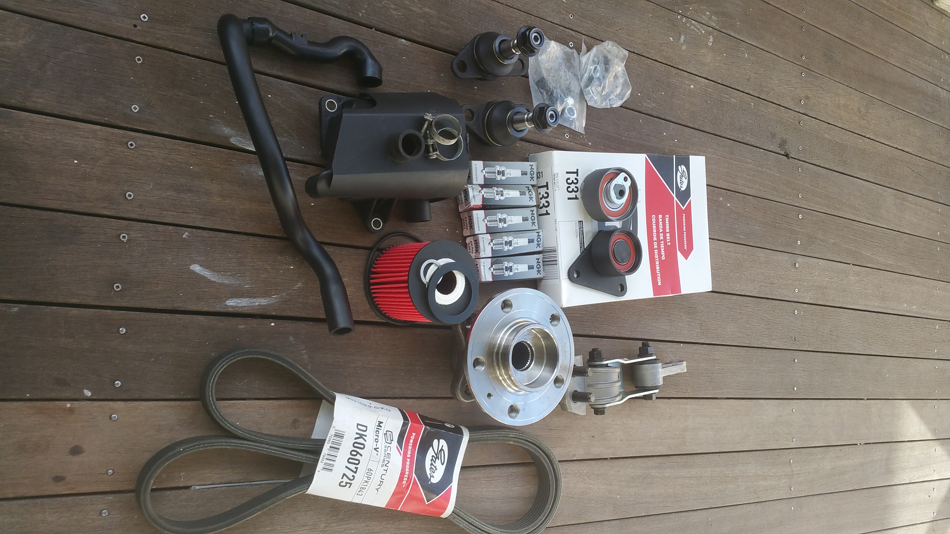

So the list of repairs is now:
2 front spring seats (already fitted)
2 sway bar links (already fitted)
Spark plugs
Front LHS wheel bearing (purchased a GMB)
Bonnet and trunk stays
Ball joints x 2
Timing belt service
Accessory belt and idler
PCV service
Oil & filter
Transmission torque mount
Engine degrease
Driver's seat repair
I'll report in with costs and some more pics as time goes by. This will replace our 2002 XC70 with trans issues.
