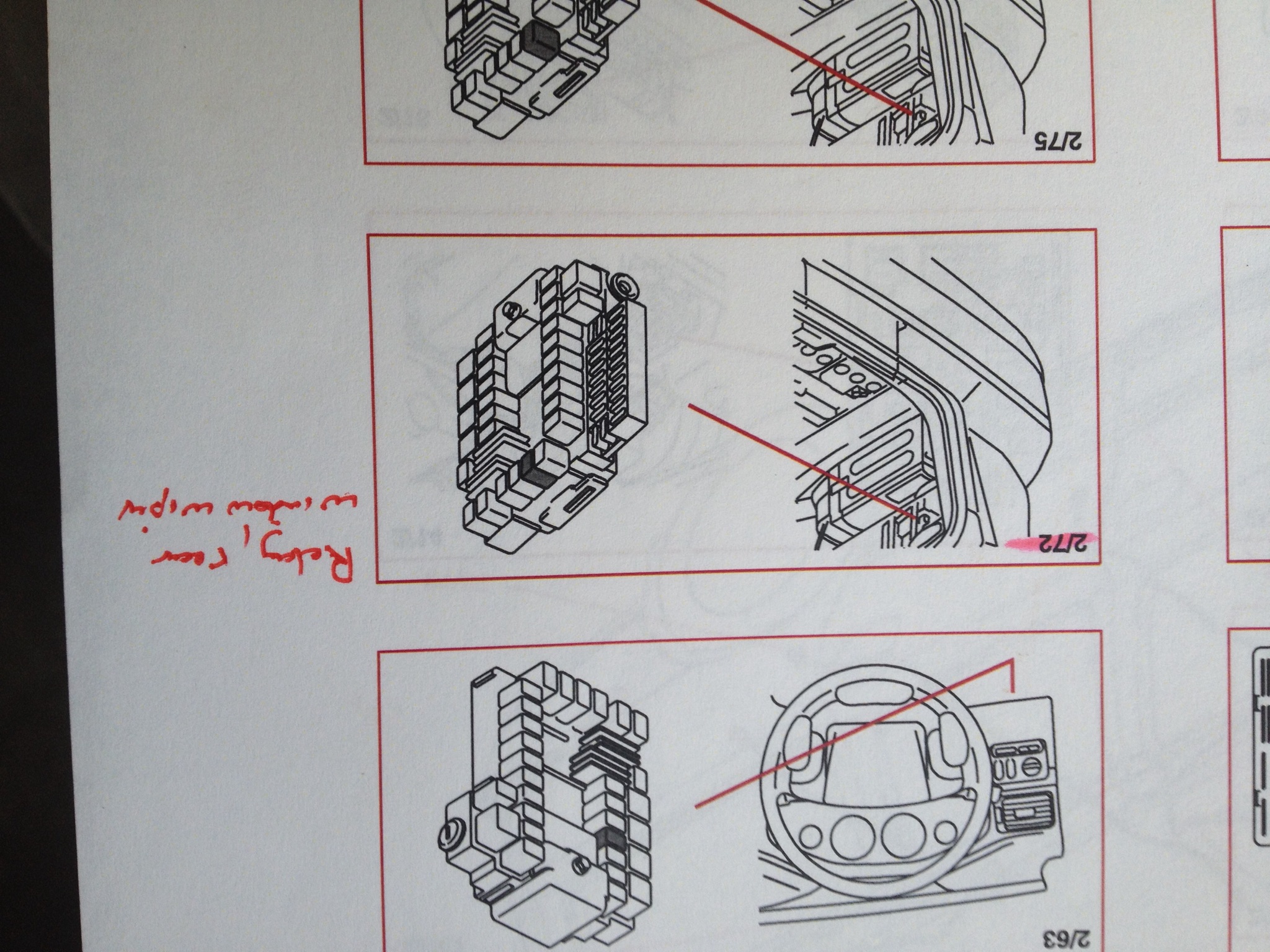

Yes there is a relay. I had this same problem on my 2001 V70 T5. If you can find the Volvo V70 electrical pdf, I can direct you to the relay. Unfortunately, I have a hardcopy but not the pdf. The relay can be found on page 138, diagram 2/72. From the top of the relay panel, it's the 2nd to the left (square box). As I recall, I had to remove the plastic molding on the side of the cargo panel to access that particular relay. The relay is similar to other relays, so you could just do a swap and see if it fixes your problem. I ended up going to the junk yard for some cheap spares, and it's functioned fine ever since I changed it out. Now that I recall, it took me forever to track the non-functioning rear wiper to the relay. Best of luck, but I'll bet that is your issue.

I will try to search it out tomorrow. I can't understand that every Volvo parts site I search comes up with no listing for a 2006 rear wiper relay! I will let you know if this works for me... and when I click on your photo to download and print... it rotates itself! More to come...

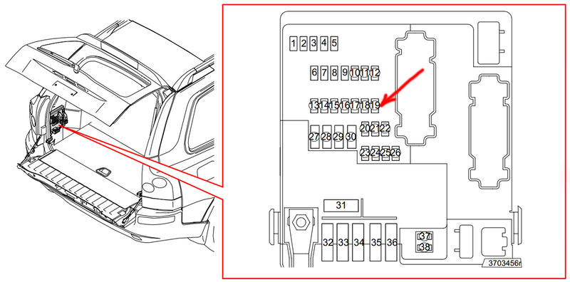

First, You need to check fuse №19 in your Rear module. If it good and there is power on it, you need to check wire between F connector and motor. (contacts 1 and 6 - white and yellow wires). If fuse, power and wire are good, you need to repair or replace your REM.

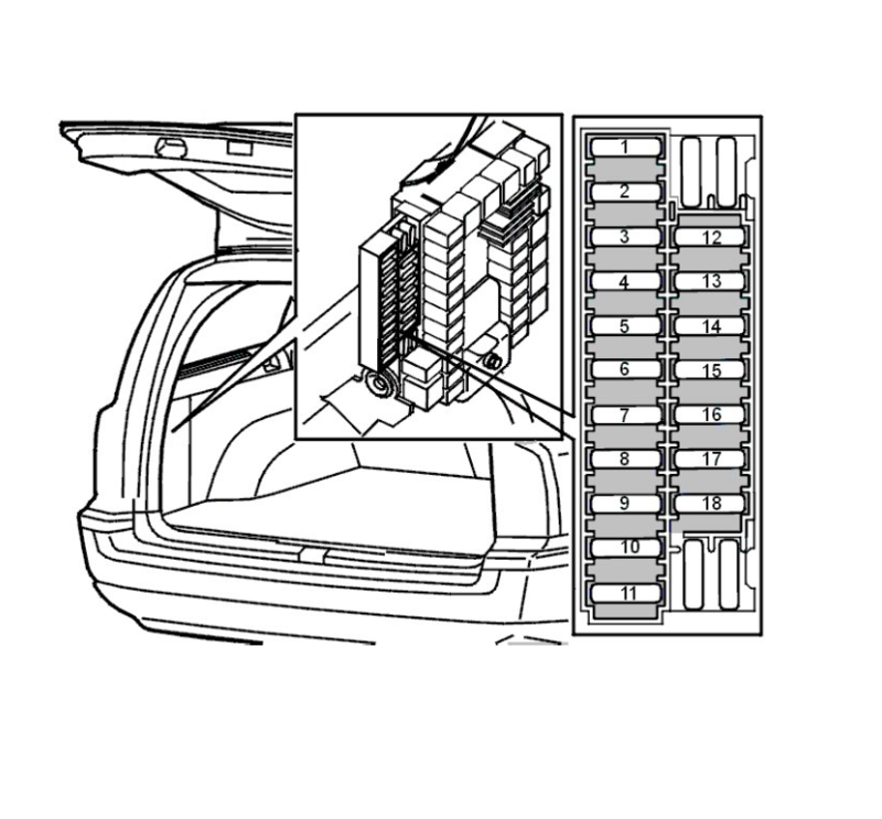

- For 2004 V70, rear wiper is Fuse #12 in the REM. There is 12V feed on the "fore" side (the side toward
the front of the car), Fuse #12 is 15A and is still good (checked with Ohmmeter for continuity).
- The REAR wiper relay for 2004 V70: does anyone know where it is located?
