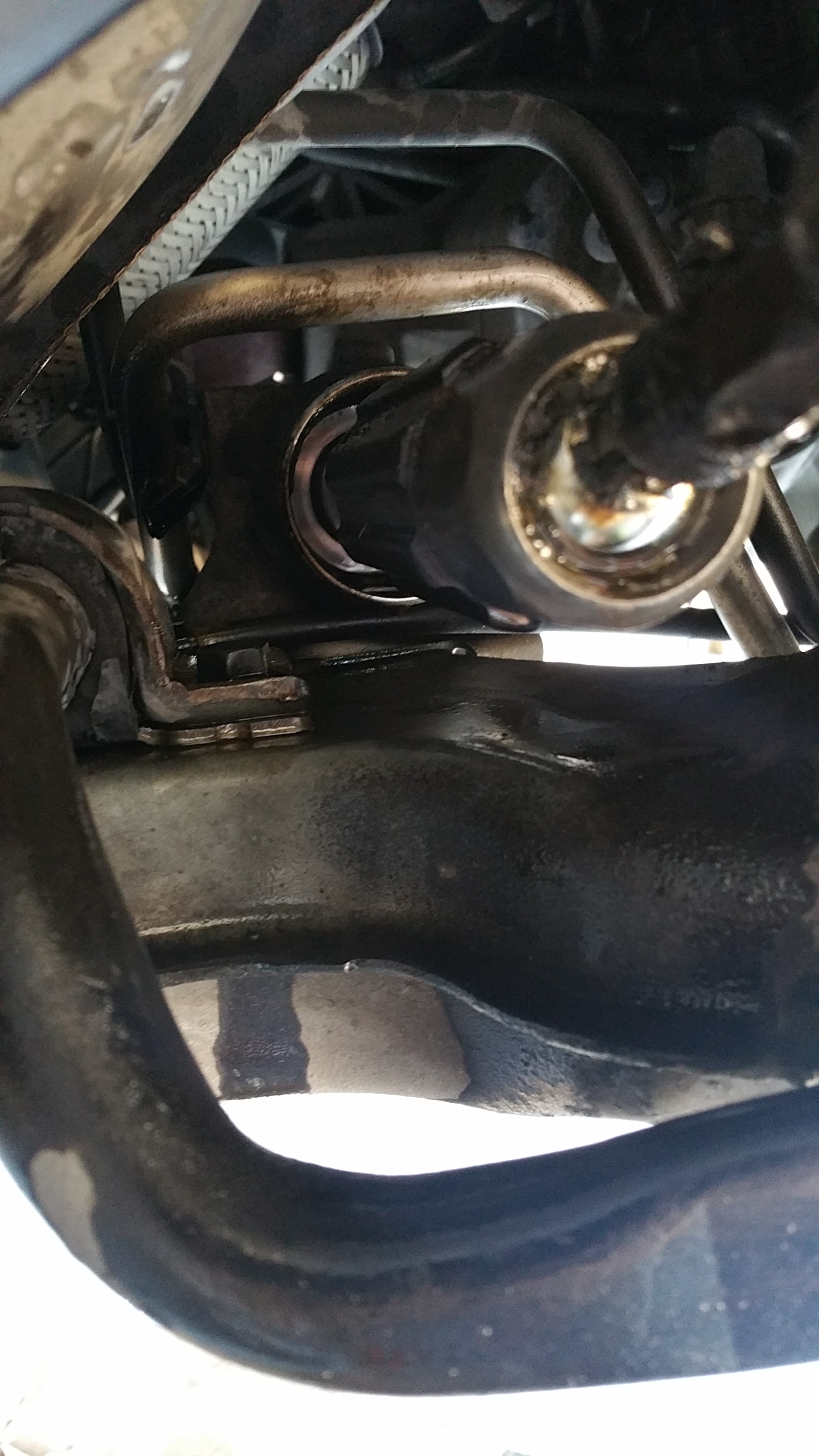

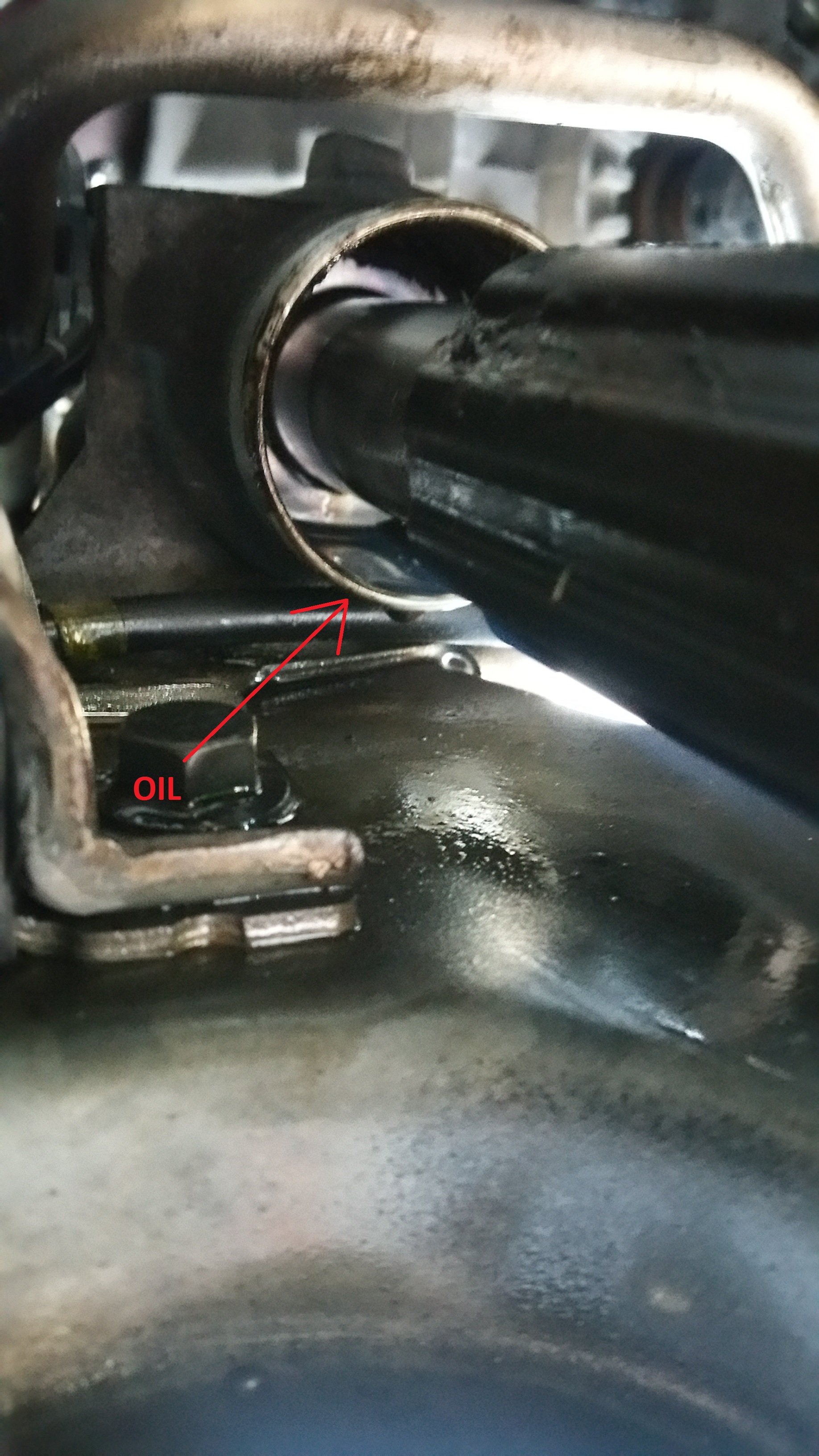

Hello everyone,
I was working on my car yesterday and trying to replace the inner and outer tie rides. Removed the outer ones and then the booths on each side. As soon as I removed the passenger side boot, oil came out probably about 4oz or something. I didn't notice any leaks before and the outside of the boot was dry. The boot was in good shape, no tears or crack in other words good enough to keep the oil inside. I bought this car a month ago and have never driven it yet, in the process of replacing the subframe, radiator, intercoolers and condenser. Do you guys think that I may have damaged the rack while changing the outer tie rods or this has been a leak for a while. The car was hit a curbe something and damaged the subframe, thinking that that may also caused the leak. In this case do I really need to replace the rack now? If so what would you recommend? The OEM rack is around 1400 bucks which I can't affor. I am in need of your advice. Thanks in advance.

Apparently rack was damaged in accident you mentioned. I'd replace it with a new rack. Alternatively, bring your rack to a rebuilder, there's a chance it can be repaired (but I'd still opt for a used rack).

As above, probably the easiest but still risky option is a used one from a R, I would remove the inner dust boots as in the picture to check the rack is completely rust free
Till then, if the rack is not rusted - as it appears in the picture, I would place a magnet by a wire inside p/s reservoir to catch all metal debris, leave it there several days. And try cleaning around the rack bar near the seal with the wheels at full turn+ make sure the dust boot is very well secured by a proper clamp - for example on mine it had a tie wrap and water got inside the dust boot.
