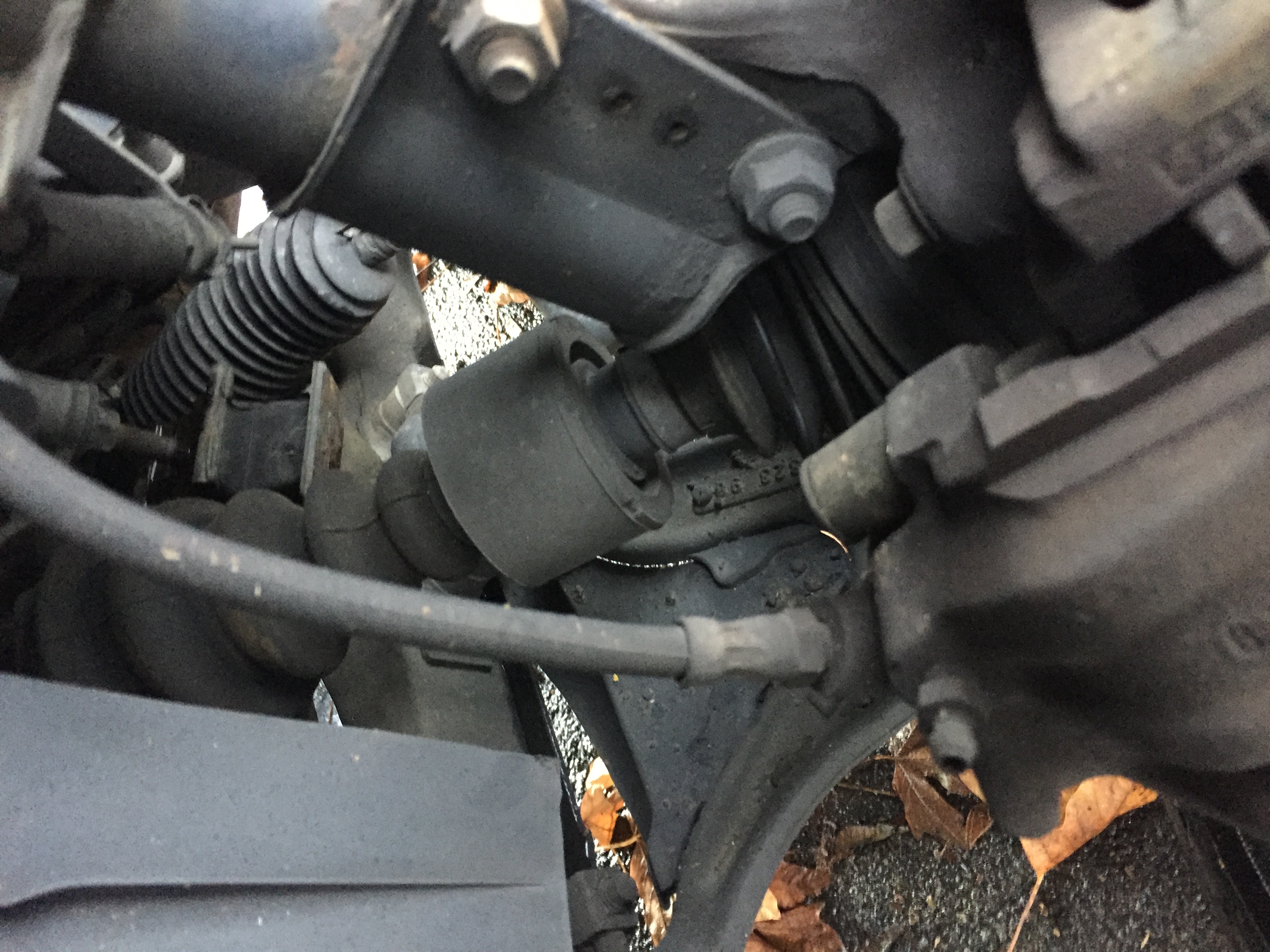

Great pictures! Thank you!
Just to be certain, one last photo request.
Snap pics of the forward facing section of the caliper; Ensuring visibility of the open pocket area of the pads clamping the rotor.

I really appreciate the input guys. I'm sure a lot of you have been there before but this has me really stressed out having a newborn and all. After getting the car into the garage and on jackstands I was able to remove all the wheels and really see what's going on. As in the video you can see the passenger front barely moving and easy to stop by hand. Looking underneath it the shaft is spinning at a fraction of the speed as the female side for lack of a better term. This has to narrow it down! Seems to be an angle gear problem but the rears are spinning fine. Is there a collar or spline I can replace or something?
